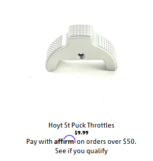

Last I heard, Hoyt is going out of business and MBoard is buying out stock. Iām looking to get a nubbed throttle replacement and seeing it on Hoytās site. Anyone know if they are still operational or should I wait until parts show up at MBoard?
Hoyt St Puck Throttles for replacement or change. OG or Nubbed.
Price: USD 9.99
Yeah, wait
Any word on when we can buy hoyt puck parts from Mboards? I need an rx
