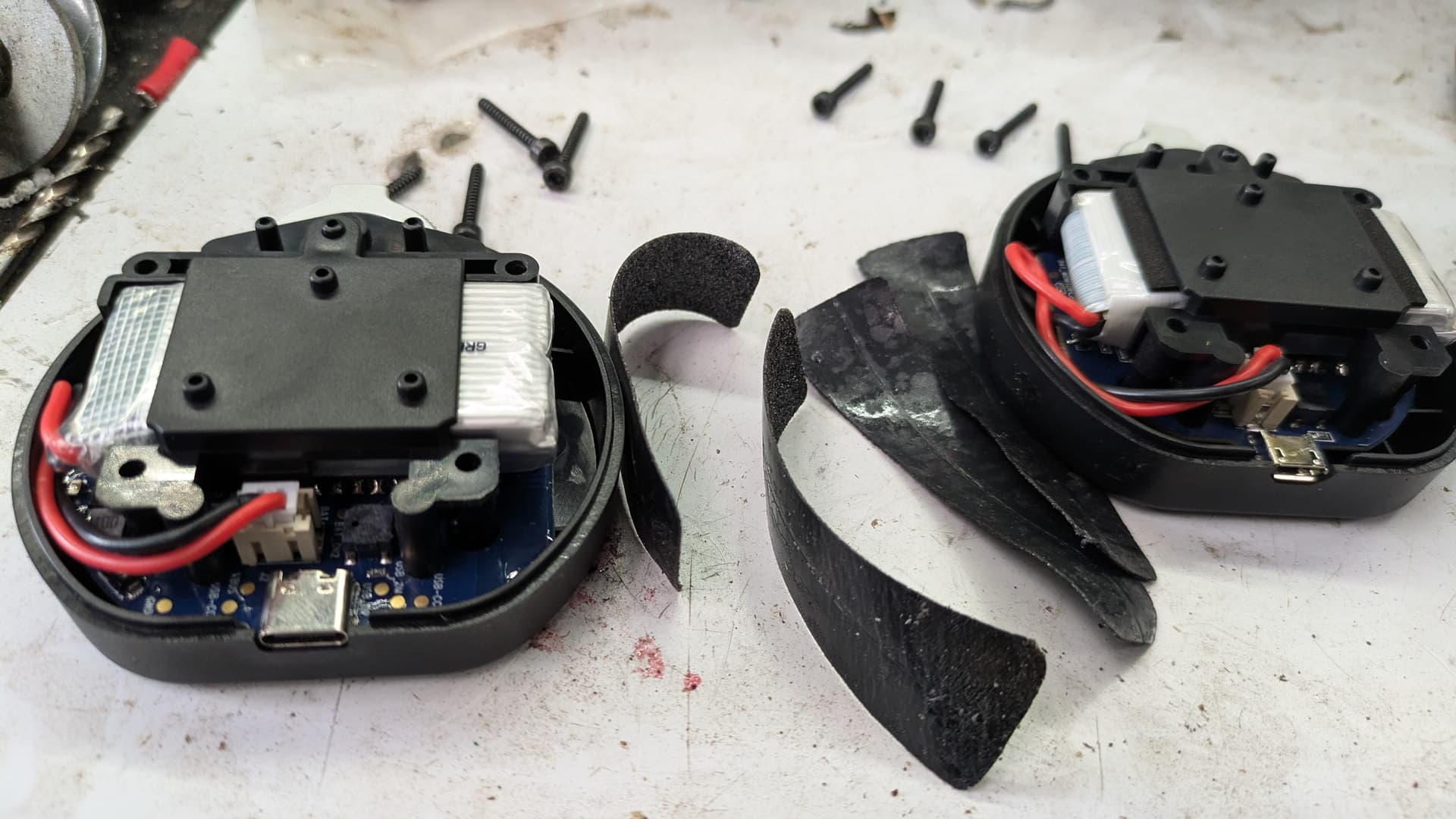

Going back to the battery. Could we just take the battery from puck 1 and put it in the puck 2? Or is it just a totally different connection or is the space on the guts totally different for it?

Yes
Connector is the same, space in the guts is the same.
If I recall correctly, the battery connector on the PCB is moved slightly. Doesn’t actually make a difference though. The battery wires are still plenty long to reach.
Looks very slightly different to me. Not sure if that’s actually significant though.
Yeah I guess so. Not sure why that would be the case though. Unless the hall sensor circuitry takes a lot more power than the potentiometer, everything else is essentially the same.
