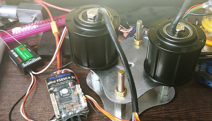

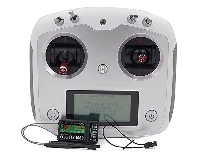

This is my existing bench setup. The transmitter and receiver is shown in the second image. I can add a custom arduino or pixhawk board in between to control the motors, but was wondering if there is a direct solution already in VESC.
This is correct. If I am able to achieve forward and backward independently, I can work on it further.

VESC no, but you might be able to configure skid steering on the TX itself. I know some of the more advanced TX have joy muxing.
Otherwise you’re looking at a microcontroller in between the receiver and the ESC to handle it.
