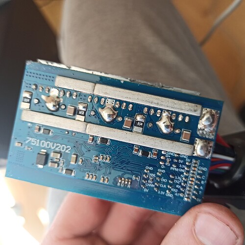

New revision out. Just received yesterday after blowing the first two I received around Xmas.
Blue vs white PCB, PS section has changed and there are three current sensing resistors stacked vs V1 using only one.
Great pictures!
Definitely don’t run the hacked firmware on that version.
When you plug it into the VESC tool, what hardware version shows up?
Do you have an ST-LINK to pull the firmware off and post it?
How have your ESCs failed?

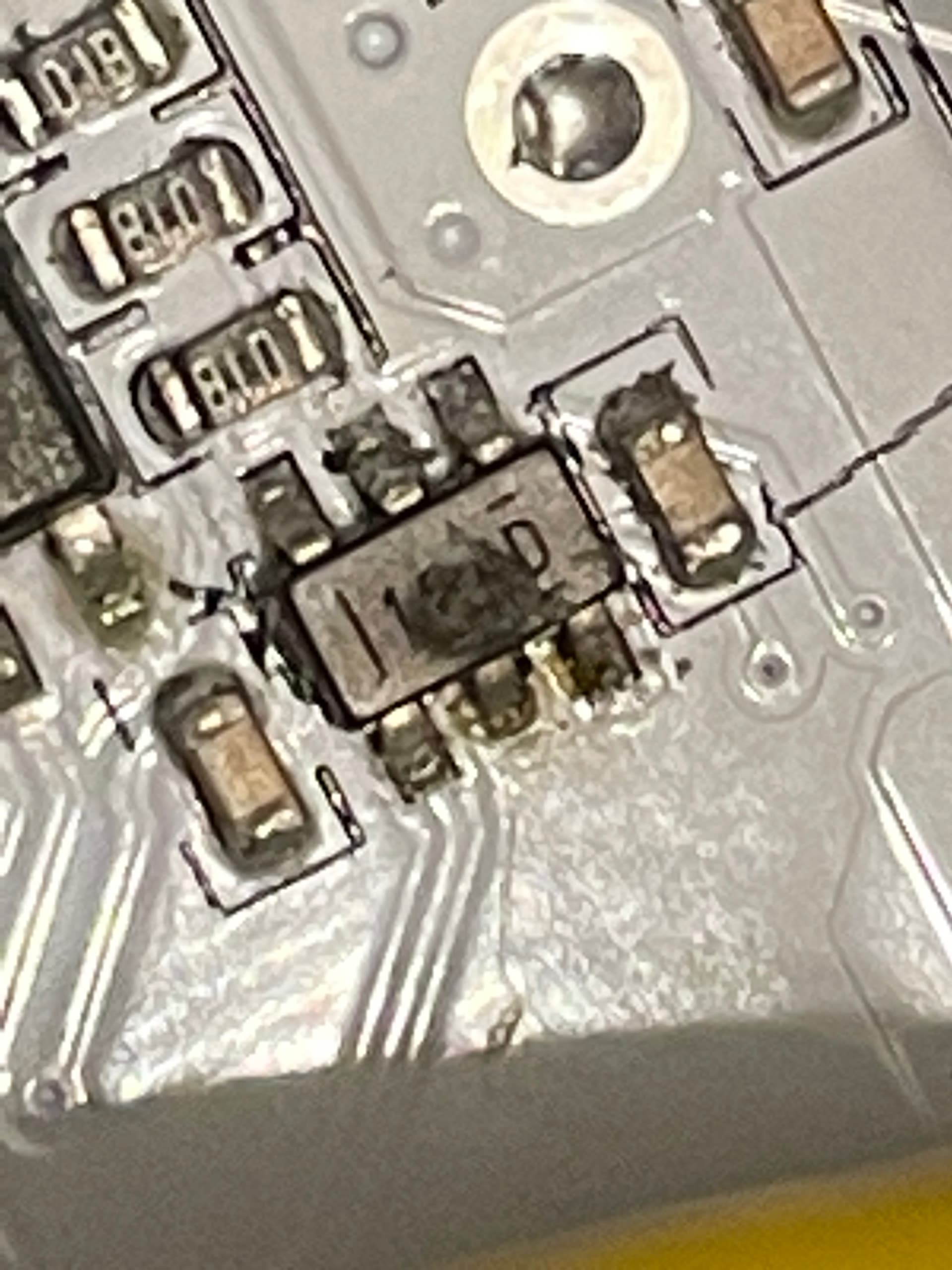

Honestly, I don’t know what caused the last two to fail. One failed with stock FW. Weird failure that occurred while connecting to battery without a resistor or anti spark to limit inrush current. I opened the case and one MOSFET shorted out, it seemed to arc between the upper back corner of the FET through the kapton tape to the AL heatsink that the FETs are bolted to. I disassembled, flattened the HS, applied new kapton tape and reassembled. No drama when I reapplied power but it was still no bueno. The ST405 seemed to overheat, shut down and repeat. Also noticed a burn on one of three small 6 pin SMD components located near the gate drivers for each phase. I have a pic of it somewhere, If I find it I’ll post it. Would be nice if replacing could fix the ESC. A little hot air and flux would be all it takes.
For the ESC running the modded FW… I have no idea. I used it in coastal NC throughout most of January and Feb while I was licking my wounds at my parents house after a super brutal midlife illness followed by an even worse divorce, lost house, involved children . My mini retirement came to an end so I moved back DC area in March. I’m in MD just of DC, it’s right on the fall line so there are a few mild hills. Towards the end of my first long distance ride the ESC failed again in a weird way. It was an aggressive ride, I pushed things pretty hard, WOT most of the ride. Some hills but not big ones. I wasn’t worried about thermal issues as it was damn cold out! Cold enough where I needed Long johns then flannel PJs then pants, hoodie with a ski jacket over it. Here’s the awesome part. Heated gloves where I tossed the proprietary 3s Milwaukee battery and used some DIY 3s 16650s that are stashed in a inner pocket of my jacket!! Lol!!! Work great, never would know either.
I think the ESC failure wasn’t really an ESC related problem if that makes sense. Let me explain. It may have been triggered by a short circuit on my DIY battery inside the scooter. I did have a pretty wild short that occurred after the failure. Long story but it culminated with me frantically ripping off the battery cover so I could cut loose rip open and toss aside half of a 4s 6p booster pack I put in series with a 10s6p pack. 12 cells of the 4s6p booster that were spewing hot electrolyte out their PTCs. The other 12 cells were close to a lot of heat but are still holding their voltage well. Probably won’t be using those cells for anything but hand warmers.
No visible signs of damage on any ESC component. I need to desolder FETs to check with multimeter if there OK.
Interesting, so that’s the current sense amplifier. I’ve killed one of these on a Trampa VESC 6 because water travelled down the motor sensor wire cable and got the chip wet with salt water. Must have shorted it out. Replaced it and the ESC works. Full part number for the 18JD on the 75100V201 is INA181A1IDBVR
I was hoping to see what the VESC tool is displaying for a hardware version (Hw: 75_300_R2 I’m guessing).
The stock 5.2 bin file that it ships with would be very helpful.

Current sense amp… hmmm… totally makes sense now given the INA prefix in the full part #. They must boost the sense resistors on the opposite side of the board then feed back to the ST405. At first I thought it was a 5V or 3.3V reg but its 6pins vs 5pins and there is one for each phase, Vreg just did not make sense. Thanks again. Will either order from Digikey or lift from a bad 75/100.
