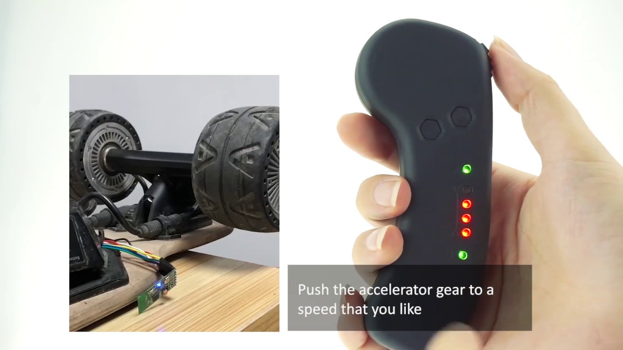

The VX1 has built-in cruise control.
To activate it you keep the throttle still and press the power button once, the remote will vibrate.
Press the power button again, or move the throttle, to de-activate.
This works when using PWM, should work the same on UART but have not tried it so not 100% sure.

Just found out that cruise control is a bitch, I can’t seem to get the right speed or the board continues to accelerate until it tops out.

yep, the vx1 (if its what you use) had a really shitty implementation of CC. It either accelerates or doesn’t hold the speed. In rare occasion it works. It also won’t hold the speed up/downhill.

Finally got to try this and it doesn’t work. Am I missing something?

Mine does not vibrate or do anything when I try this is the problem lol
I’m using PWM on mine and it works like in the video :man_shrugging:
Hmm weird. My vx1 is from LaCroix. Maybe they disabled this?
