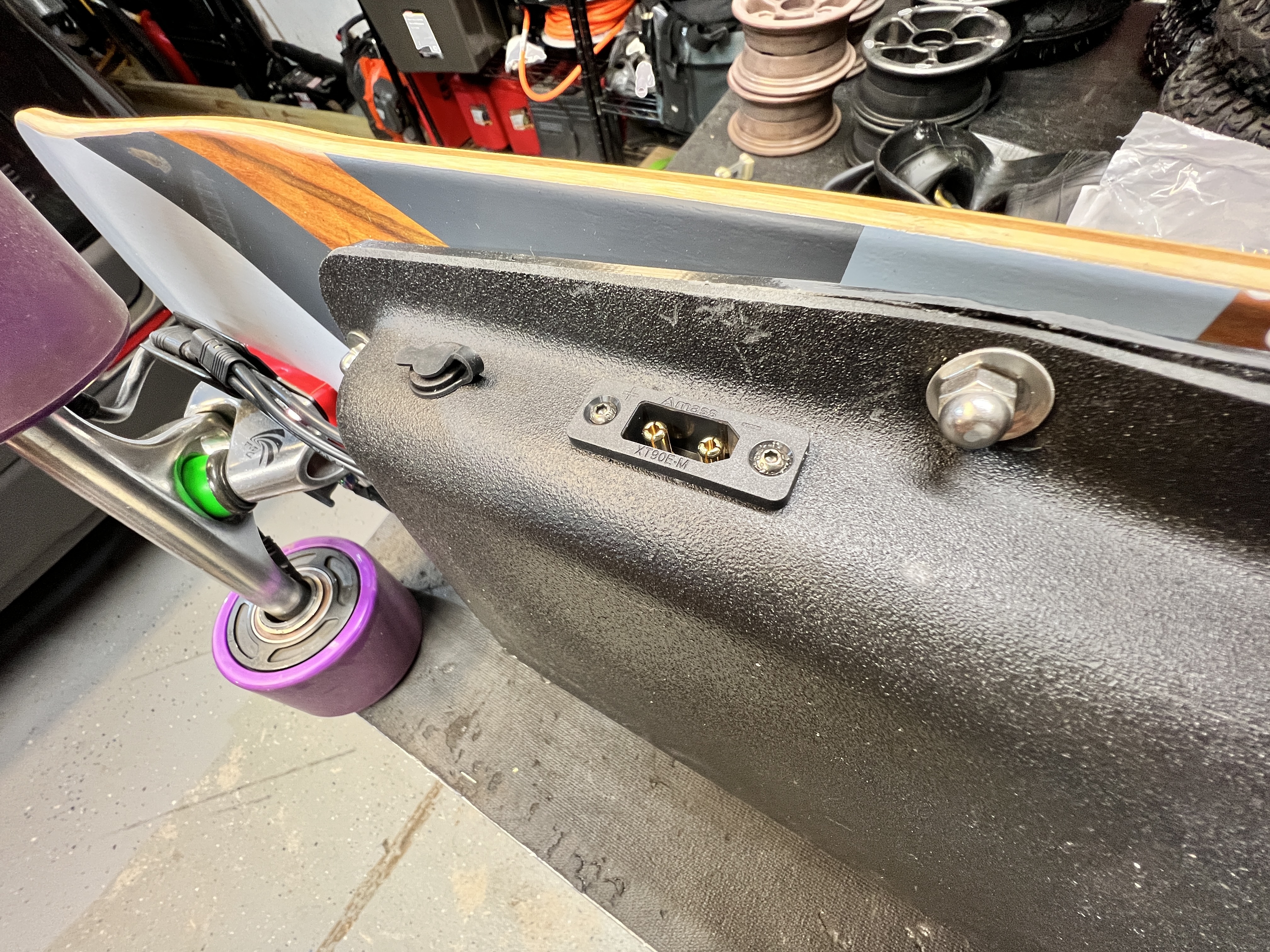

I don’t have a 3d printer to be able to design and print a mold so I have to build up the epoxy over multiple pours. The first pour is already on in the photo but it is hard to see with it being almost crystal clear. Couldn’t get the damn air bubbles out from the area between the pins and the plastic without risking burning the plastic with my torch.
I am not adding any sort of loop on purpose, but will be adding enough of a little grip area to be able to pull it out. As is I can pull it out but with no good grip yet it is hard. The magnet is hopefully my small form solution to making it harder to loose when unplugged and not for attaching a loop if that makes things clearer. If I did want a loop then I just need to drill a hole in the epoxy that will extend past all the metal though, so, no, the magnet won’t be in the way.
Also I 100% fucked up the polarity on the magnets and now need to redo the magnet inside the remote case. I knew it could be an issue and yet did nothing to prevent it :person_facepalming:
It is called planning ahead. I know there is a good chance I’ll end up loosing the loopkey when out and in a store, so I’m designing it to prevent that by adding magnets to things I already have to carry with me. The remote, probably will add one to the inside of the enclosure somewhere, and I’ll add one to my key ring. Giving me at least 3 easy places to quickly attach it to for safe keeping. If it takes to long to secure it I know I won’t use the method most of the time hence the magnet.

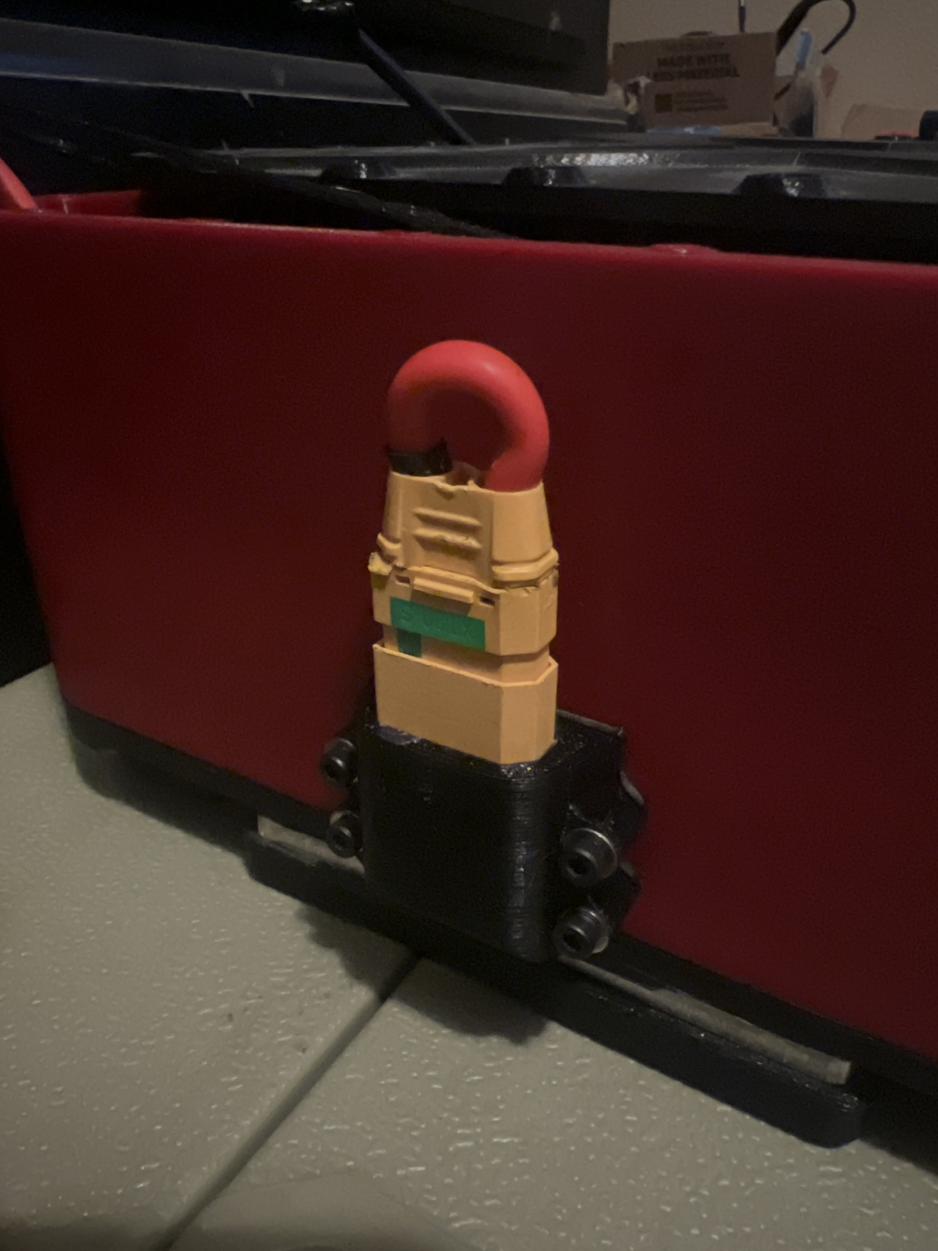

My basic loop key
Make sure that’s plugged in all the way and not just most of the way.
@b264 check this out.
I transplanted one side of an anti spark XT90. The whole thing was tricky I had to drill out room for the resistor and resolder then heat and push it back in.

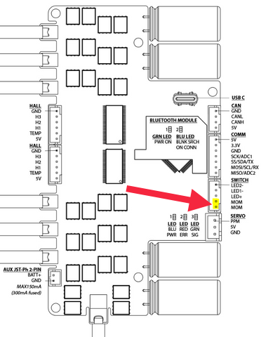

I wanna use the Unity without the switch & just use a loop key. I tried looking for the topic of it but can’t seem to find it. I know it’s like a loop key you make to short something
You need to short the 2 MOM pins of your Switch

With that the unity will turn on as soon as it gets power

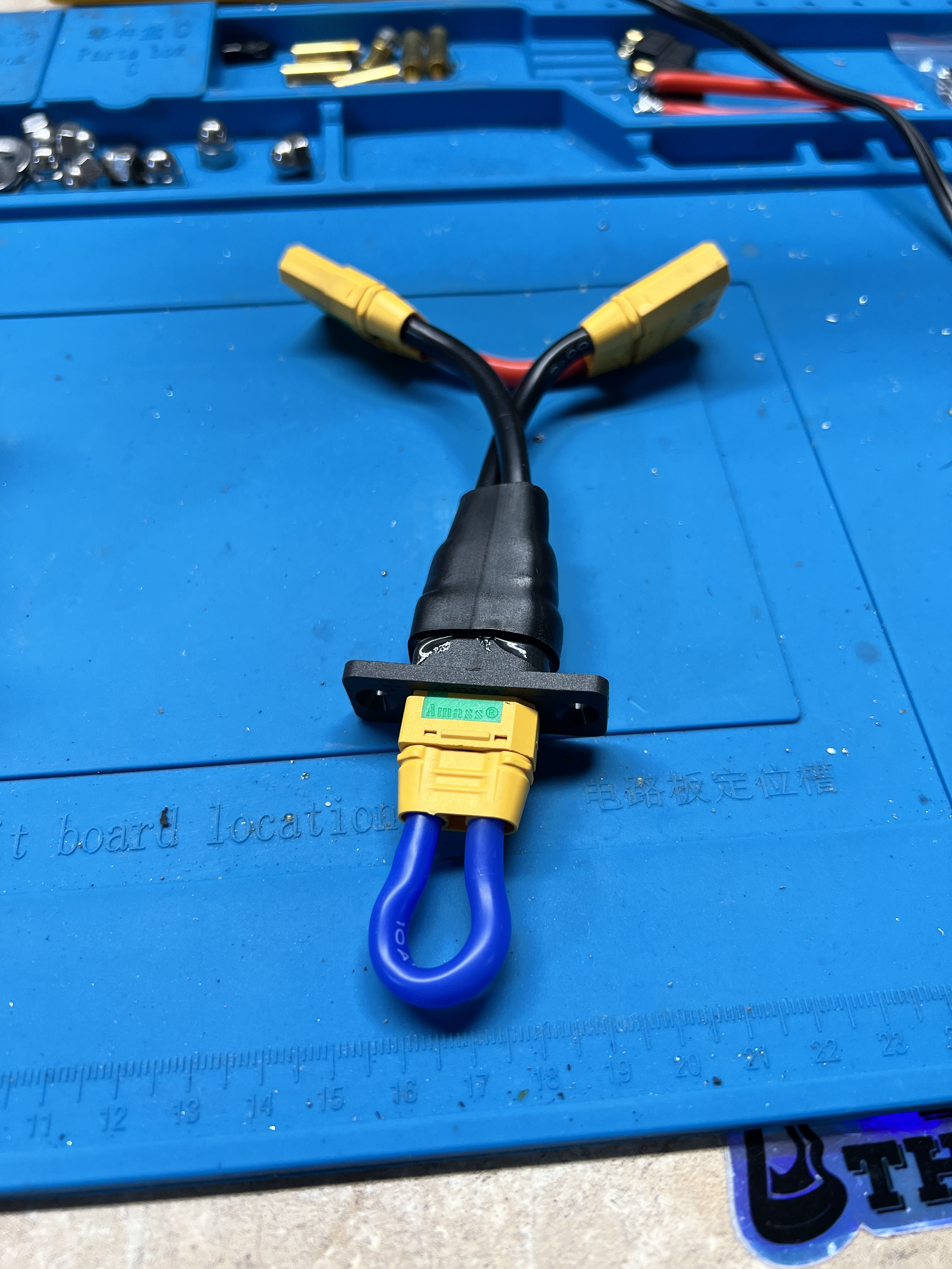

I pulled out the anti spark switch on my newest omakase build and put in a loop key instead. Small little harness and works like a charm.
Thank you :blush: & for those modify wire I leave it plugged in always on the unity correct ?
