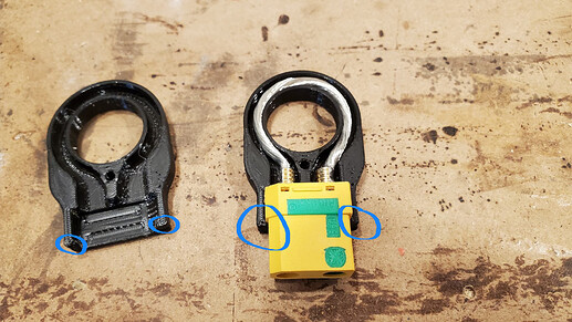

One day i will get around to designing the captured version of this. One day… once manually unplugging both my xt90s get old enough

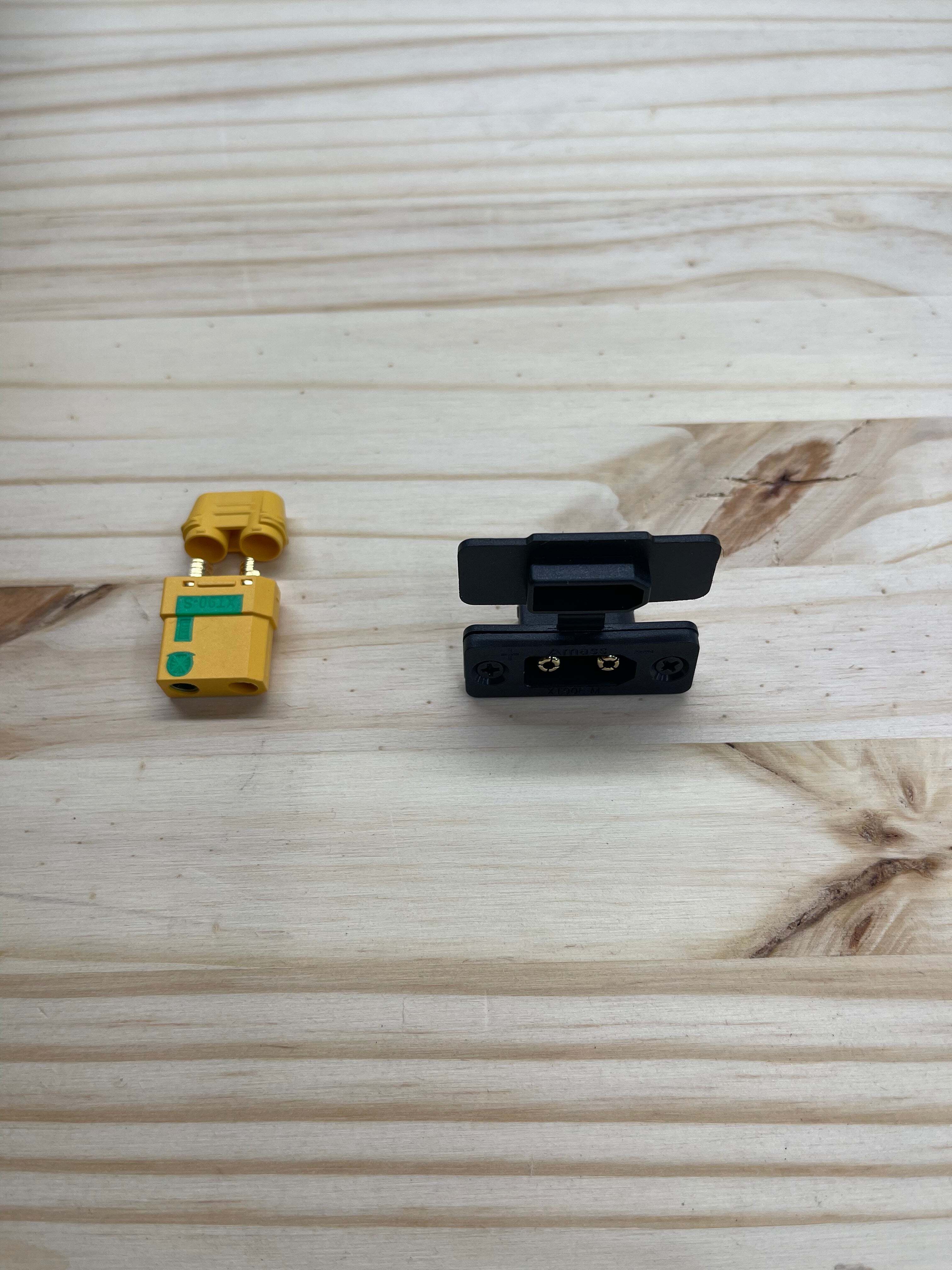

The only issue I see is the tiny lip which won’t allow it to insert fully into the male side. Any way to get rid of the lip and shorten it a tiny bit?
That’s a solid point! I’ll take a look and see.
Looks good besides that small lip problem. I’m going to need to make one for QS8
This actually might be a feature not a bug, since the XT90E-M panel mount connector that he’s using is not deep enough for the XT90S-F connector to fully insert anyway. There’s always a little gap, so this printed part might just fill that gap nicely without changing how the two pieces interact.

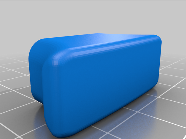

This my take on a loop key. I wanted one without a string and one which my fingers could grab a little better than the others I have tried.
Designed so the short of the two pins doesn’t extend beyond the pins.
Glue xt90 female in the the holder. If the short is level with the pins you should get a small lip before the holder begins.

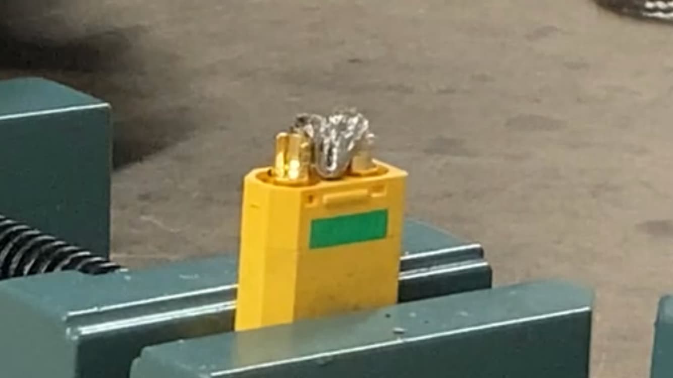

I have put a piece of braid between the two pins and filled with solder.

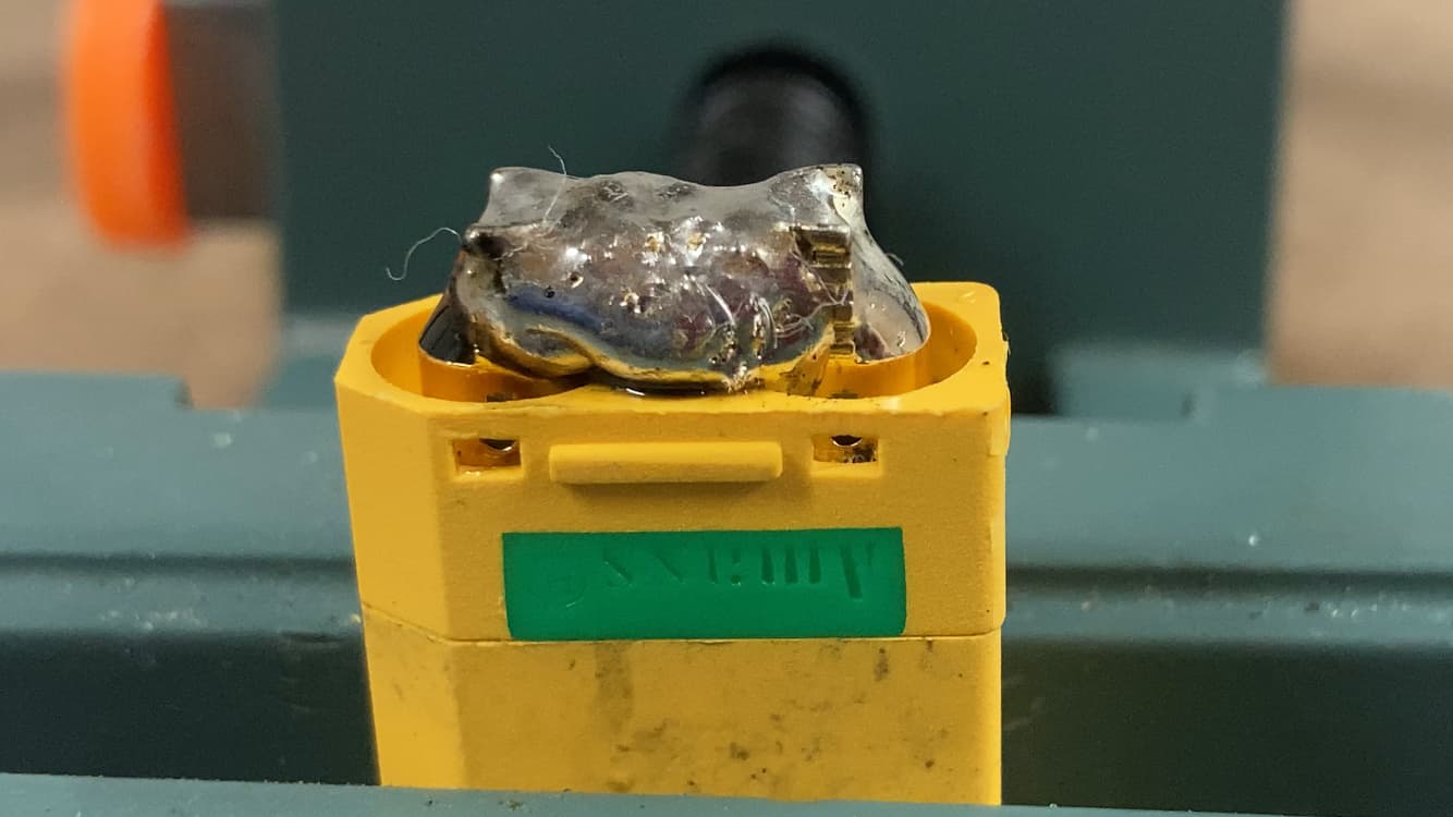

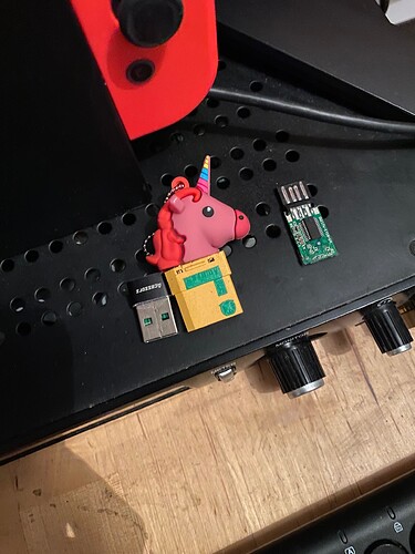

XT90 loop key made with an 80amp strip fuse and usb memory stick cover
Yes, any copper conductor that’s large enough should be fine :slight_smile:
Will the insides of one 10 awg wire be enough? I have some scrap pieces of 10 awg from phase wires removed off a VESC I bought that would work very well for it.
I may also add some more copper on top of that so I can have enough material left over if I file it down to a nicer shape. I want to try and make it as compact as possible since I’ll likely coat it in epoxy for insulation.
