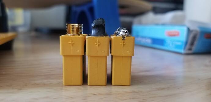

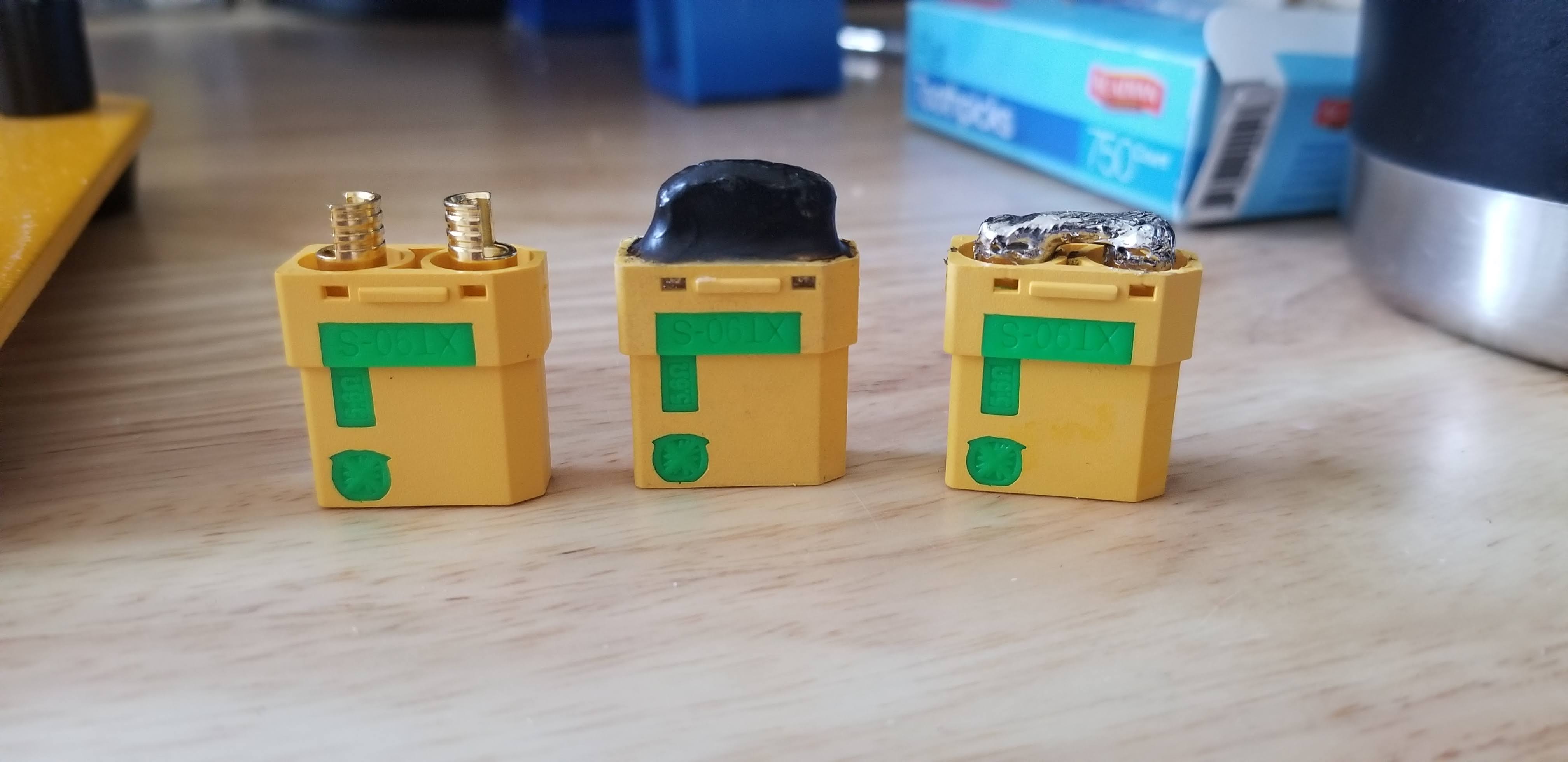

Min height loopkey:
XT-90s and normal loopkey for scale
Ground/polished by dremel

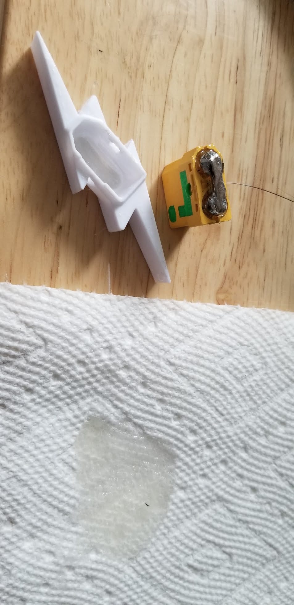

PETG cover, filled with epoxy:
Assembled. Has physical catch designed into side walls. Can’t be disassembled without damage, even before the epoxy.
Installed:
LightningLoopkey_v2.stl (1.5 MB)

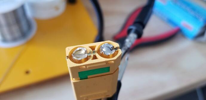

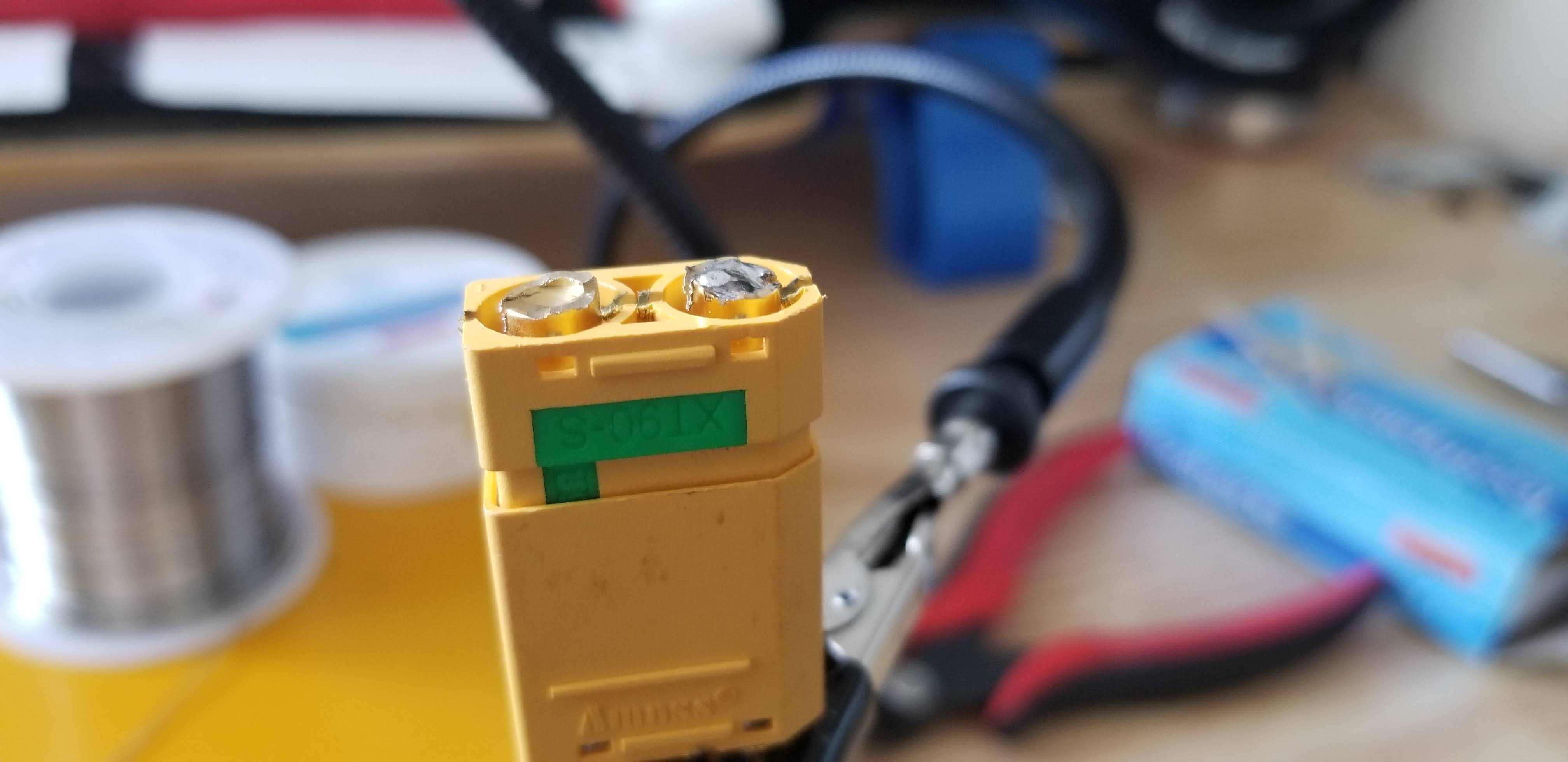

I have the female on mine so there’re no exposed pins on the board. It sits in an xt90 holder fine, tiny bit of glue to hold in place. Then if I ever need to replace it it’ll be easy enough to knock out / crack glue with pliers. But it’s still watertight. If mine breaks I can open my peli VESC enclosure and use the unity’s switch pins though.
The female connectors are not watertight. If you inspect very closely, there are little tiny holes in the metal bullet connectors that the XT90S is made from.

There are also little tiny holes in the female pins that the male pins don’t have, if you haven’t found them and filled them, then it’s not water resistant.
