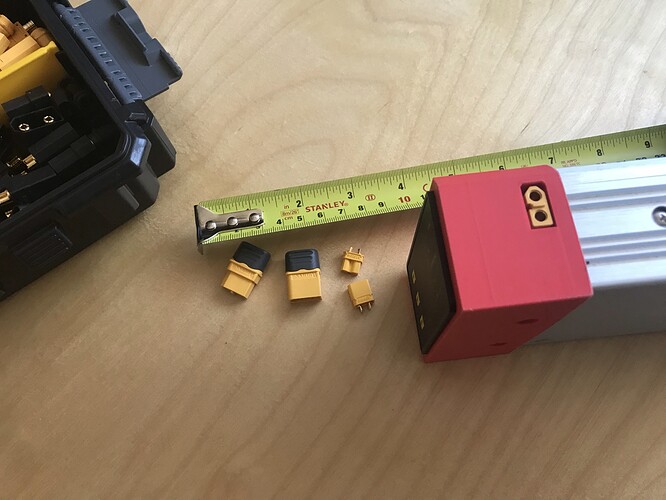

I have the female on mine so thereâre no exposed pins on the board. It sits in an xt90 holder fine, tiny bit of glue to hold in place. Then if I ever need to replace it itâll be easy enough to knock out / crack glue with pliers. But itâs still watertight. If mine breaks I can open my peli VESC enclosure and use the unityâs switch pins though.

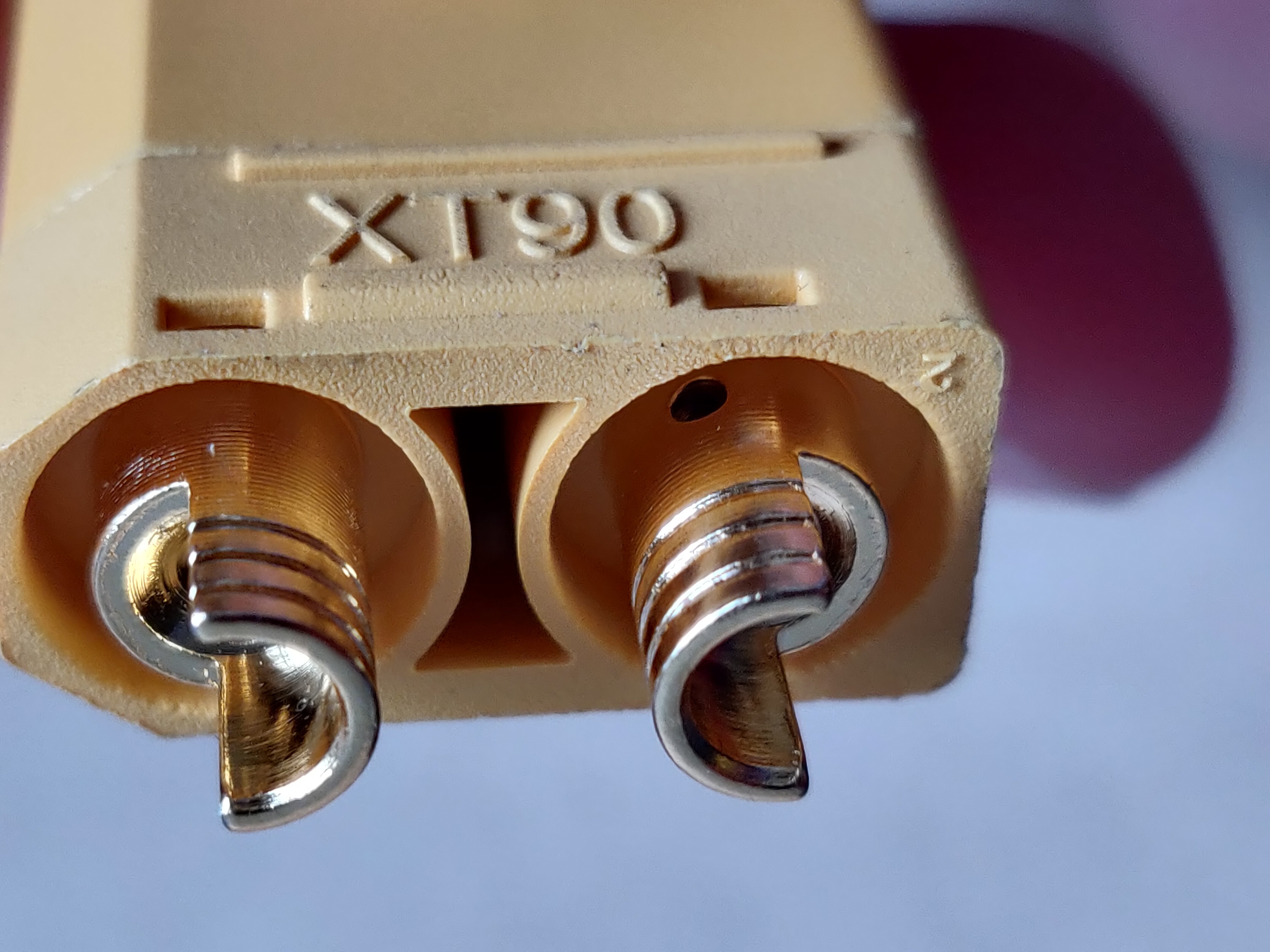

The female connectors are not watertight. If you inspect very closely, there are little tiny holes in the metal bullet connectors that the XT90S is made from.

Depends if you have a 3D printer or not I mount females on to things all the time at work with a 3D printed holder friction fit and a dab of super glue

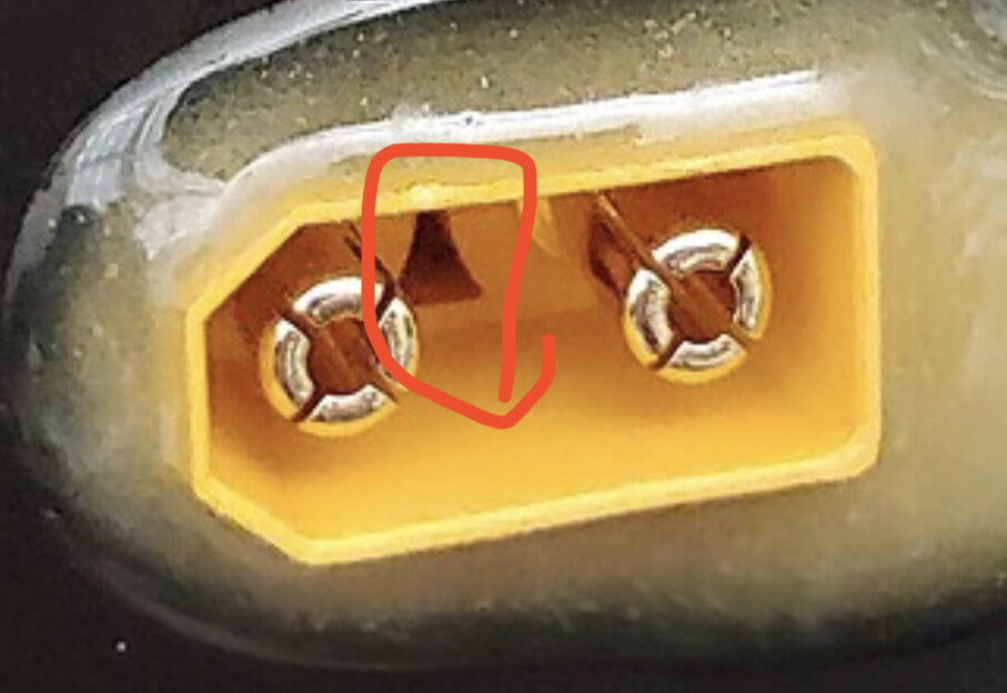

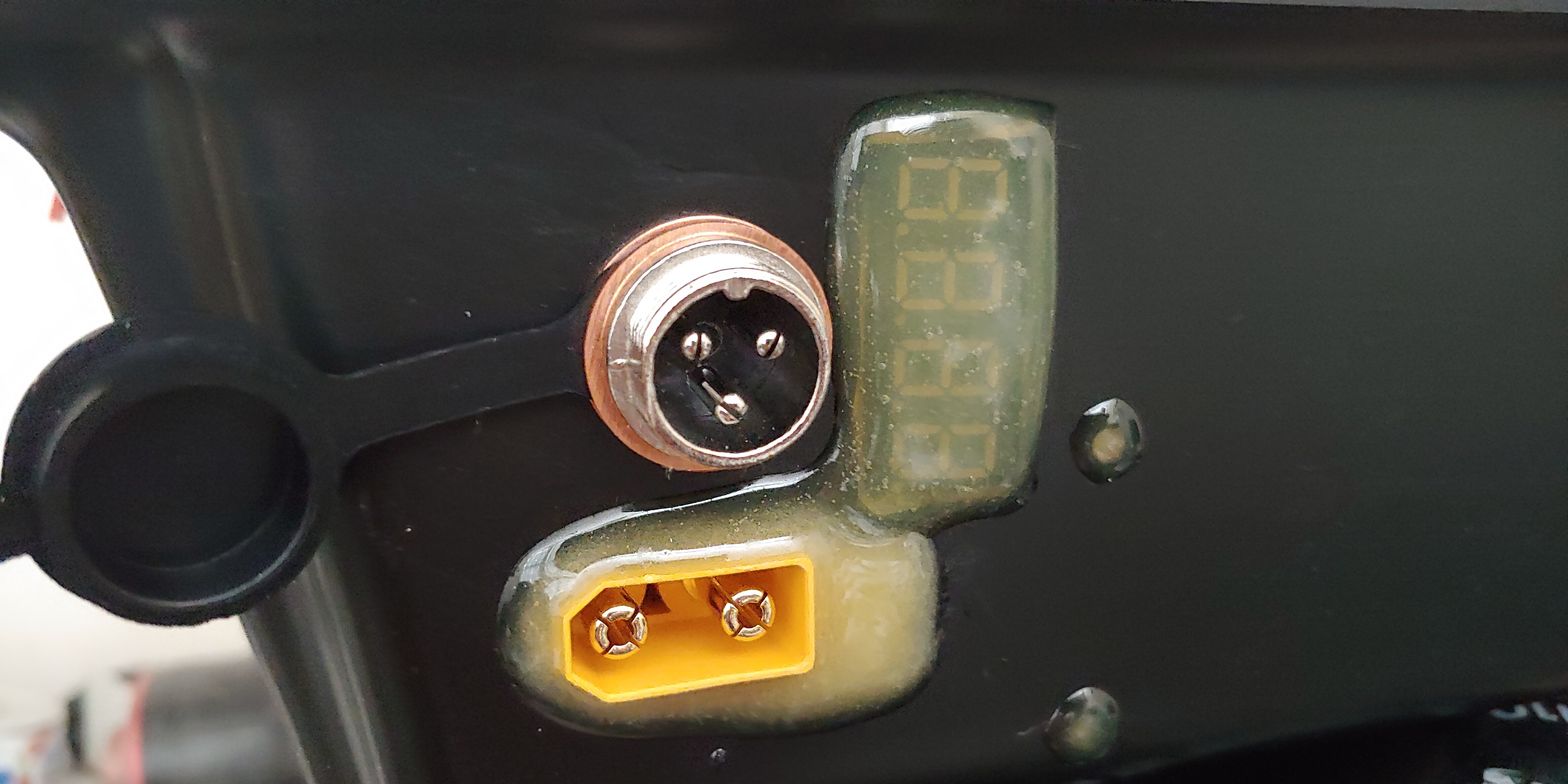

this is the one in my esk8 chargerThatâs still a lot harder to seal than this

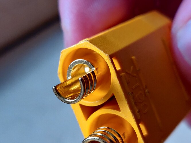

There are also little tiny holes in the female pins that the male pins donât have, if you havenât found them and filled them, then itâs not water resistant.
You posted a pic showing the hole in the male
The image was referring towards it being harder to seal a 3d printed mount conpared to the xt connector itself.
female vs male
