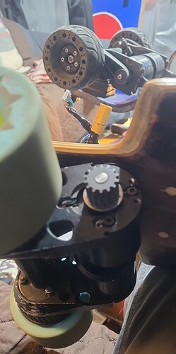

How to I get this 9pin connected up to a vesc? Hobywing motor!!!!

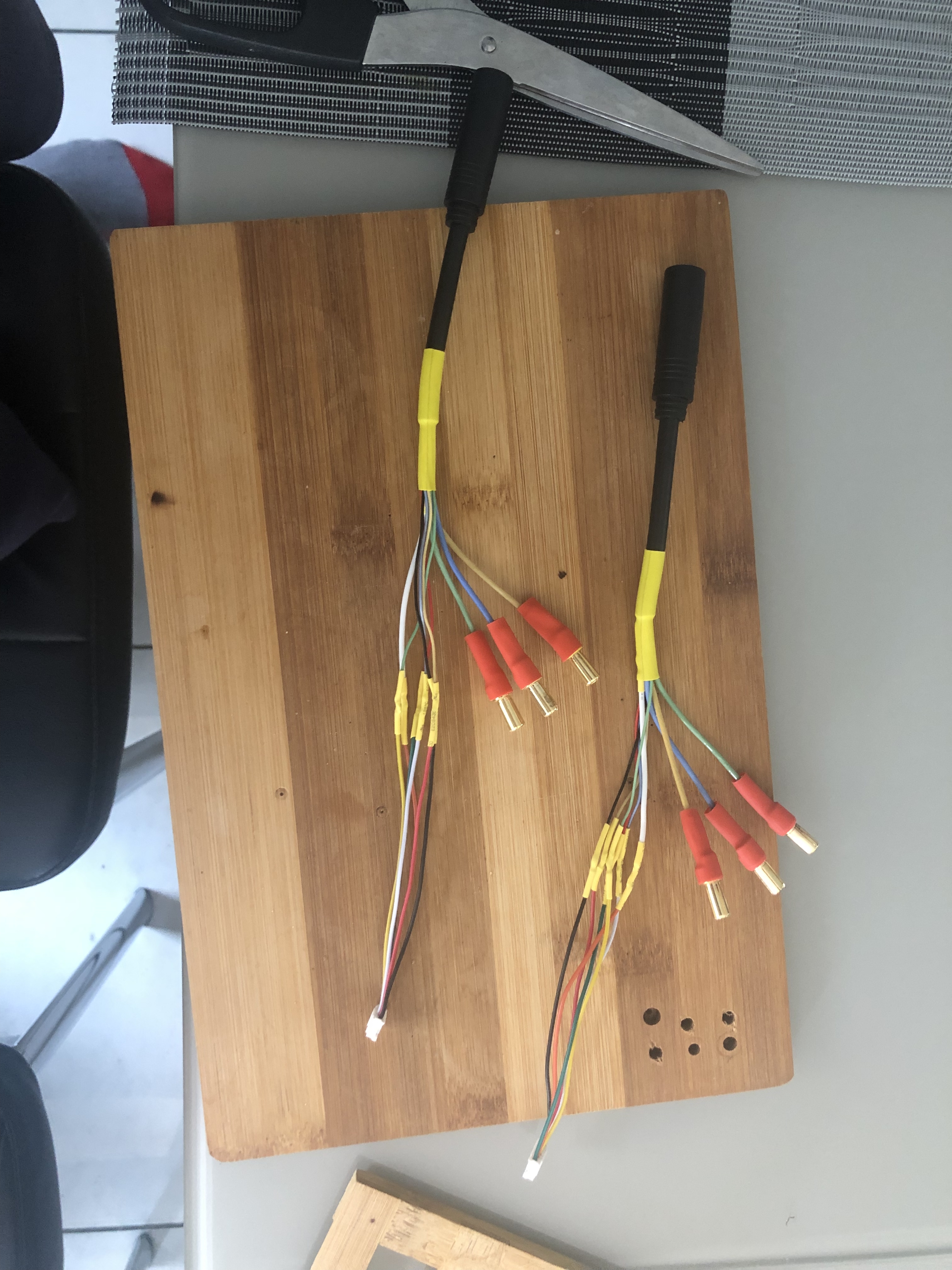

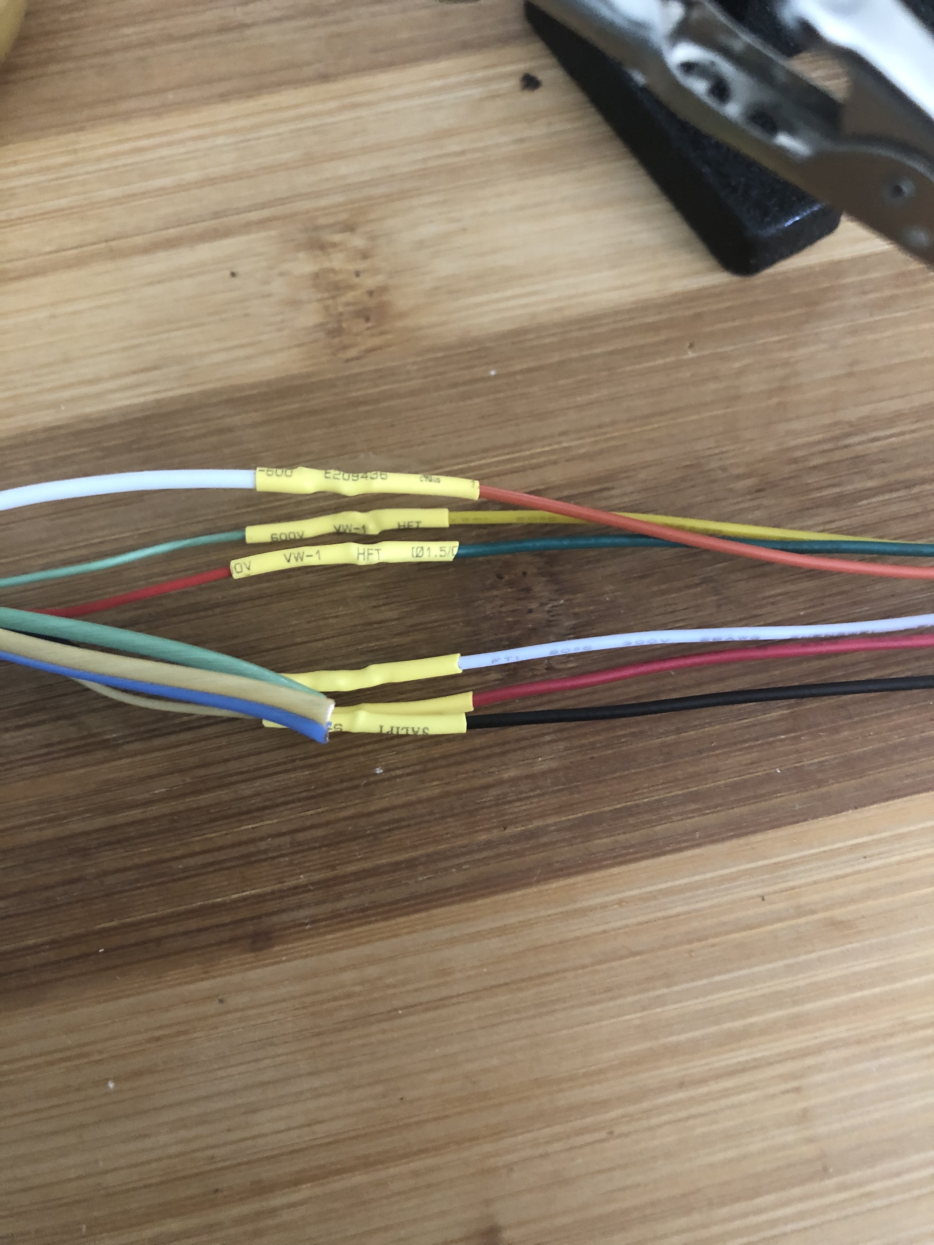

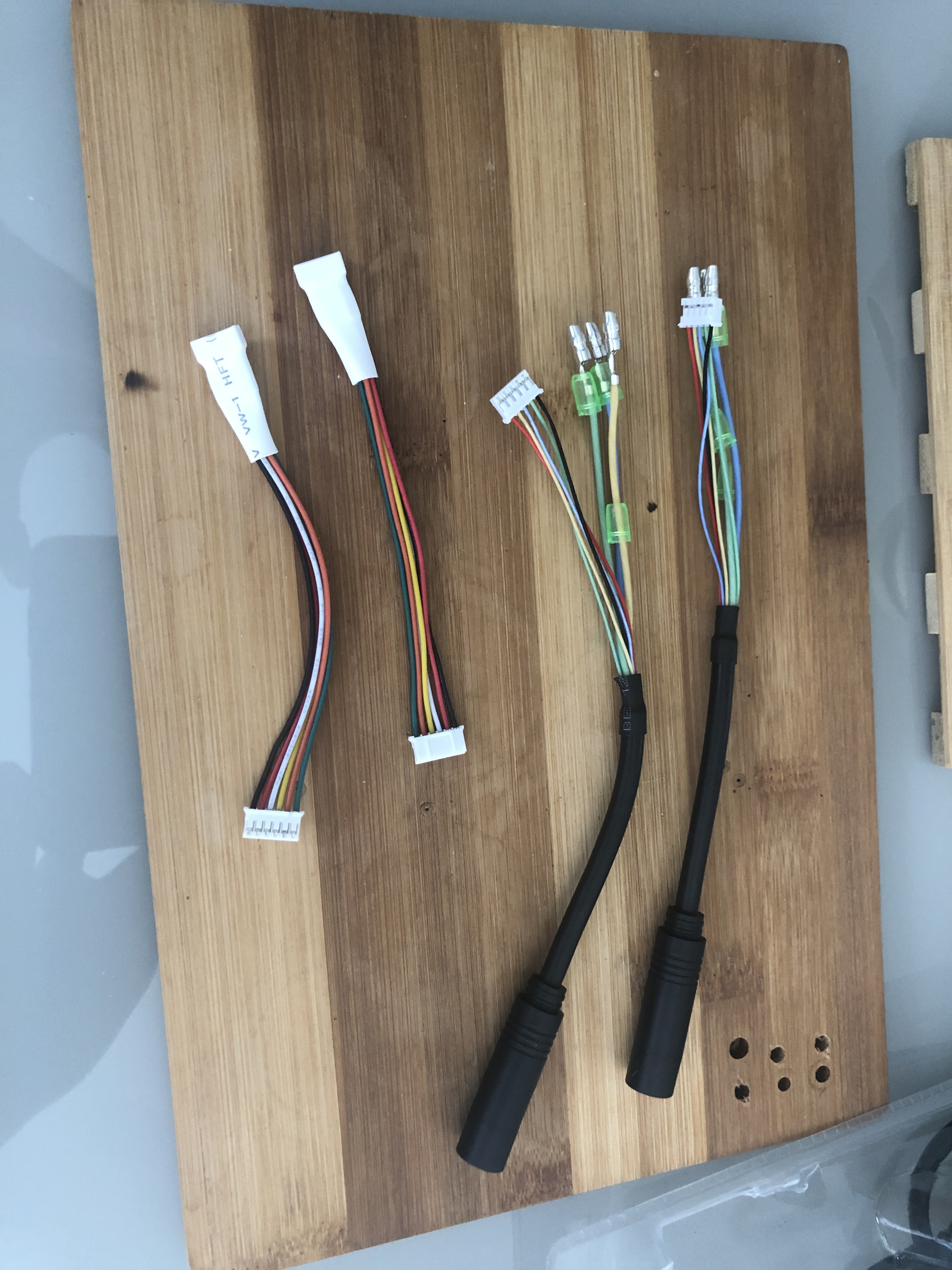

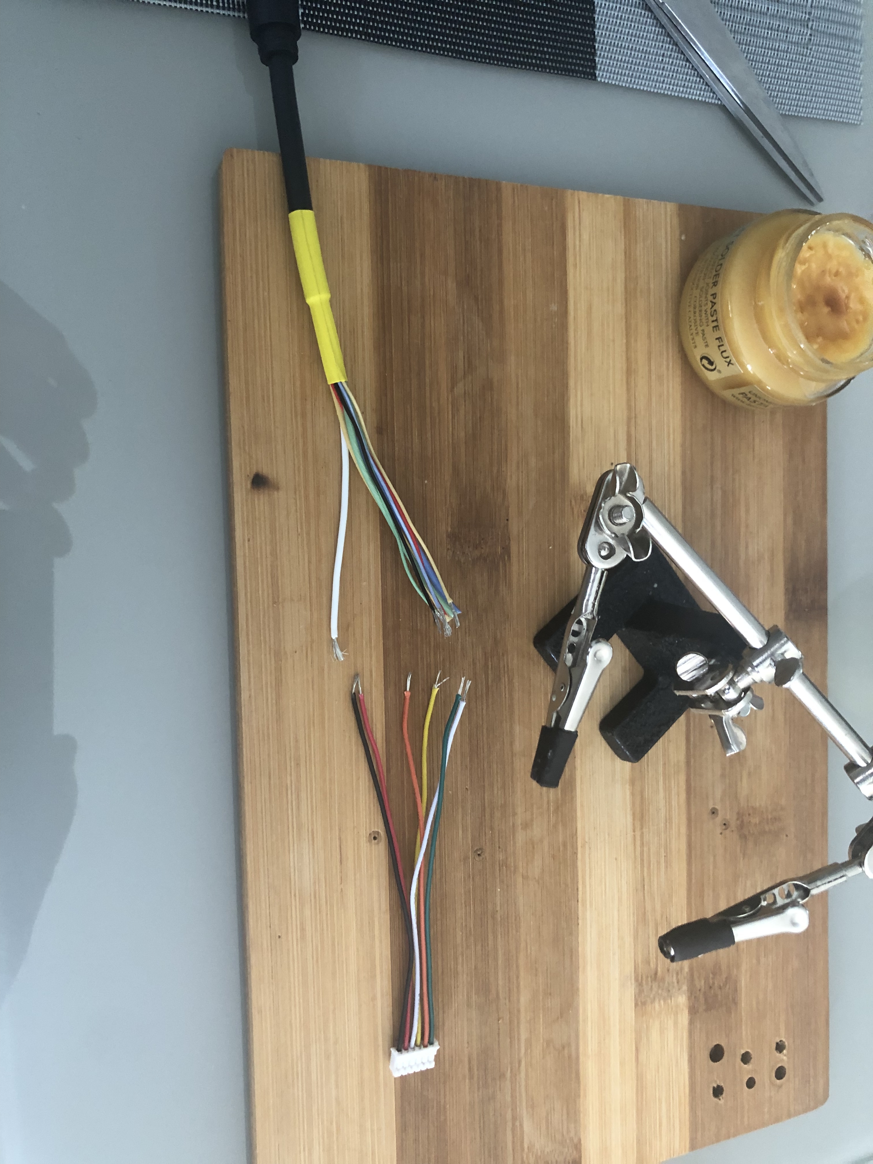

I did, salvaged the two connectors pcb on a fryed hobbywing esc
This is exactly what you need. Has the correct sensor connector to connect to a VESC, but you may want to double check that the balance wires are in the correct order.

I forget where I found wiring but I have mine swapped with mr60 and 6pin JST

Sensor wires, not balance wires. My bad. Obviously there’s no balance wires between a motor and an ESC. :roll_eyes: I would guess most other people know what I meant and that it was a typo.

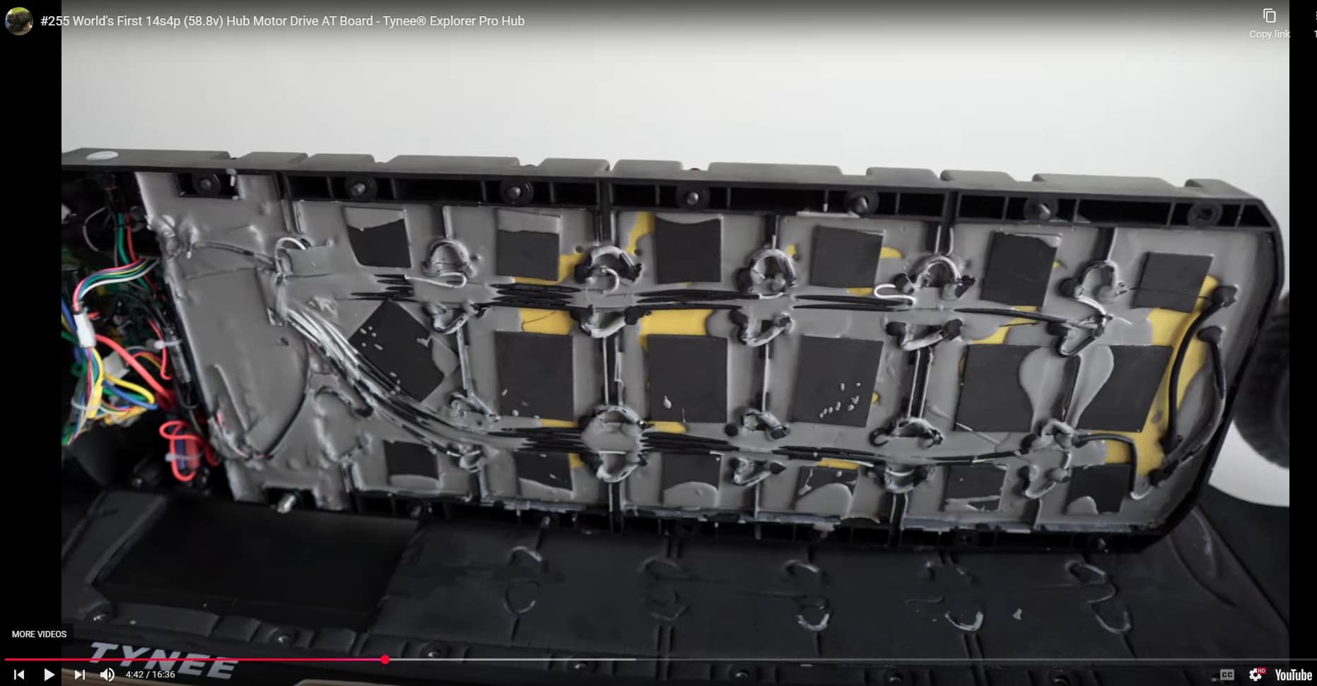

So I should have no trouble swapping the HW esc that came in my Tynee Explorer Pro gear drive for my Maker DV4s? I still have to open up the enclosure but I assume that the motors have 3 phases and sensor wires. Does anybody have experience with HW 6374 motors? I don’t care about performance that much. I just want a smooth remote control. I think the 14s4p battery has a discharge BMS. How does that effect my VESC setting? I would like to bypass the BMS and install a charge only BMS but that will prove more difficult because the whole battery is covered in some silicone or epoxy for water proofing.
