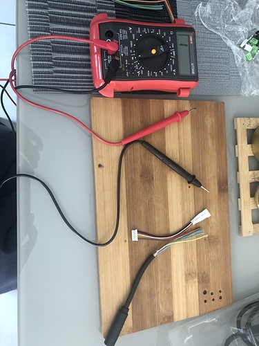

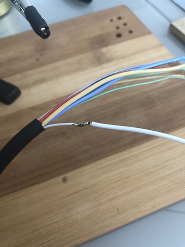

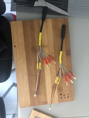

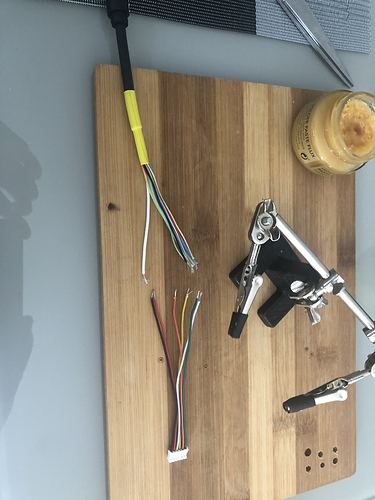

I got mine last week to use on my carvons. delivery took 3 weeks.the sensor wires are 5 pin. here is how i turned them into 6 pin
edit: just to be clear. the jst they use is 5 pin but the connector has the full six wires. its just that the temp wire has been sniped halfway and not used. you can kinda see it in the picture. this diagram helped me a ton. its how your standard 9pin ( 9 pin) ebike connector is setup.
