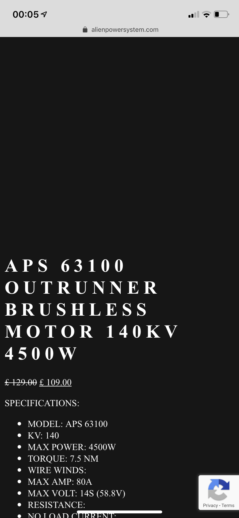

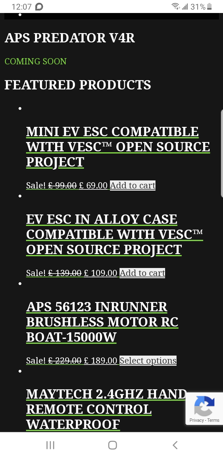

Can someone check and see if alienpowersystems website is down? It appears to be broken for me.
Thanks.
All weird no pics
Can’t click missing image
Mines even worse than that. Its just text and no formatting of any kind. But its good to know its not just my browser
