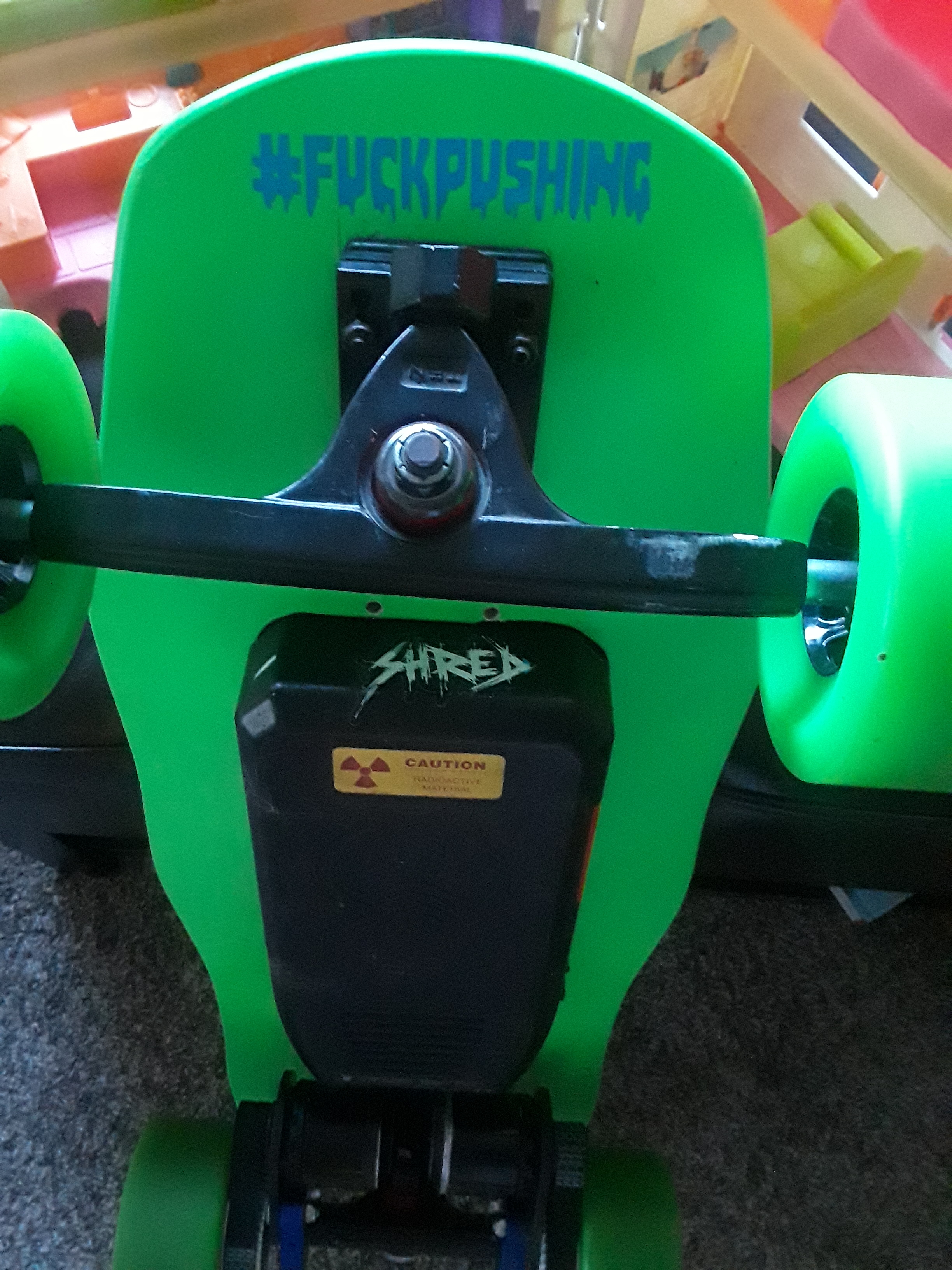

So when my trucks first broke i had parts for a full diy build.
Psychotiller mounts on surfrodz tkp trucks with bkb press fit pulleys.
The cheap 50xx motors fit great.
e9ed8e891cd4ad09f6b74d7bc9034f558e8f53c6
But that’s not a great budget option.
So let’s do something more realistic for someone who bought a budget esk8/ kit in the first place.
What i used.
Mounts- enertion mounts (i used genuine enertion mounts. But good luck finding any)
Wheel Pulleys- @dickyho https://www.ebay.com/itm/DIY-eletric-skateboard-longboard-5M-36T-40T-44T-pulley-for-for-ABEC-flywheels/302678192585?hash=item467906b1c9:m:msH0Pgt8QbCpoQg9iSArgdA
Trucks- Ecaliber from @longhairedboy
https://longhairedboy.com/collections/all/products/genuine-caliber-e-184mm-50-degree-truck-with-47mm-extended-axles
Motor Pulleys- @haggyboard.timo
Bushings - @RipTideSports & venoms via muirskate
https://www.muirskate.com/products?keywords=Bushings+
Deck- Skateshread
Wheels- clones from a dumpster
That’s about $300 new for all those parts.
I got most my stuff via trade or used tho.
Not all are necessary tho.
You can possibly re use motor pulleys. (But i wouldn’t send 2x pulleys for $20 is great)
You can definitely keep your old wheels and deck.
And ill test if i can get this all to work on
Normal caliber trucks.
That could save a bit of $$
Few modifications i needed to do.
First i had to move the front truck forward to make room for the enclosure.
Second i had to file some of the hanger for pulleys clearance. Took 5 mins by hand
The results
Gonna come back later and add links and edit possibly.
Also ill re take pictures with something other than a potato later. Wifes tablet was dead.
Thank you @b264 @Venom121212 & @dani for the parts. Couldn’t have done it without your help.

I’ve tried multiple bolt on pulleys now and i gotta say these dickyho pulleys are great. Easiest ones to get true I’ve used yet.
Needs pivot cups asap and a real caliber baseplate for up front.
I have a little something fun coming from @mikenyc i think for this too.

Took it for a ride.
No loctite lol
Just a test.
At first i laughed how slow it was. Then i realized i was in easy mode. Flipped it to full power.
Little better. Then realized battery was at 50% … ballz.
Guess tomorrow it is.
Think i want 90mm wheels tho. Or slightly smaller motor pulleys. Or both.
I’ve also got a meepo 10s2p battery.
I wanna toss it in but this board is primarily gonna be used by my lady to get to work.
And she’s gotta ride on this riverside park bike path. Lots of pedestrians and they have rules about electric stuff on the path.
Seems like as long as you keep it slow they’ll leave you alone.
So leavening the 6s3p for slightly more range in there for the moment.

Yeah so i was gonna test ride tonight.
Was putting loctite on motors pulleys this morning and broke my only 1.5 Allen wrench.
So i gotta deal with that. Probably won’t happen today. Got other things to deal with today. Oh well…:man_facepalming:
So i road around on the Skateshread deck…
Just didn’t like something about it.
Put it back on original deck.
The Skateshread deck is now on normal caliber trucks, and venom mags. Feels much better.
Also added a tail light and im playing with some adjustable baseplates from Bowerysurf.com / @mikenyc
Feel like these baseplates are worth more than the rest of the build lol
I’ll probably remove them when i have parts for a more powerful build.
This thing isn’t going over 20mph
