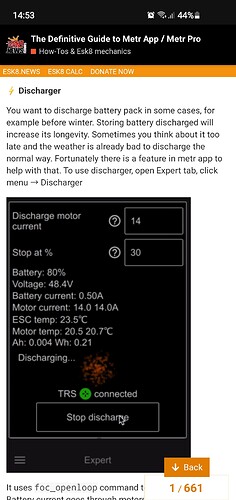

How to discharge battery
So metr pro has got this very nice discharge feature
But do You guys know any other way how to discharge battery pack simular to metr ?
