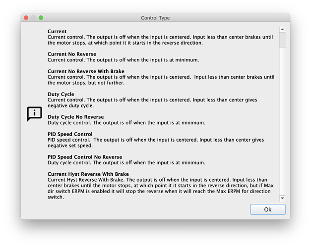

Hi!
As promised Iā€™ve updated the vesc tool, and the FW. Vedder/@trampa, seems eager to accept my PR!
Iā€™ve built a macOS binary here: https://github.com/DAddYE/vesc_tool/releases/tag/1.14-beta
However please note that I havenā€™t tested it yet since Iā€™m on UART.
Rember to update the firmware as well, so it can understand the new control type.
Here some screens:
If you test it, please let me know how it works.
Thanks!
Edit: yeah, Iā€™ve to fix the description, and Iā€™m looking for a better name :smiley:
That was very cool of you and I want you to know that I personally appreciate you putting in the time to do this.
I will test it this weekend and let you now the result.
