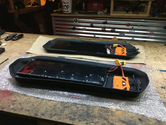

How rattle free is your board and how you achieved that?

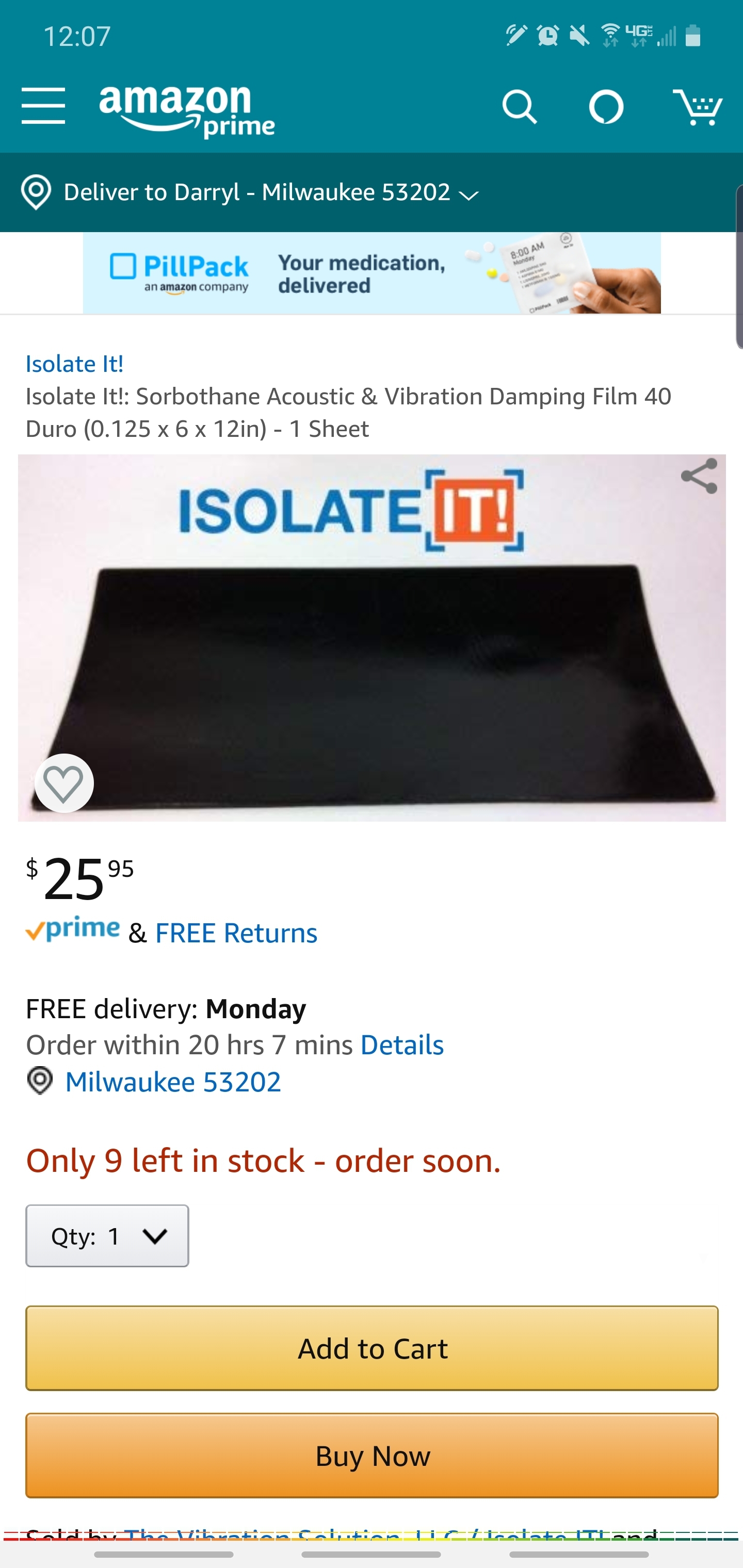

I’m using this stuff they comes in 30 to 60 duro…Could be more.
Mounting everything to strong velcro onto the actual board, and reducing wire lengths such that there is no slop has completely silenced my board.
Perks are it makes everything very easy to access should i want to add or swap components, it looks very clean, and i dont have to worry about unplugging tons of shit when i remove my enclosure.
Cant take credit for that idea though, thanks @Psychotiller
Line the bottom of your deck and the entire enclosure with cheap dollar store thin art foam. Even if things bounce around in there it wont make much noise.
silcone gun+foam+zipties=secure and rattle free:+1:
Velcro the shit out of every component: battery, VESC, even remote receiver. Never heard any sound out of a board.

Mind sending a photo? Trying to achieve the same concept of having zero rattle, just not sure what foam to use or put them in between so the electronics won’t touch, same time padded
I use various pieces of scrap closed cell foam from packing materials in various packages I’ve received. Basically just trash. I try to avoid using open cell foams.
