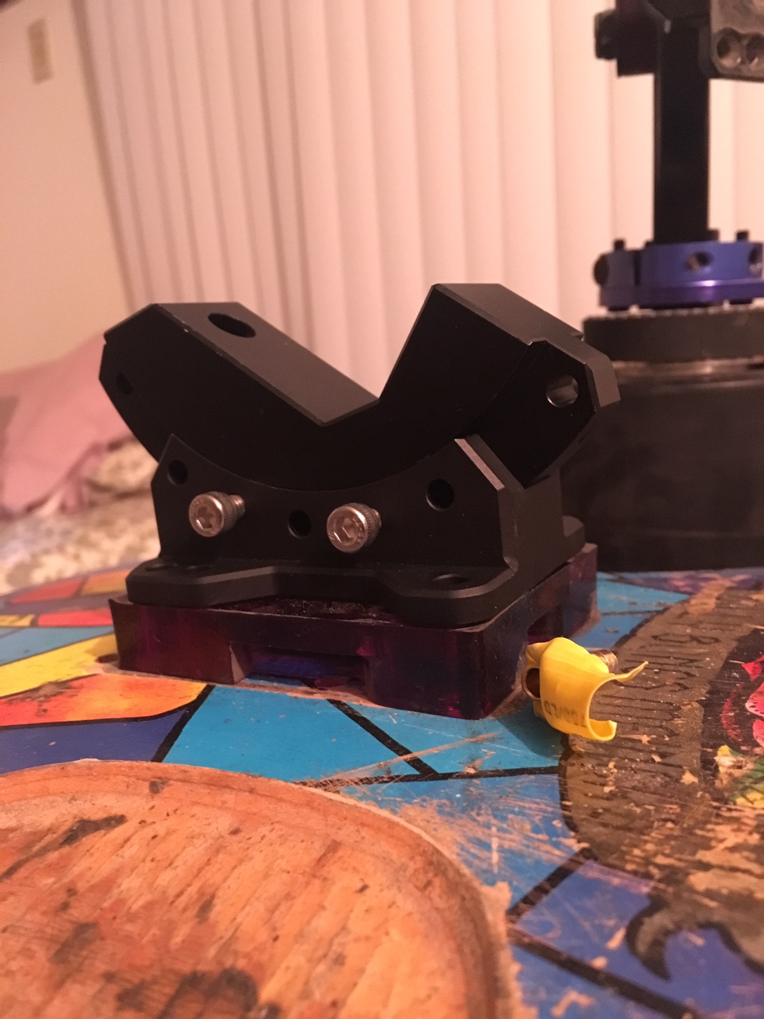

I wanna go riptide tunnel riser + Hammocks, but that’s alotta riser.
With just the tunnel riser I loved the feel and was very stable at high speed, which is what I’m going for. What am I compromising/gaining by this much riser?? @Skunk? =)

I used to be anti-riser but actually felt way more stable with the tunnel riser, contrary to my intuition. I just love the cable management with that riser and wanna use the hammocks. And yeah @Skunk TB110’s, shit’s gonna be pretty high up. Might just give it a go with a really low angle

The Hammock baseplates look like they have about 20mm of built-in rise (at 50 degrees versus Caliber 2 according to my empirical measurements) and the Riptide Tunnel Risers are 14mm thick. That’d be over 34mm of riser which is a lot but not completely absurd. It’s right on the border of absurd, though…

the less the better. Hammock adds around 20mm riser at 50degree. I personally route a channel in the deck and run the cable underneath. I like low ride board.
Anyhow the hammock is mounted reverse. Logo in front :slightly_smiling_face:
I am running a 3mm rubber riser at the front, and a flatland 3d bash guard and tunnel riser at the back. However I am running 60 deg at the front and about 35 at the back, so the risers helped balance the height and they are the same now. If you plan to do split angles than the tunnel riser should be fine since a lower angle will make it low.

It’s not that it limits speed but it increases leverage between deck and trucks.
Witch makes wobbles a bit more interesting.
i’ve gone about 46 km/h I believe. not as fast as others, but that’s when my board tops out. Had wobbles once and drove them out.
The trick to avoid wobbles for me, seems to be tightening the back truck instead of both/front. That makes it still very turn able but all the wobbles disappear at the back of the board instead of continuing.
