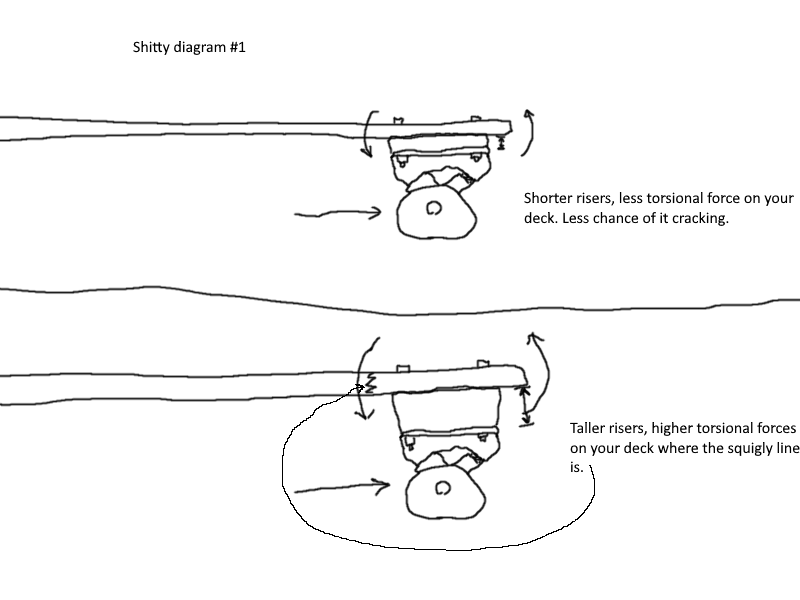

Really, you shouldn’t be using too much riser. Ideally, only use as much as is required to eliminate wheel-bite or any other clearance issues you might have on your setup.
The main issue with too tall risers is the increased forces on your deck. Certain decks this is a huge issue. Drop through decks, top mounted, no reinforcements on the deck with tall risers- this is probably the worst case scenario. Something like an evo with wheel cutouts but no drop though cuts, not as bad but I’d be weary adding excessively tall risers to it. A top mount deck with lots of wood around the mounting holes, no cut-outs to reduce wheel bite, I wouldn’t worry about using too tall of risers nearly as much - and this is where those X-Thingies come in handy… They take the stress off the tiny hole and spread it out across the wood all around the mounting holes: Great!!!
But these X-Thingies are only as good as the strength of your deck. They will prevent your hardware from digging into/weakening the wood around the holes themselves, but on a drop-through/cut out style board, they won’t magically prevent your board from snapping at it’s weakest point.
So, TLDR, use as much risers as you need to prevent wheelbite. Going any higher is not really doing you any service unless your enclosure doesn’t clear the ground or something. If you need to use channel risers to route your cables, that’s fine, but if the only reason you are jacking your board up to the cosmos is easier cable routing and your board becomes excessively tall, maybe consider 3d printing an alternative cable routing solution.
shitty diagram for reference:
Since your board is a top-mount deck, being this tall is probably just fine. And you can probably loosey-goosey those trucks with some soft, high rebound bushings and get some crazy good carving action going… if you’re going to jack it up high, at least take advantage of it. I’d look into some of those X-thingies or at least use pan-head hardware (and even add washers) when mounting your trucks for sure.
