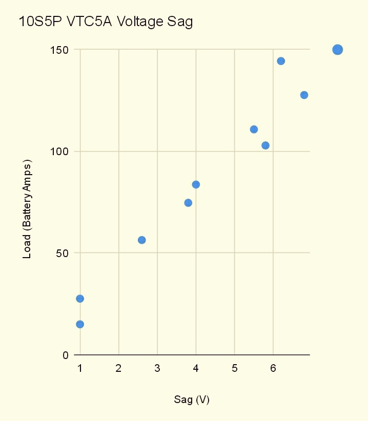

I graphed some data points from a few recent metr logs.
That’s a nice graph. Just wonder how the state of charge does influence the voltage sag. Could imagine that the sag is different at 4.2V than at 3.3V with the same load :thinking:
I took these few days points from all over, from full charge to the end of some rides, and overall it seems to be fairly linear from the looks of it.
I think a voltage sag metric would be a cool addition to metr.
Yah change in voltage from totally full to totally empty is only a 1.2V difference per cell in series so I wouldn’t suspect the charge level has a huge effect on the sag, that said at lower voltage some sag is likely to put you down under the safe discharge voltage so want lower discharge at lower voltage but luckily the vesc soft and hard cut offs seem to basically handle this if set properly.
Just looked through some of my logs looks like about 2V of dip at about 20A draw for a 10S5P LG HG1 cells I think. My lipo based one is more like .5V to 1V drop with around the same current draw.
Take numbers with grain of salt. No lies but I’m a small dude around 115lbs and on flat ground so my current draw is relatively low. Pneumatics are still about half efficiency compared with urethane build too despite the light load.
Oh also the voltage sag I’m pretty sure is directly related to the internal resistance of a cell and so shouldn’t change much over a single discharge but may change as the battery wears over time and has more cycles.
