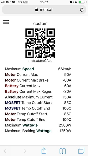

I just finished my 10s4p 30q pack and saw 2V of sag (from 36.2V to 34.2V) @ 60 battery amps.
You better start building a battery NOW. Unless that’s an 11S LiFePO4 battery… but I assume it’s a 10S li-ion
Might also want to lower your “battery amps” number to strain it less
