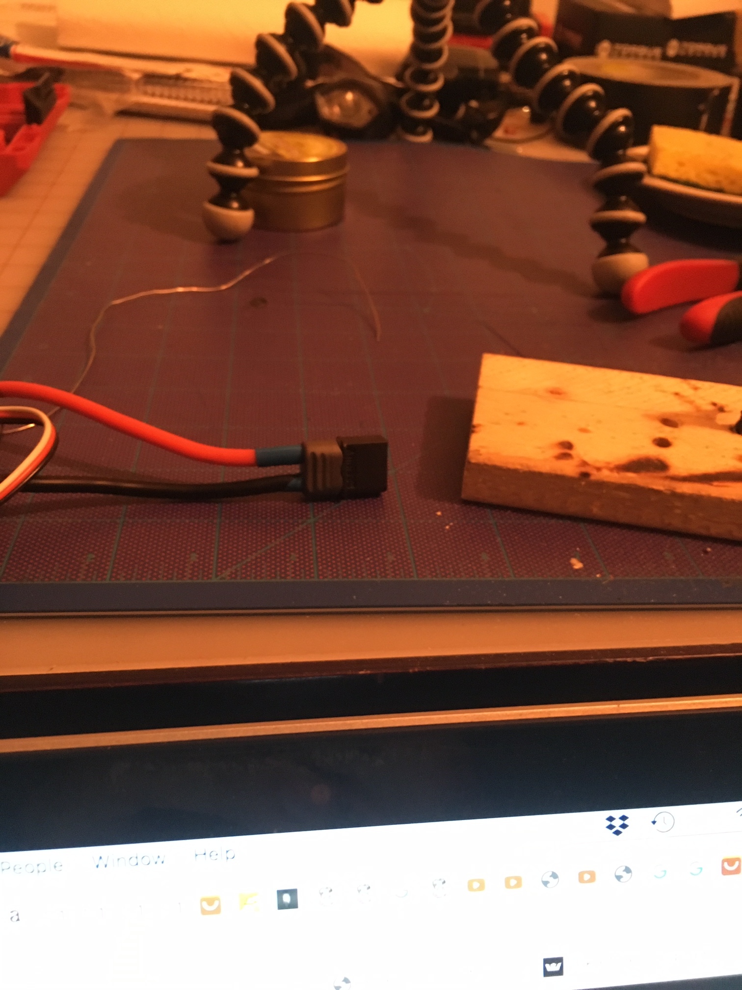

SUCCESS on my first try! Thanks guys!
Oh that tin is that green type flux I posted above but I didn’t use any of it
