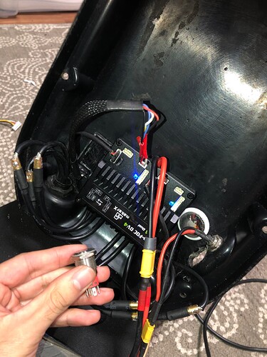

I have a go-foc D4 and was wondering if I could use this switch to power it on and off. Do I need an anti spark switch instead ?
Yes, get the Flipsky Enhanced and it will give you both the switch option and roll to start/auto shut off.
BUT a loop key is still the only mostly foolproof on/off method.
Dude heatshrink those motor phases. If they short while riding your ESC is gone and you’re going flying.
Well it depends if momentary or latching, as well as the usuable reliable connection points. If you have antispark connected before the esc i believe you can.
Just use a loopkey. It’s cheaper and more reliable.
