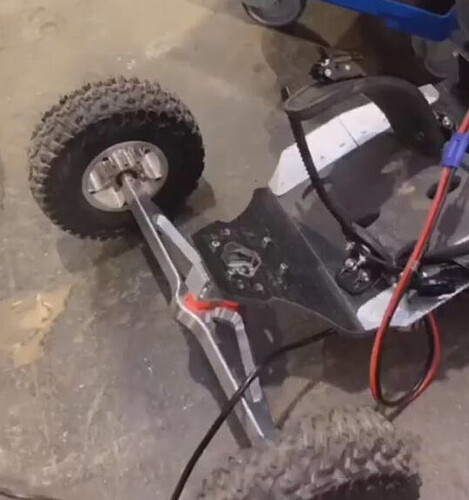

Our team members used Venoms in the initial test phase. Jens from E-Toxx (the first who made such NoSno style PKP trucks) used FIBRO industrial bushings.
grafik
He also made 2 and 3 Kingpin designs.

Lateral shift works against steering. In consequence you lean more and get less turn. The feeling is less responsive. There is no one solution that is perfect in all ways. The channels are more responsive and more stable at speed, even if they are set to allow a tight turning radius. The twin kingpin design is more simple, has less mechanics involved and works for most riders in our team. However, it is not the golden solution…
So no problems here, someone used a known principle and design and everyone is happy about that.
