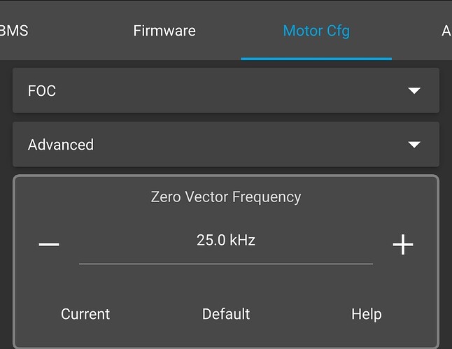

I played with switching frequency this was almost silent but switching freq only accessable from BLDC mode
FOC has no switching frequency as I see in vesc tool
Hello sir
Well I tried every single frequency from the minimum (3kHz) to the app maximum (60kHz) it only changes the motor shusing sound frequency but still shushing
It works silent when I write the command you told me to try , but on adc its always shushing :disappointed_relieved:
It’s in the MotorSettings > FOC > Advanced tab

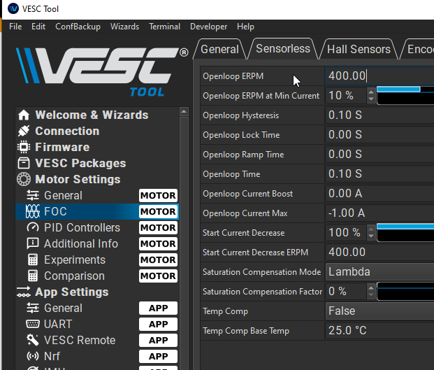

Here is something to try. You could force the VESC to run in open loop for longer. Might be able to detect once the RPMs are high enough, or if it’s totally broken then you could do just open loop, but this is a really inefficient way to run a motor

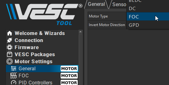

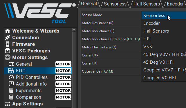

Set the motor to FOC and the sensor mode to sensorless
Specifically these fields:
Then play with these settings, specifically the Openloop ERPM. Change it to something like 5,000 or 30,000
Then why it works smoothly on BLDC mode ( speaking about the big motor) and why it runs smoothly on the detection , and why it runs smoothly on open loop command, plus it was doing that even before the incident
Ok i will try this and tell u results
detection runs in openloop
foc_openloop runs in openloop
These modes just send power to the motor without any feedback.
To run with a throttle, or with controls from the VESC tool, it runs in closedloop where it takes data from the motor. Somehow it’s not getting that data from the motor… or the signal is too weak.
Can also try increasing the amps from say 10 to 40 even on that little motor, to try to force it to start spinning up. The voltage readings from the motor will be stronger at higher RPMs. That’s part of the goal of modifying the openloop sensorless settings above. To get the motor to spin up faster before switching to closedloop.
