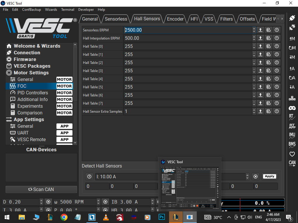

here I’ve changed sensorless erpm under hall sensors to 50k instead of 2.5k and the motor spun as smooth as it was shown in BLDC mode, so what is this ? and how its called sensorless erpm and its under hall sensors ?? ( the motor doesn’t spin when i unplug hall sensors cable)
yee I tried the playing with open loop erpm and increased open loop time to 3 sec , both motors were running ( but rough) in open loop for 3 sec and stutter then 3 sec open loop and so on, here I knew there is something wrong with the sensorless feedback .

in the detection the small motor works so smooth the big one sometimes work and sometimes no, and it results shows hall sensors, so it detects the feedback , at FWD and REV it spins normally but when I unplug hall sensors it doesn’t spin

ā€œSensorless ERPMā€ in the Hall Sensors settings is the speed above which the hall sensors aren’t used. Sensors are only used to start from a stop.

senseors are used when motor starts and when its loaded to keep phases in sequence all the time and never miss any step even when loaded excessively

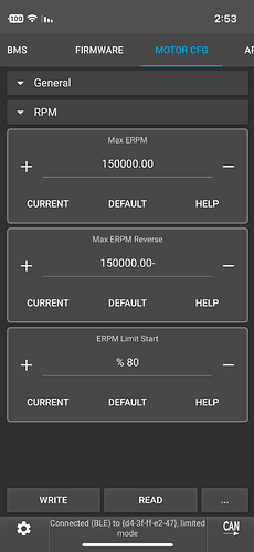

hi everyonešŸ‘‹ Maybe someone here can help me please.? I have a flipsky 75200 controller on my bike everything works fine for me except for one thing. when I move the bike backwards I can’t give gas to go forward, the gas handle doesn’t respond, it happens to me when I climb a hard mountain and stop for a moment, only if I stop completely I can give gas,and if I even go backwards a little bit the throttle stops responding. (the bike only has a mode of traveling forward)
Decrease ā€œminimum erpmā€ to -50000. It’s probably at zero.
Hi, thanks for the response. I can’t find setting of min erpm it is registered under a different name? or can you tell me where it is? I use foc hall sensor
What firmware name and firmware version do you have?
Its a custom file
Fw:v6.0
Hw:fsesc_75_200_ALU
This is the firmware that work best for me Except for this problem
Motor Settings > General > RPM > Max ERPM Reverse
Tap ā€œRead motor Configurationā€ first (on the right side), then change the value, then tap ā€œWrite motor configurationā€
So i didnt tuch that setting its unlimited
150000

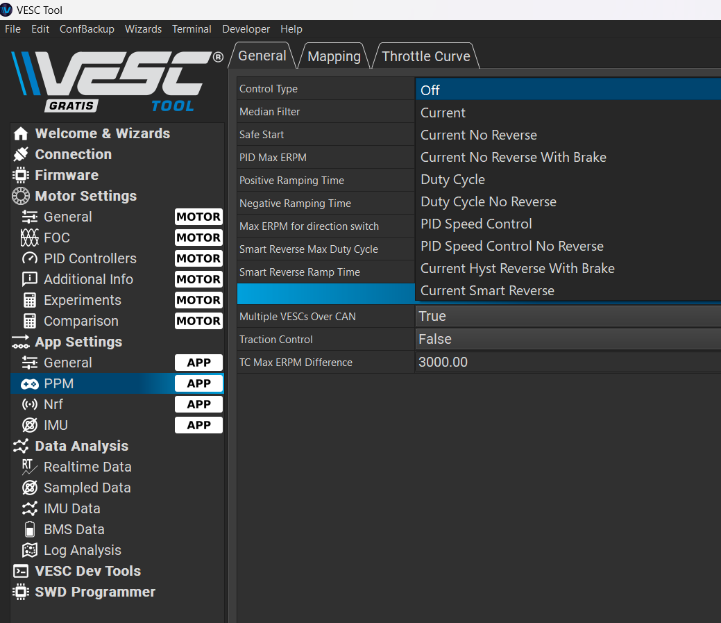

What control mode are you using?
Wait, actually this isn’t correct. Change it to negative. Make it -150000
:wave: hi im using current
