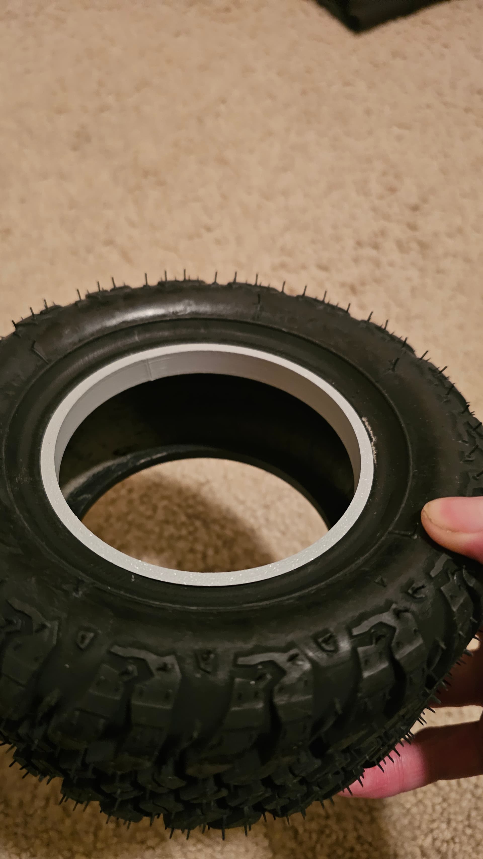

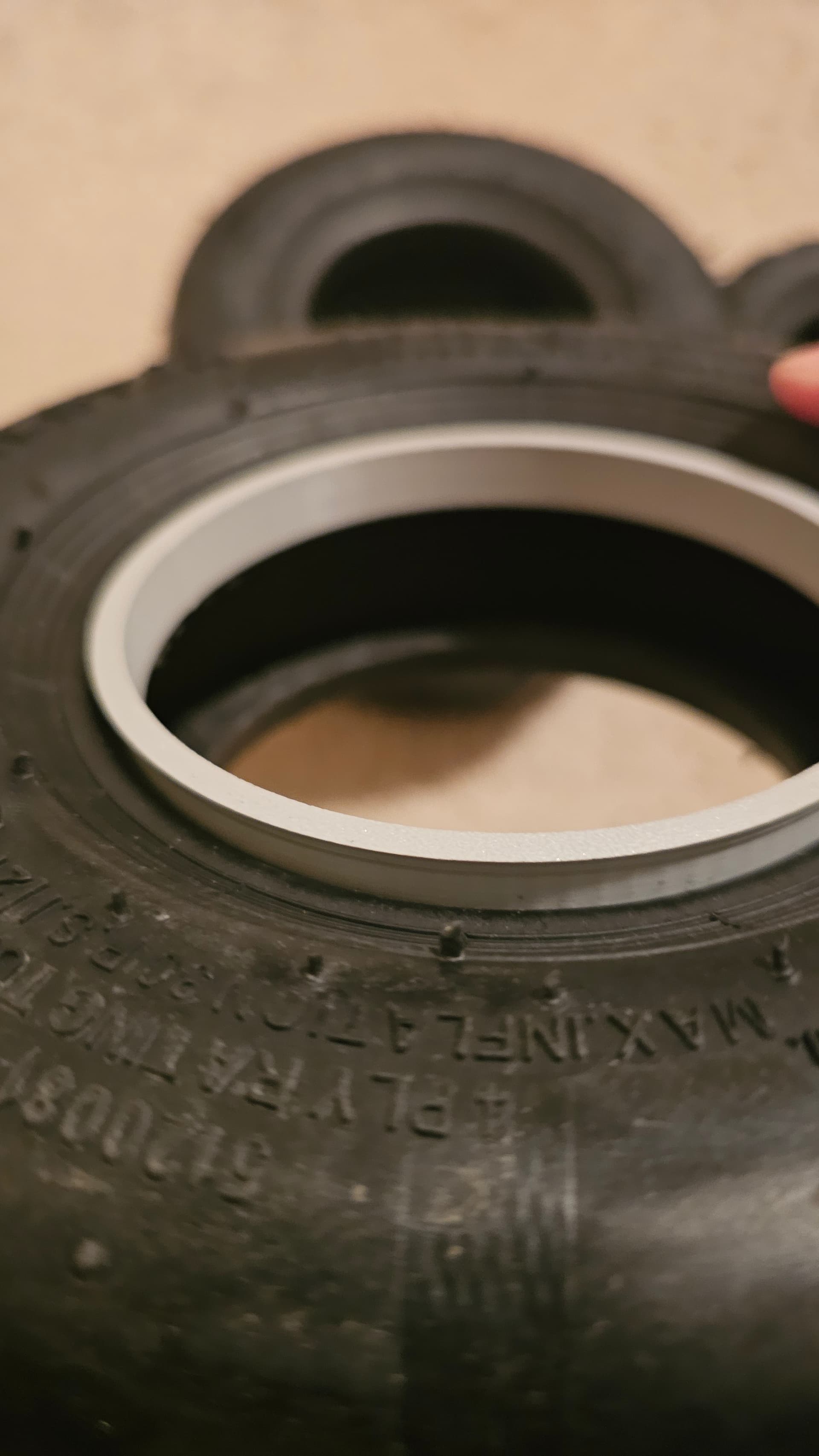

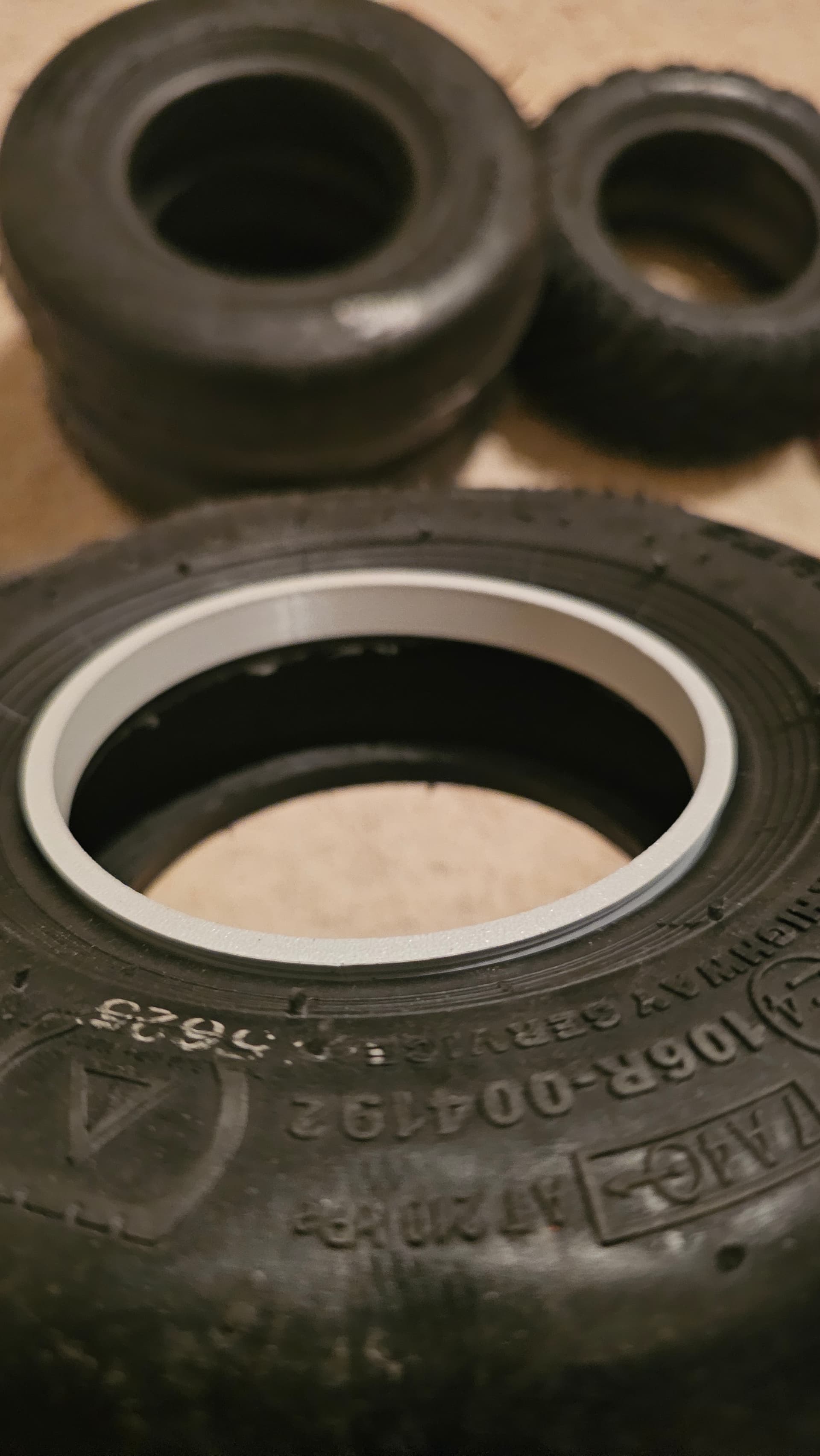

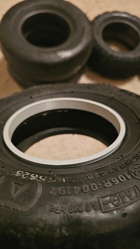

I think I have 5stars…not sure if the hub barrel is the same as the rockstar. But I am going to make some spacers to make them wider. I’ll post it up when I do it, maybe it’ll work for the rockstar also.
You just have to watch out for axel length. I was originally going to do this to one of my builds, but realized if I made the hub that much wider, then i wouldn’t be able to get my axel nut all the way on.
But another build that I have has long axels so I’m planning on doing it for that build.
I’ll let you know how it goes when I decide to put it on.

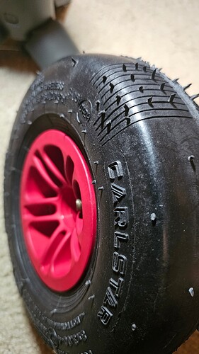

This is what it looks like on the offroad tire.

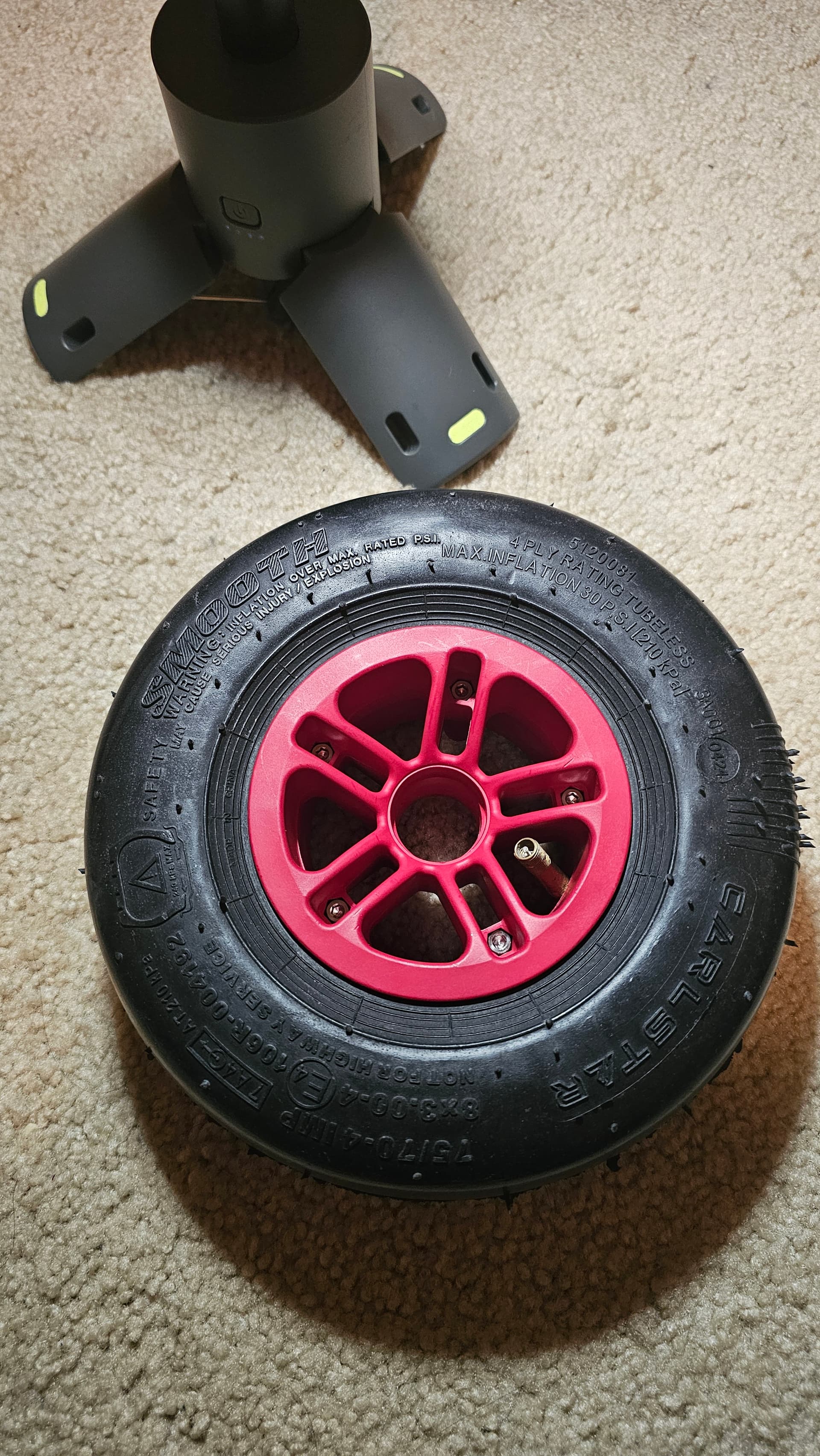

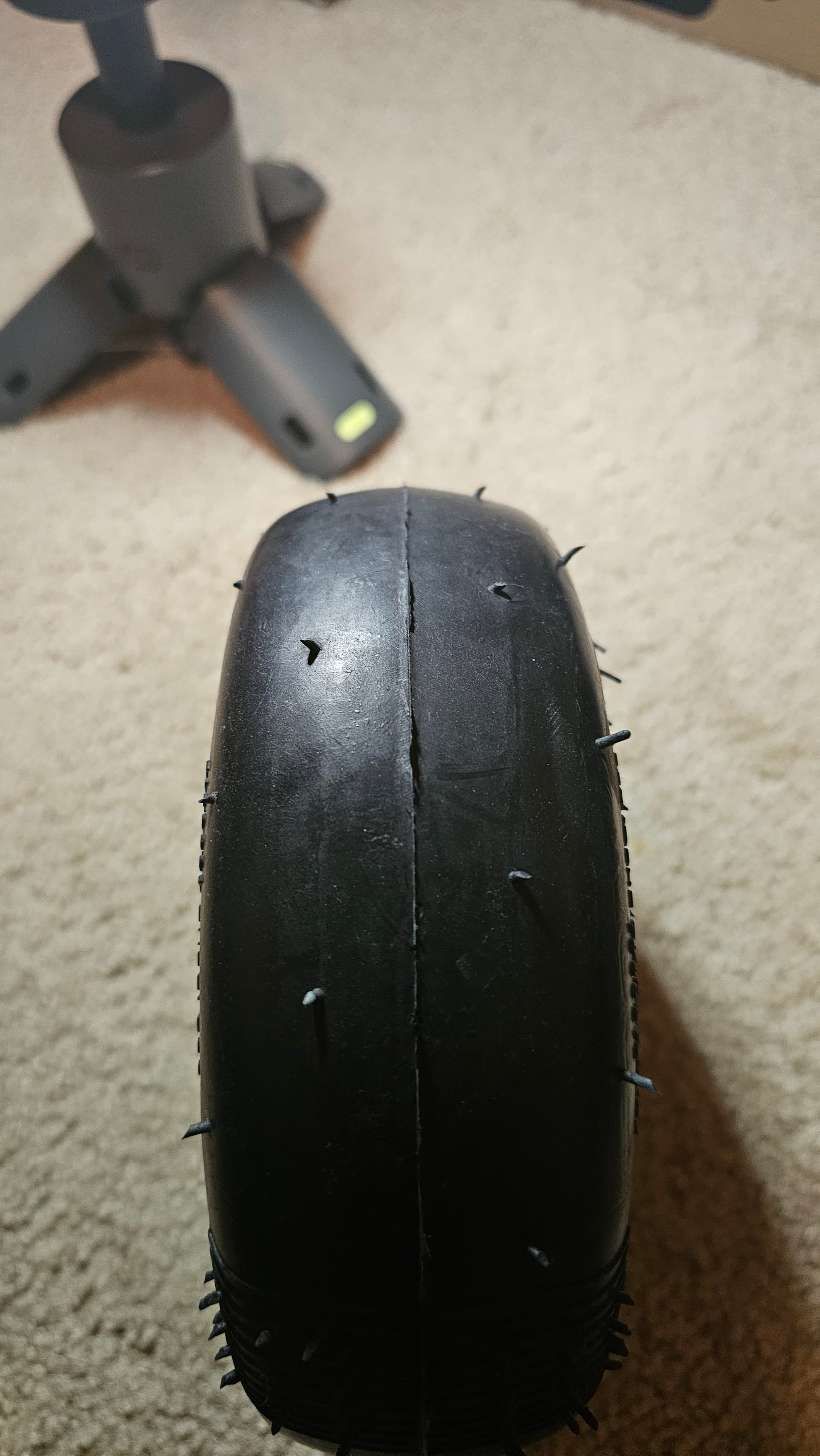

This is on the slicks. Most of them are like this, I’m pretty sure if I inflate it will pop into place.
Yes but you need much more axle length. Each side of the hub splits in the middle so the bearing spacer is widened as much as the inner seat. The metal MBS wheels split right on the edge of the rim so extending them doesnt extend bearing spacer.
@Jmwilson22 This is what it looks like with the slick on it, seems to sit properly . Gonna deflate it later to check if 3d print lip gets deform or not.
