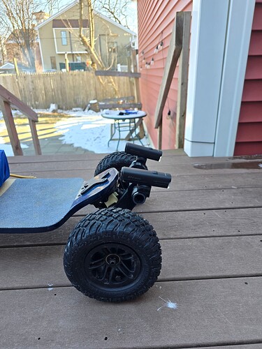

    TPU/CF bull bar

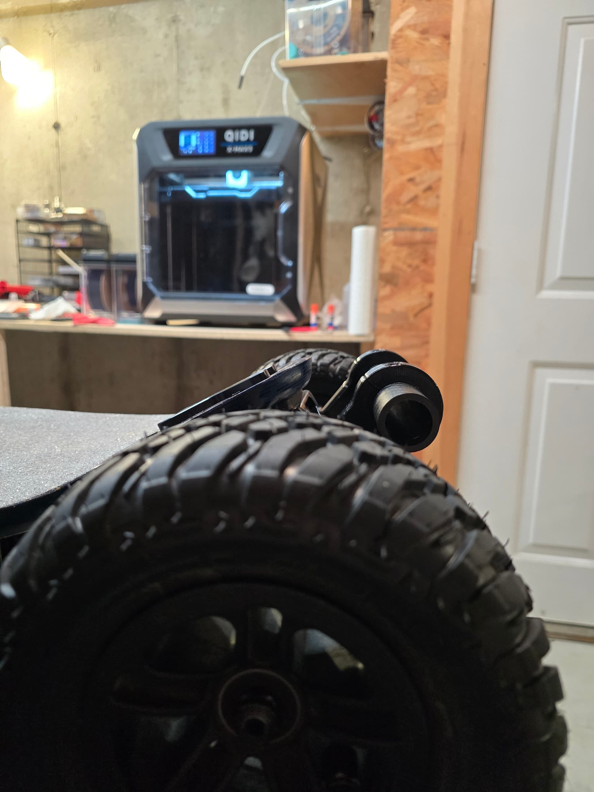

Bull Bar
designed in fusion
goal was to print something as low profile as possible so that it wouldn’t increase the footprint of the board
printed arms in 95A tpu, they are rigid, but would flex on impact
use to drag board around as well as mount lights

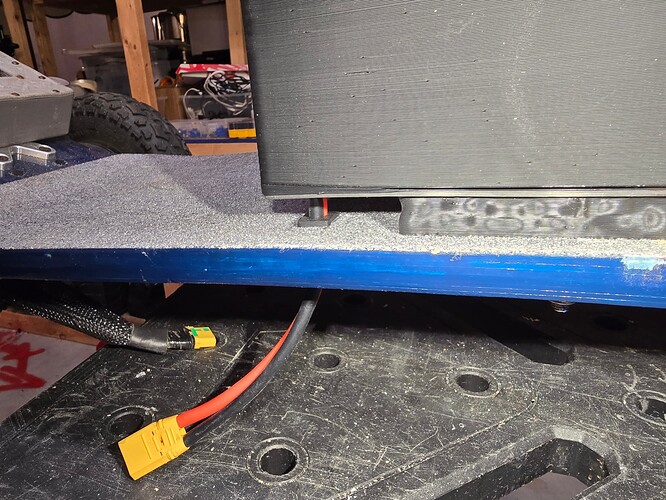

Wire management
power wire runs through deck and in a printed channel along the bottom
xt90 to vesc is sealed with flowable silicone using a syringe

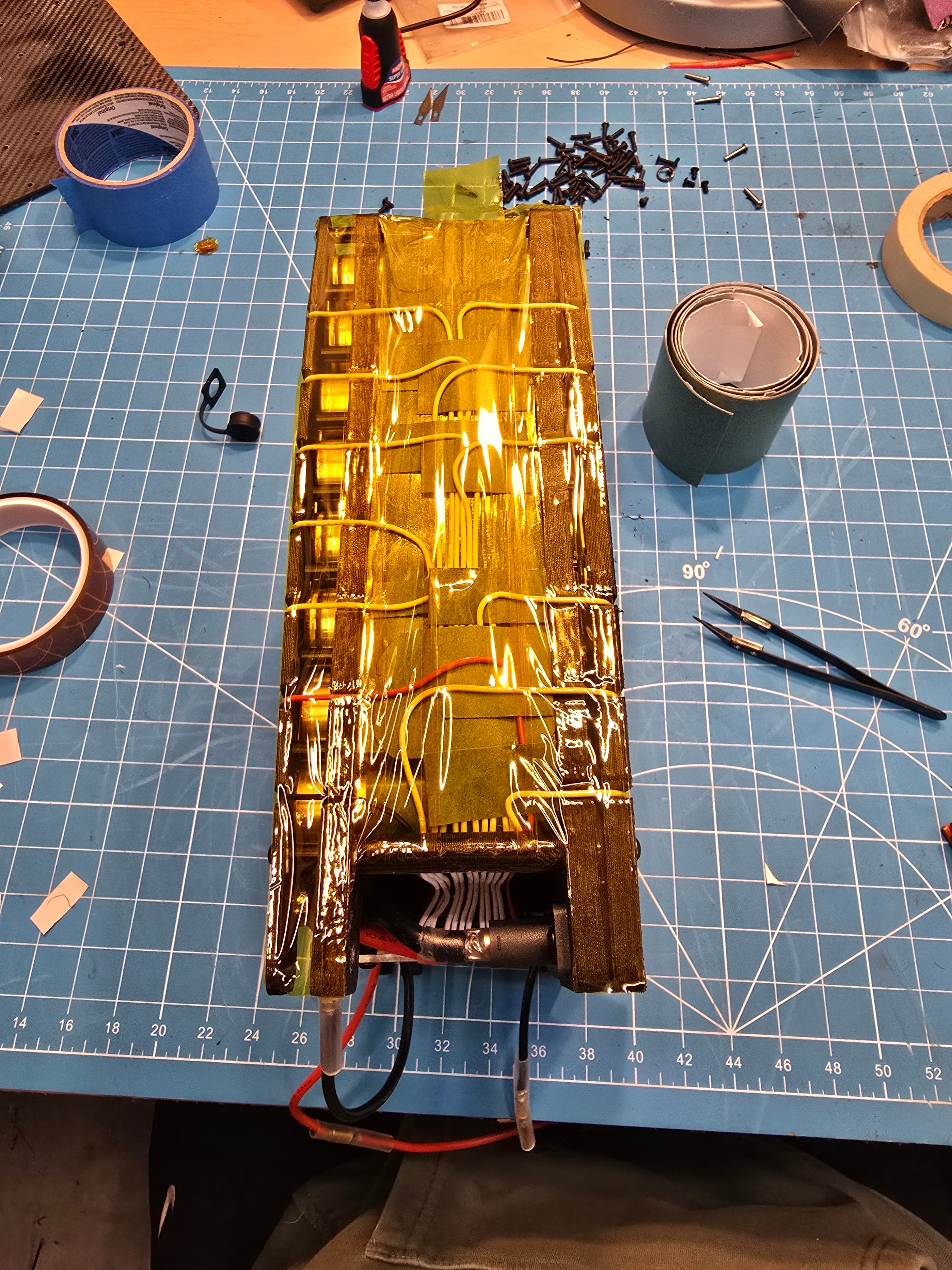

Battery Build
12s6P Molicel P42a
LTT smart BMS
designed in fusion 360
printed cell holder in PA6-CF and body PET CF
top and bottom plate 2mm carbon fiber hand cut and drilled
weipu SA12 charge port - charge at 12A
Internal xt90 shielded by tpu gasket
8GA battery wire runs to vesc
(3) M6 studs through bolted to deck
TPU vibration damper allows deck to flex without straining the battery. absorbs road vibrations also

What happened here?
Dude.
So much cool stuff happening here.
Great work.
I really want to try a set of these tires.
Long story short, built my dream board 15s5p…once I was done, I realized I still couldn’t get the range that I wanted so it disassembled the pack within.a couple months and built a 14s8p molicel P45b pack for it.
These p42a cells I re-used for the current 12s6p build you see here.
Cells were originally bought new, used for a couple months then re-claimed. My 15s5p pack was build using (3) layers of .3 nickel and was a bitch to tear off.
So what you are seeing is a deformation from the nickel being removed. Not ideal, but all the cells tested great so I went with it
