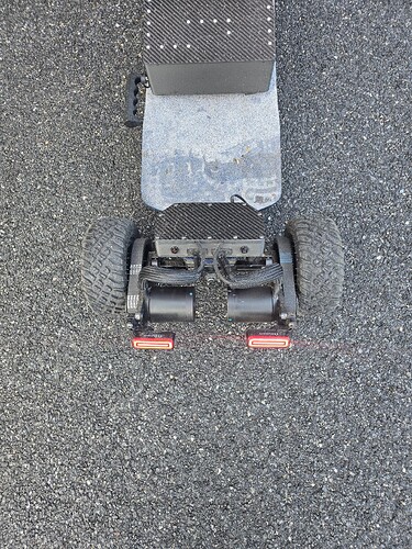

Quick Update

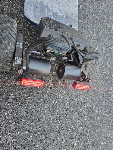

Swapped the reacher 7490 171kv out for flipsky 6384 140kv. I had these in the parts bin and they seemed to have solved my thermal throttling issue.
Added some custom mounts on the back for olight tail lights
Made a custom mount for olight headlight up front
Installed 20 mm belts. (20t motor 68t wheel)
Ordered some reacher 6485 173kv.
Wiring for flipsky motors is temporary since I’ll be swapping them again. I printed a thicker gasket with cutouts for the wires. Still looks reasonably clean to hold me over until I do it up for real again
Ditched the flipsky 6384s and added some Reacher 6485 173 KV.
Got my cables cleaned back up. Soldering the weipu SA8 6 pin was a bitch for the sensor wires.
Created a hard TPU wire channel to protect the Davega cables, same thing for the power wires.
Cut my carbon fiber vesc enclosure to panel mount a connector on the bottom for Davega cable. I use a jewelers saw for making cuts like this in carbon fiber plate.
Basically caling this one done at this point. I just need to come up with a name.
