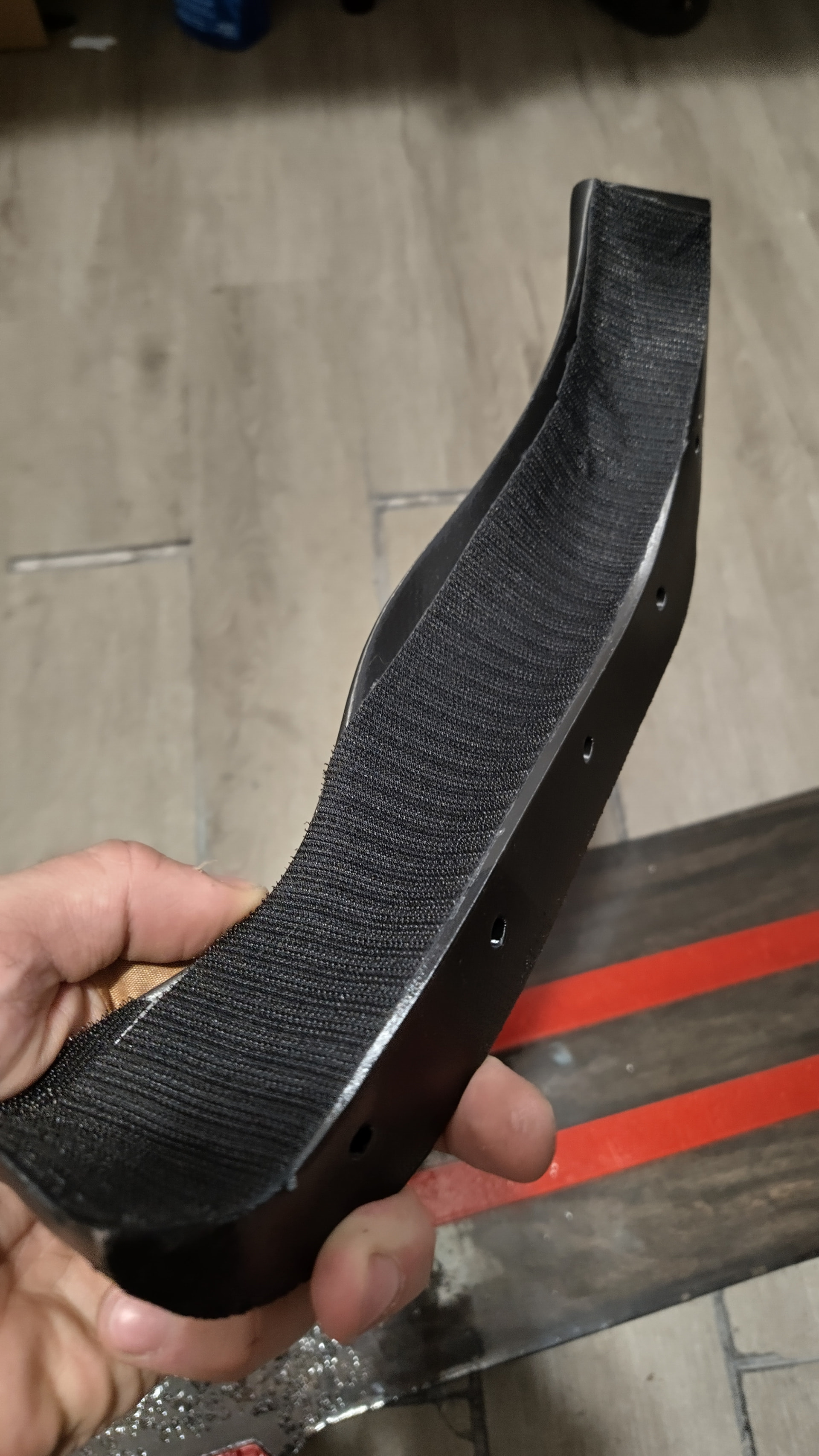

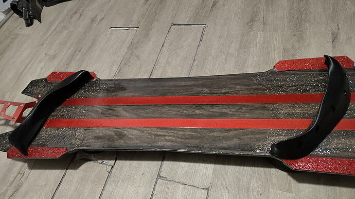

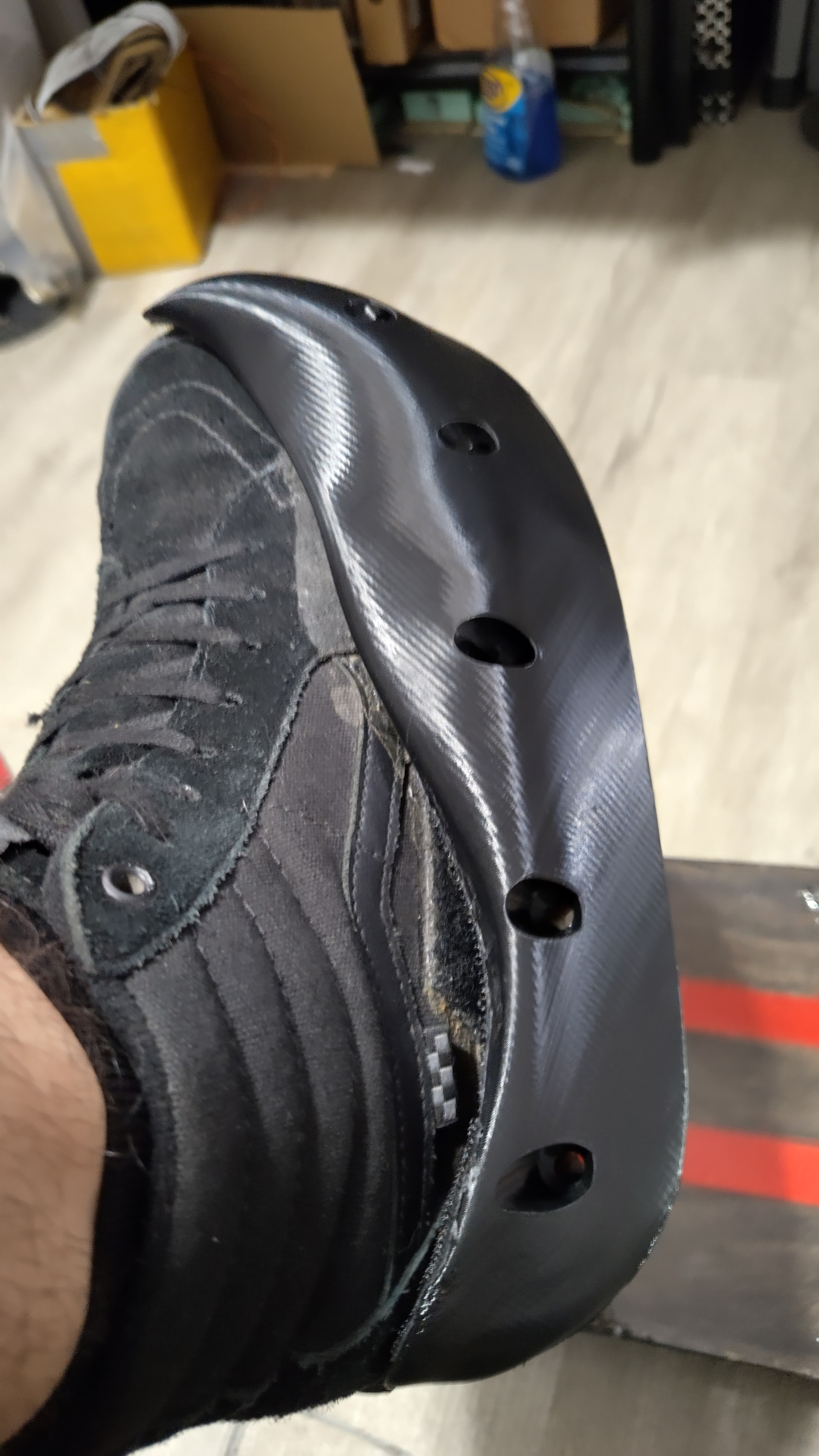

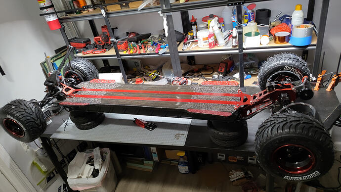

Finished printing a new version of my jumbo Velcro footstops. Heat gunned em, put on some leather gloves and smushed them into a perfect fit on the deck and around my shoes, then put Velcro on the inside. I’ll mount them to the deck once the board is put together and I can feel out my position better.
FootstopV2.stl (5.3 MB)
Mounts with M6x40 flat head screws
Wait a minute… Thats very clever!
It’s like, half as good as an actual binding, but you still eject normallly in a wipeout, so I think it’s safer

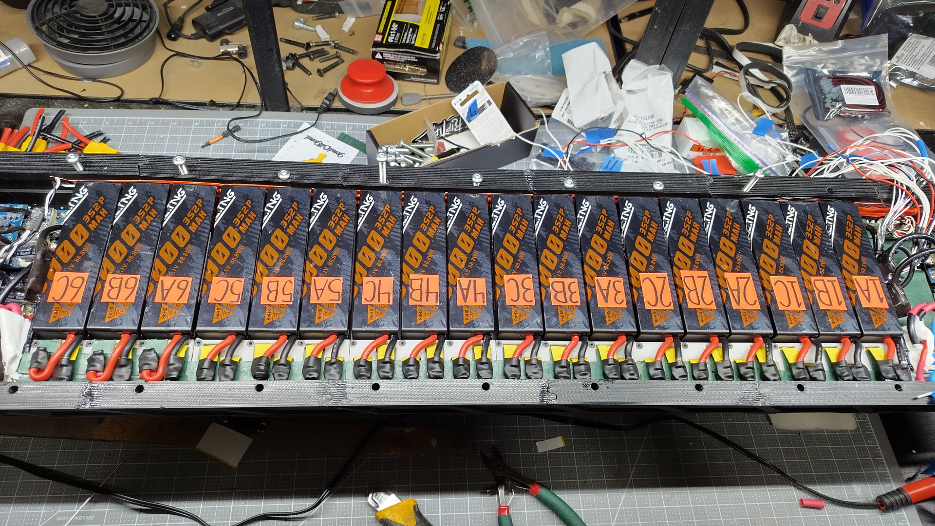

My steadfast assistants are trying to make sure I get the BMS wiring done before the deadline

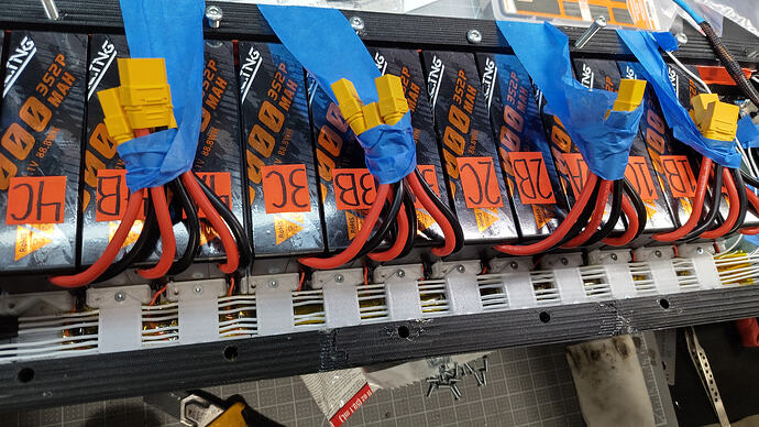

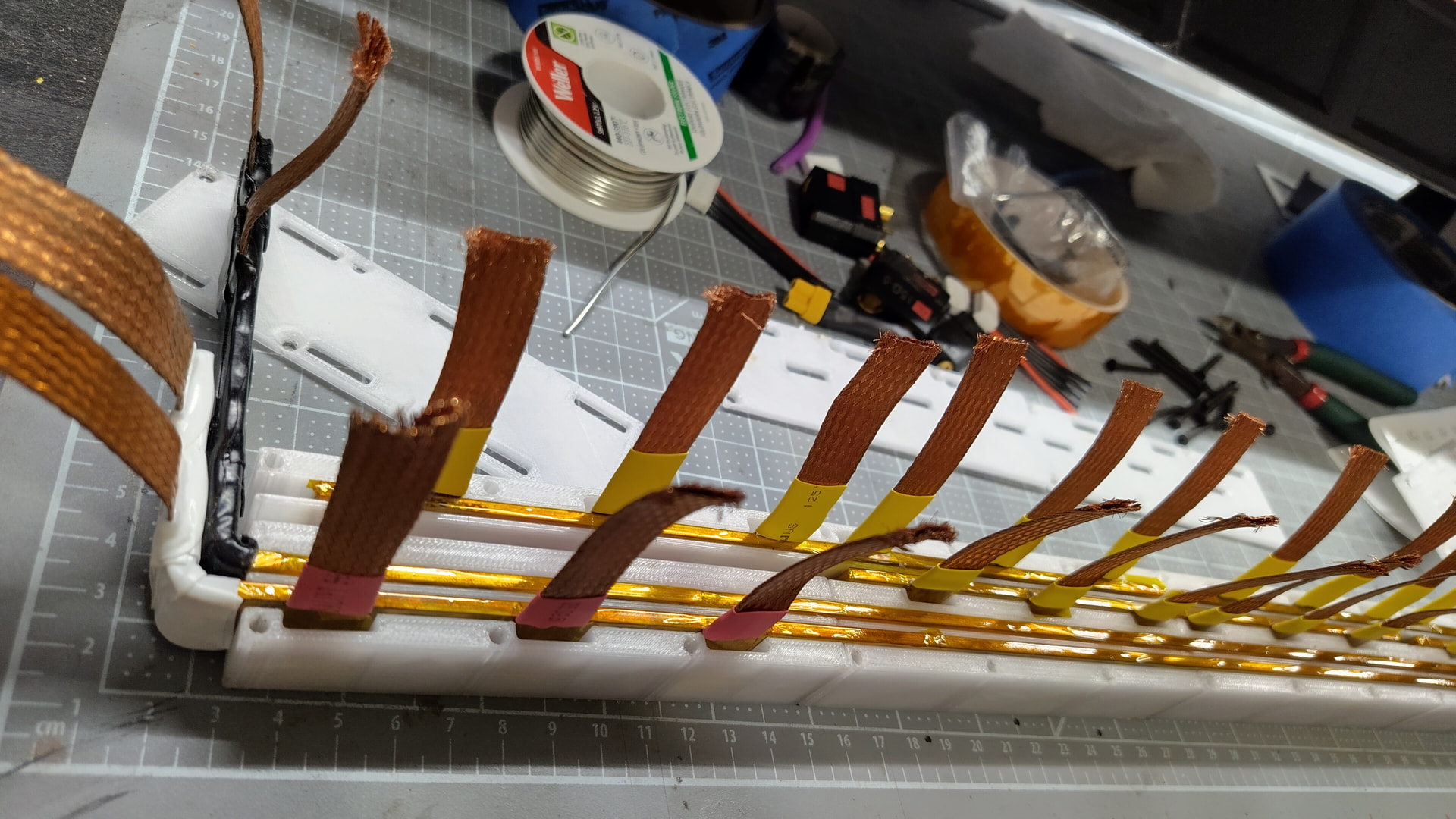

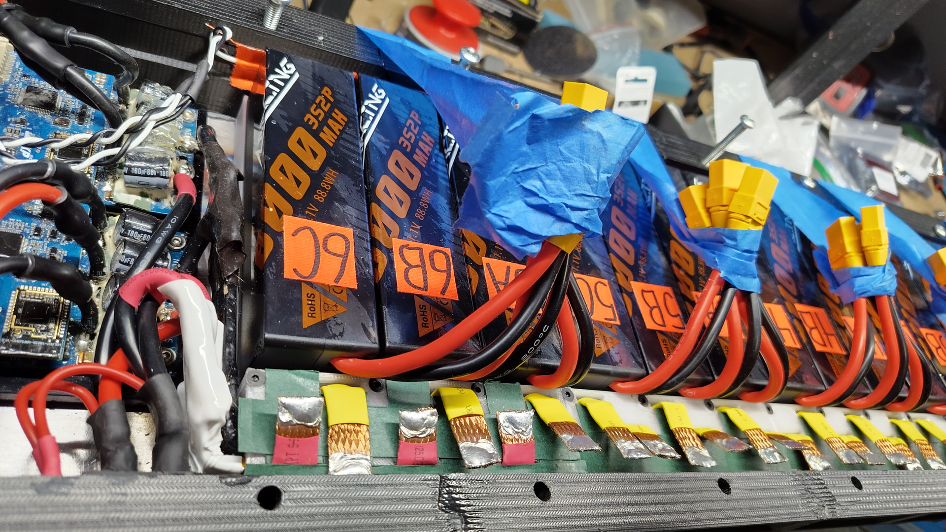

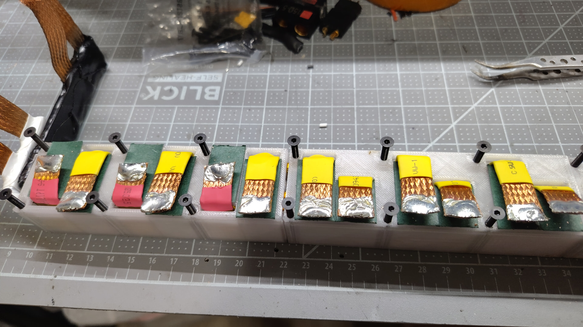

The balance wires are all connected and routed. This strategy looks very neat, but it actually does involve a lot of crossovers where 2 of the battery packs fork into the parallel line. I’m handling those junctions by potting the area with e6000 to immobilize the wires, as well as stuffing pieces of kapton tape between the different layers.

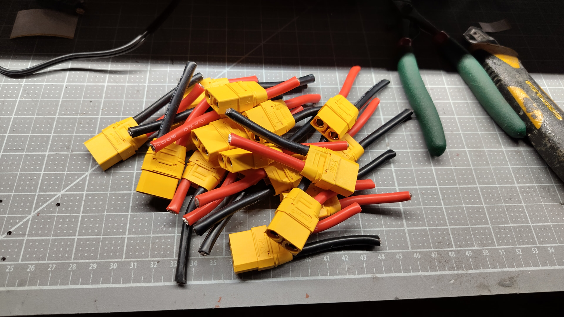

I made it through another round of inverse bomb defusal without blowing myself up. If anybody needs just like, a big pile of xt90’s, hmu.

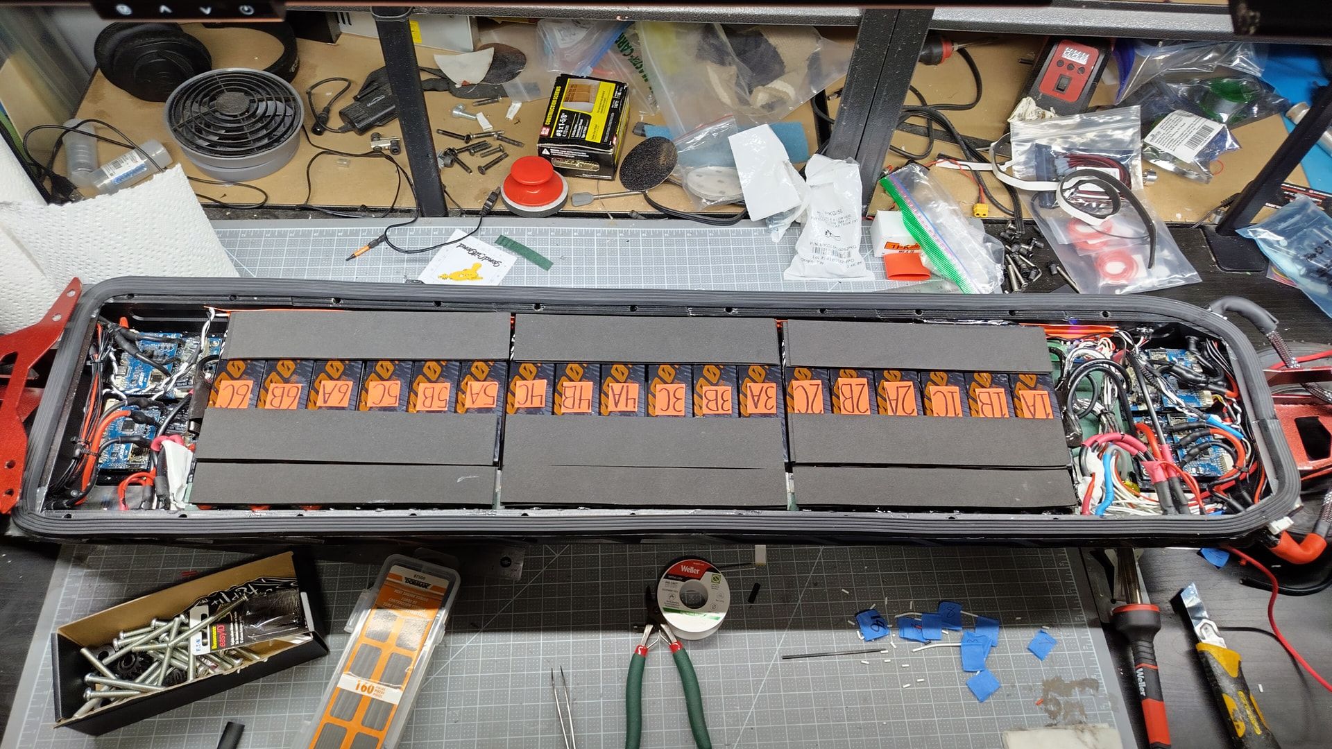

The enclosure in its final glory before getting sealed up

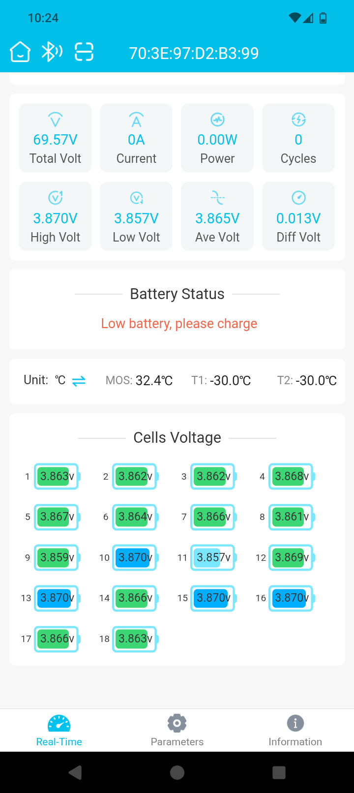

Oh JBD, please never change

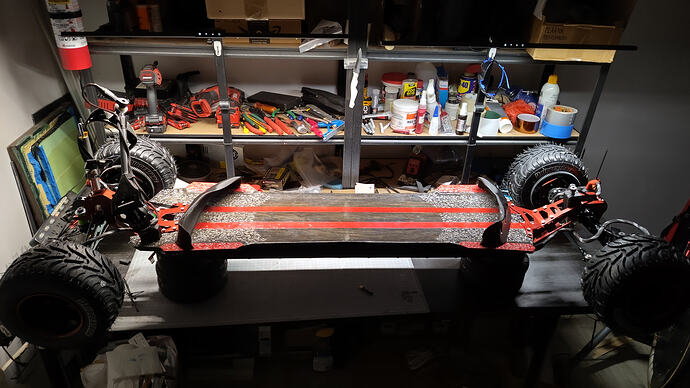

Damn this is frustrating. I bolted on the footstops and spun the motors up on the bench
You can see that upon braking, the right rear just started freewheeling, and you can hear a pop just before it finishes coasting down. I tried to accelerate again and it wouldn’t spin up. I caught a whiff of the magic smoke leaking out of one of the enclosure ports, so I pulled the loopkeys. I fear that she’s fucked, gents.
