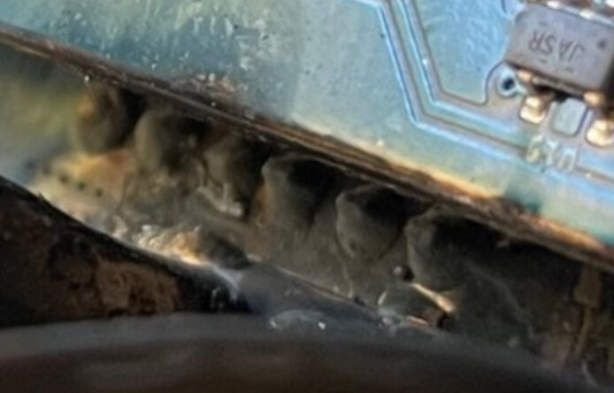

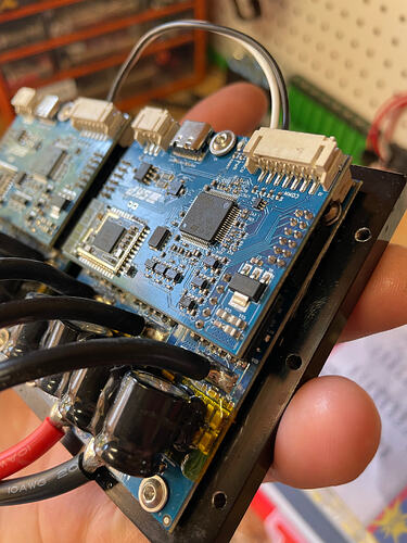

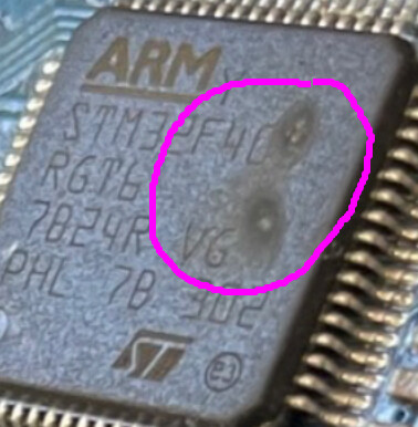

Super unfortunate about the esc popping. I’ll be curious to see where the damage lies. This is what mine looked like when it happened.
This Burn
I’m not sure maybe, I thought that was residual residue from the burn that’s circled. But you could be correct :man_shrugging:.
This was the other unaffected side.
I’d bet that was just the FOC set to 15–20 kHz. You shouldn’t spin the wheels by hand, either; free-spinning wheels are dangerous under full load. In theory, if you test the FOC at 25–30 kHz, your ESC will run a bit warmer and the motors a bit cooler. You will certainly get a higher motor sampling rate and be able to adjust the amperage to the motors differently, though it does slightly reduce the VESC’s ERPM performance.
Thanks for the advice about the FOC rate, I didn’t know that. The hand spinning was just to get them started because I haven’t hooked up sensors at the moment so they were having trouble on startup, and because I have no concern for my physical safety. Don’t worry about it.
I wouldn’t be suprised if it was just simply spinning the wheels in the air that blew it. High voltage vescs can’t handle freespinning the wheels. I blew my first D100s in a similar fashion 2 years ago.
Since then I never freespin stuff. Board on the ground is the only way I touch remote… Even afraid from deliberately doing violent burnouts.
Okay I’m learning a lot of stuff today LOL
But this is surprising to me because the size of voltage spikes should be related to the amount of current flowing, no? Do you know what the failure mechanism is for unloaded wheels?
Basically just don’t spin the wheels up in the air at all and you reduce blown vescs by a large number.
Not like testing in the air achieves much, bad soldering or config usually only surface themselves under high load anyways.
The main thing I have to test is that the center point and end points for my legstick controller are set in somewhat the correct ballpark before I stand on it and get it dialed in, but from now on I’ll try to keep the wheel speeds very low when I do that.
Yes exactly current should be proportional to voltage spike. To me this sounds like an unloaded spinup issue.
I haven’t confirmed this with actual data but to me the most plausible explanation would be that the vesc’s rotor position estimator loses tracking with our esk8 motors and fast spinups. When you lose tracking and don’t stop the switching, you get huge overcurrents motor side. But these happen so quick that the vesc sometimes blows before the overcurrent fault would trigger and stabilize things.
One thing with the SKP solo’s that sketches me out is that the recommended config is to have slow ABS overcurrent faults set to true - basically increasing the time an overcurrent needs to be present before it throws the fault.
If slow abs overcurrent is false, the chances of the ESC surviving something like this become much higher. But that means having to run a larger difference between the motor current you set and the abs max current otherwise you get faults all the time. The hardware values in the firmware doesn’t allow abs max to be set high enough to my liking for abs max current. I usually set something between 1.5-2x phase amps. Most vescs have noisy current measurements so unfortunately such a difference is a must in my experience if you don’t want faults to occur during normal operation.
