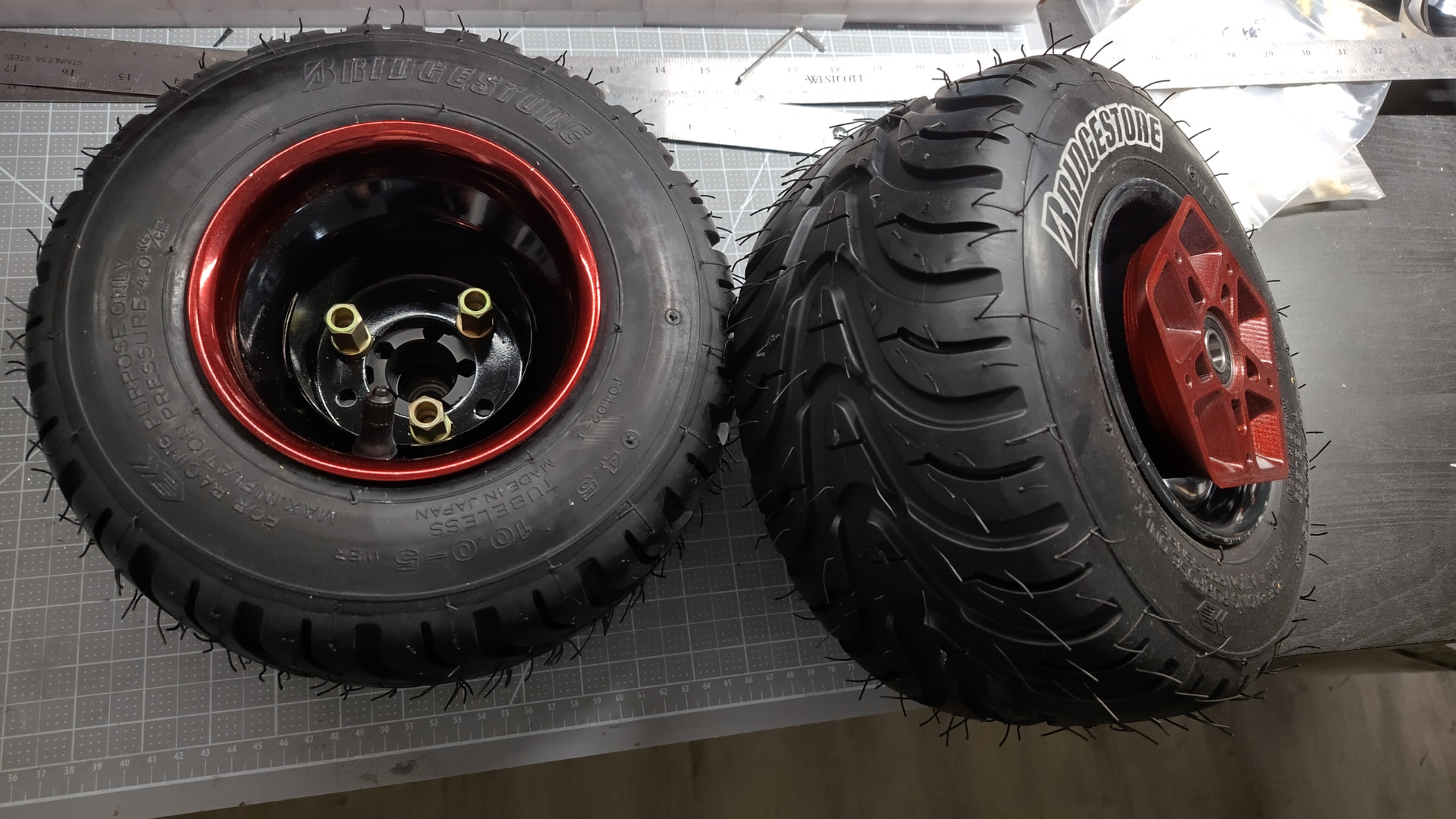

To fit points 1 and 2, the large tire diameter and high revving motors require a gear reduction at least 7:1, which would require 11T pinions on a stooge setup. I’ll be making laser cut 109T gears and matching motor mounts so I can enjoy longer service life with 15-17T pinions. Wheels are ready to go:

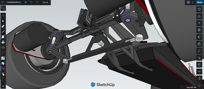

Taking care of points 3 and 4, I’m going to make my own trucks with a fully constrained pivot with about 45 degrees of lean, because I like Dualities but wish they went even farther. The rear will have no steer, and the front will have an ackermann steering knuckle system, go kart style. I think that lacking stable steering geometry (i.e. contact patch trails the steering axis) is really what’s holding boards back after you get rid of all the mechanical slop that normally causes speed wobbles. All of our conventional trucks get increasingly reactive as speed increases, which eventually forces you to choose between making the board rideable at high or low speeds.

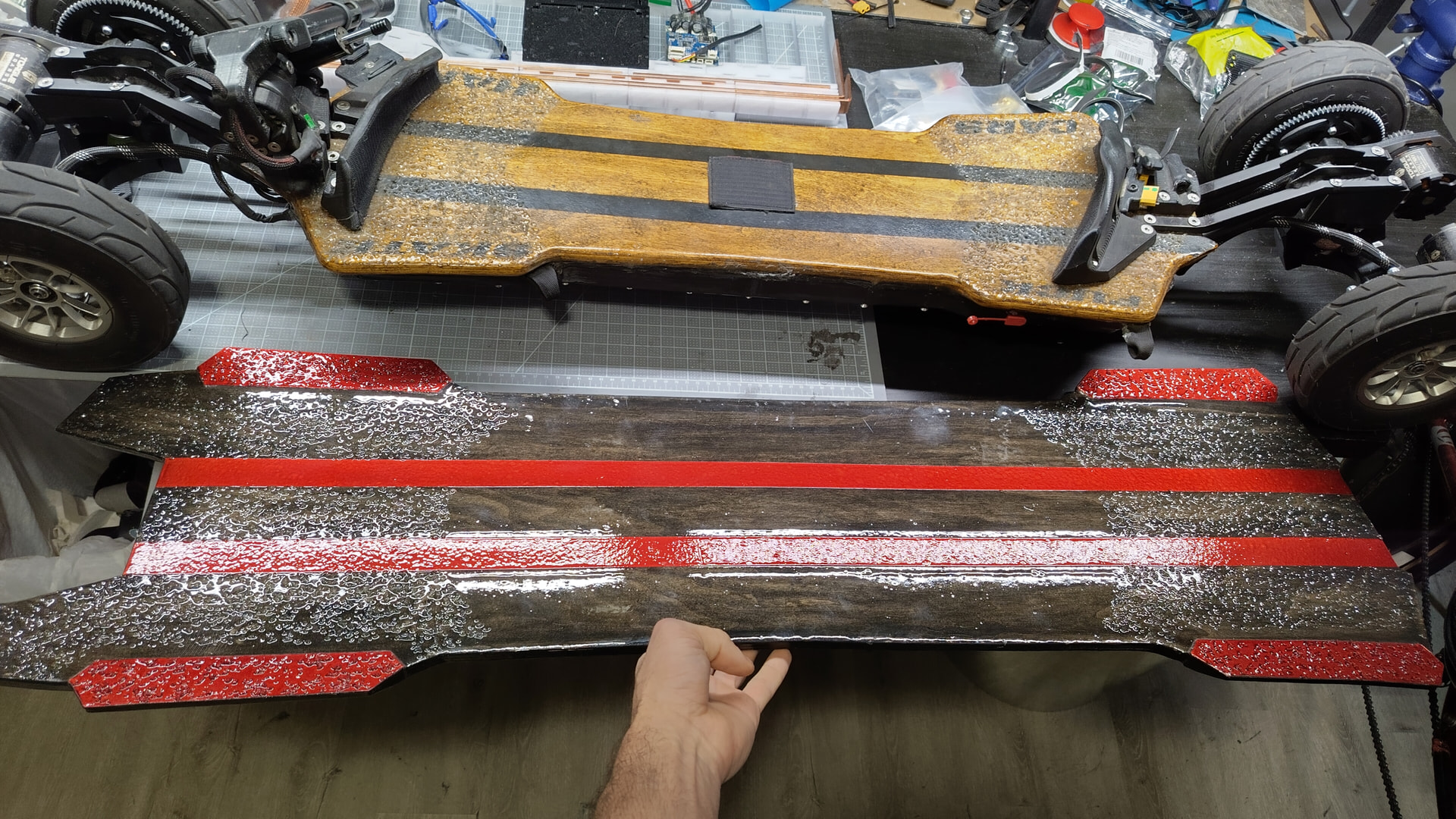

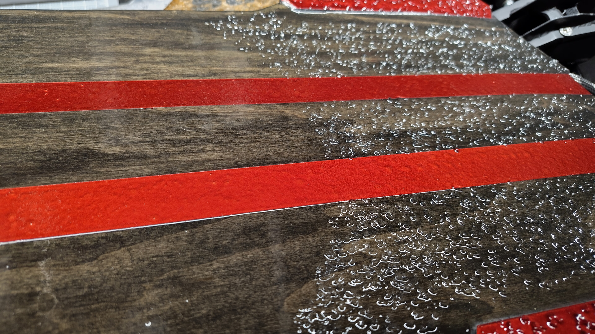

Point #5 just requires a long ass deck. Already done, and it’s 45", 11-ply maple, fiberglassed, 3D print winged, W-concaved, black stained, fritted, and schmexy:
The belly pan has been cut, but needs processing.

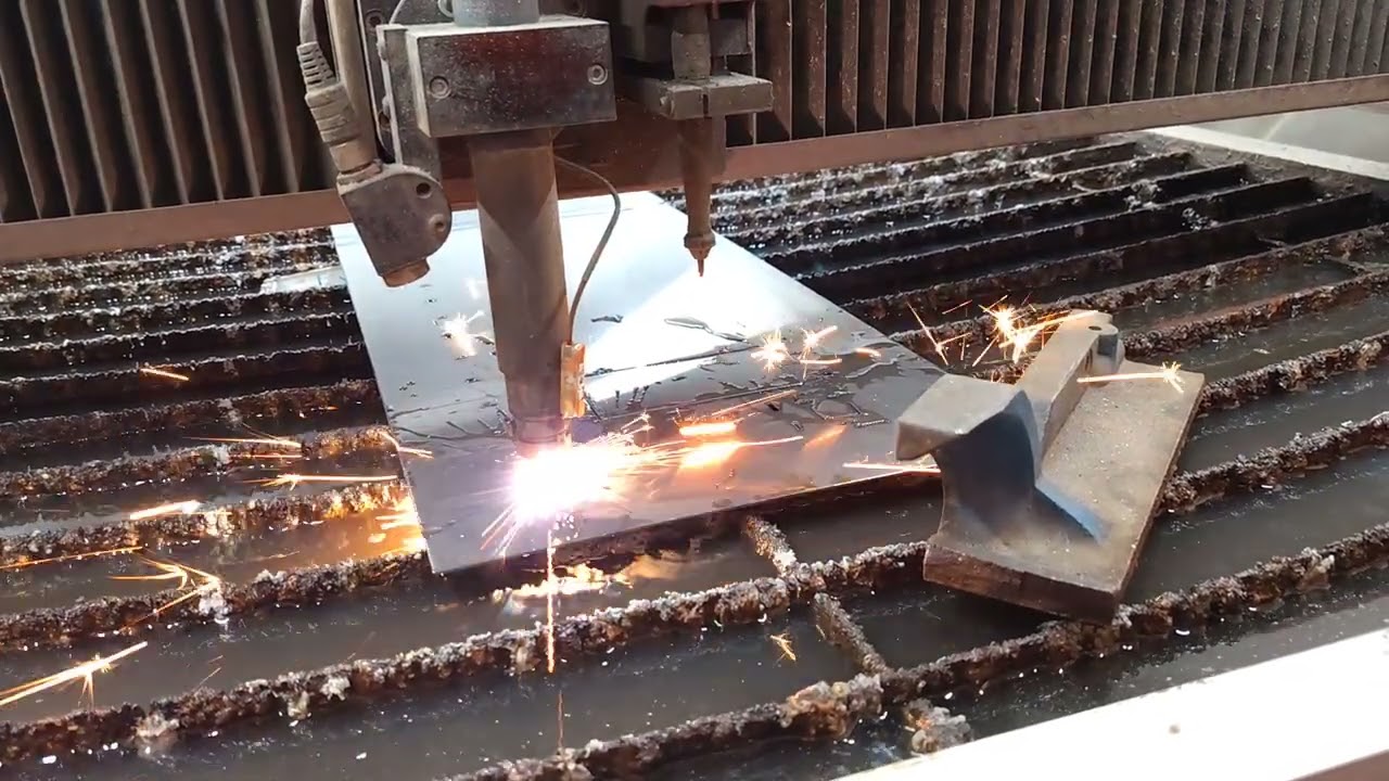

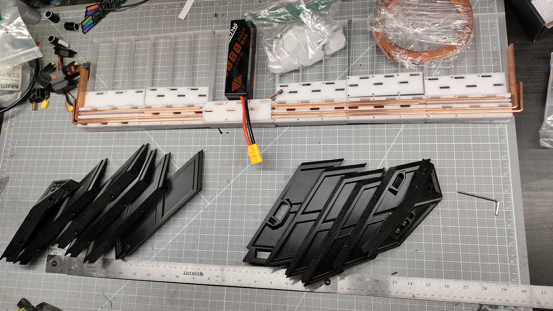

The goal is to finish the work in Fusion this week so I can order all the laser cut parts, since that’s the current order-of-operations bottleneck. The printed parts for the enclosure sidewalls, cable, and bus bar management are ready to go, but the brackets need to be welded to the belly pan and the frame needs to be painted before the enclosure work can start.

  • Tires: Bridgestone 10x4.5-5 wet compound
  • Wheels: DWT spun rims with @jack.luis kart adapters
