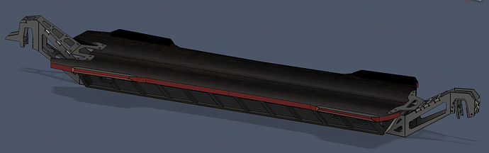

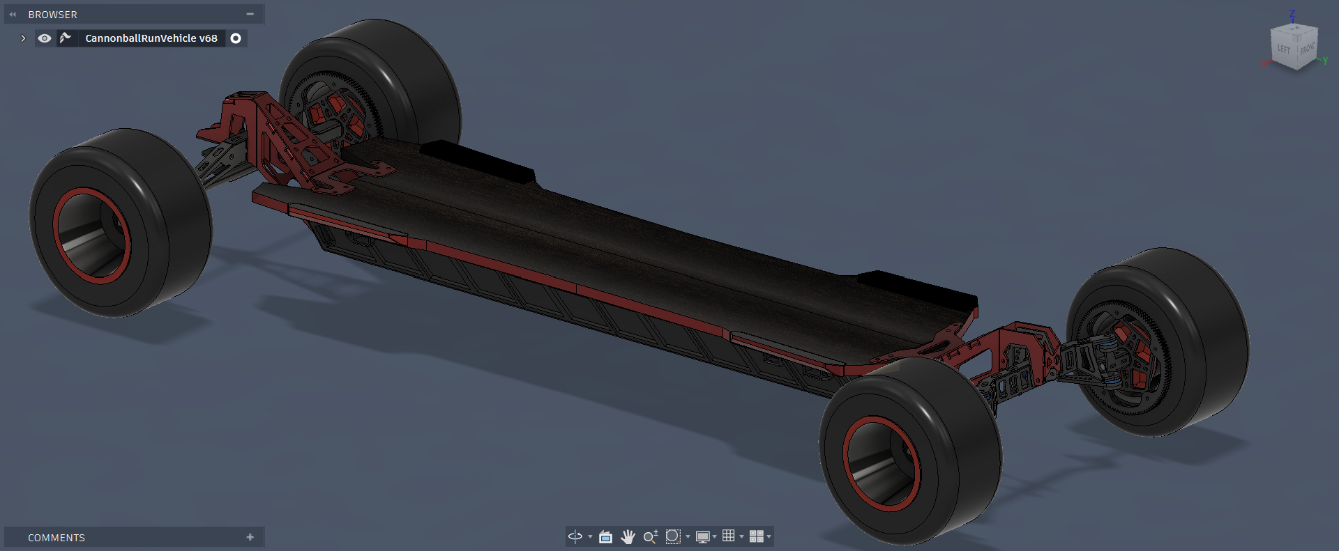

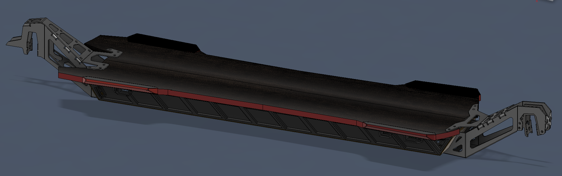

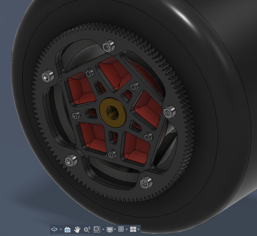

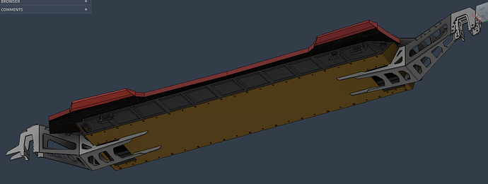

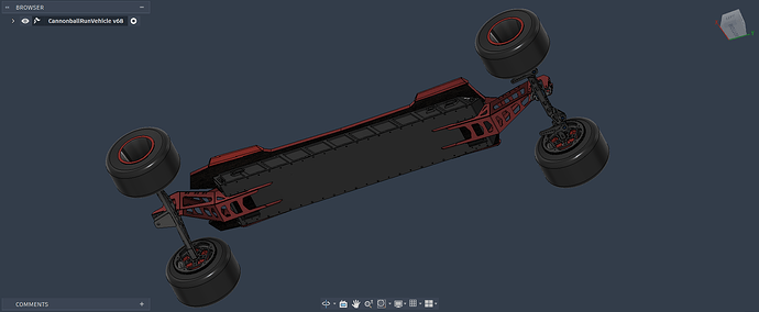

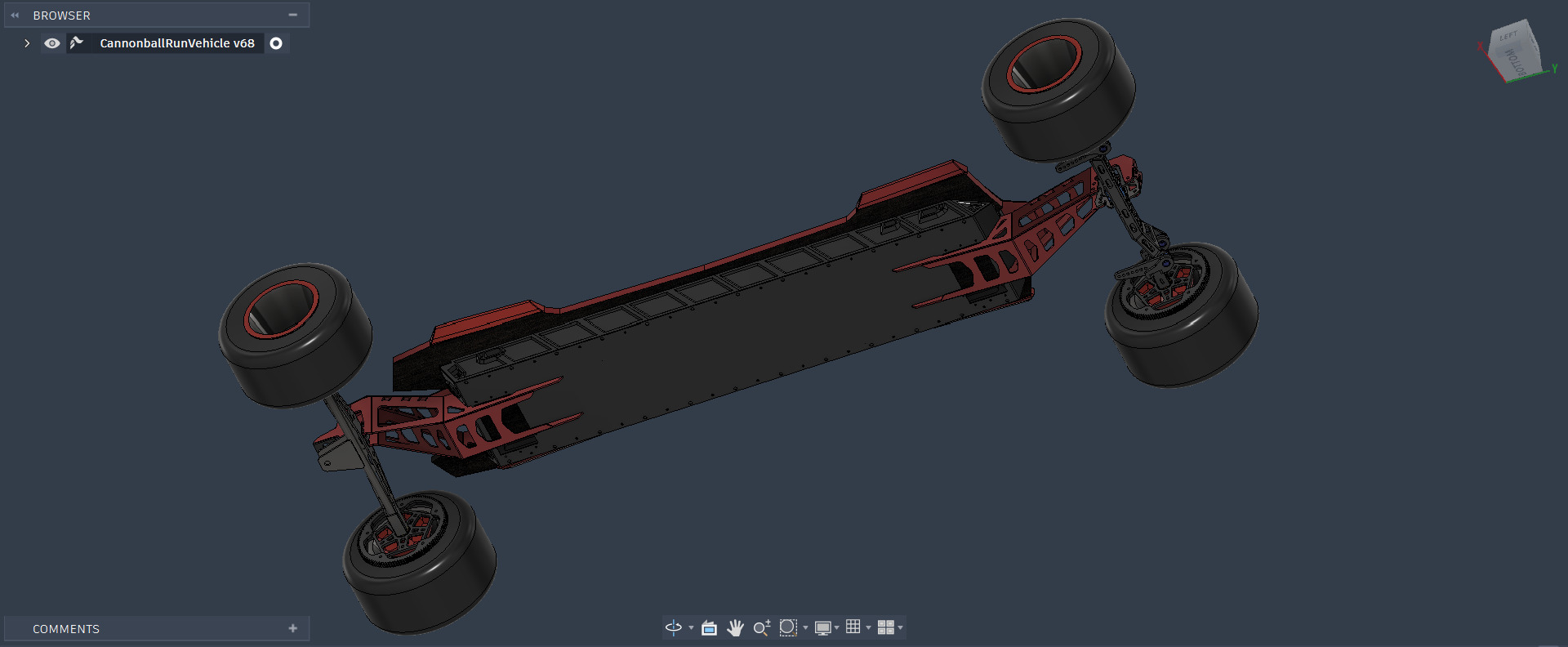

Spent a while on a work trip that wiped me out a little, but I’m back and finished modelling the extension brackets. I have a rough idea of how much material I need to order now. Next is to model the trucks and pull the trigger.

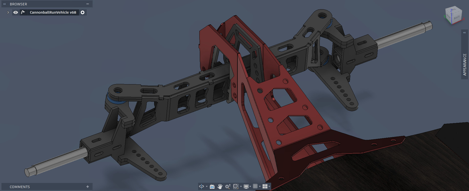

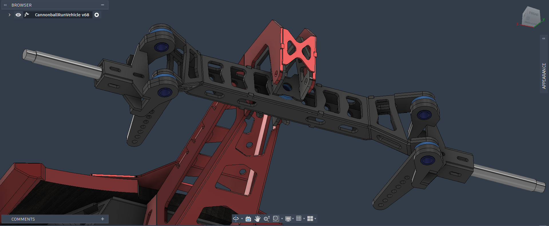

I’m also gonna order the gears at some point this week. They’ll be 2x 3/16" layers of hardened and tempered 4140, mod1.5 109T, fits MBS pattern and Jackson hubs specifically. The cost to me for a gear plus a 75-90mm CC motor mount is about $170 per set at QTY 4, but if someone else wants another set of 2 it goes down to about $160, if I end up ordering 10 it’s about $150 per. If anybody else is looking for a Big Wheel specific open gear setup and wants me to group buy these, HMU.

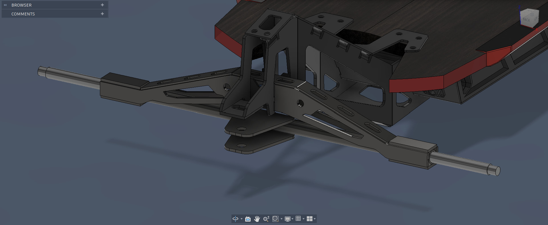

i have no experience with what you’re doing, just seeing the almost skeletal design makes me wonder if you are in any way concerned about it’s strength
If you don’t skeletonize a steel structure it’ll be heavy as balls. I’m trying to make it in a way that preserves lateral and torsional stiffness for good handling, but creates vertical compliance so the whole thing doesn’t snap when it hits a pothole.

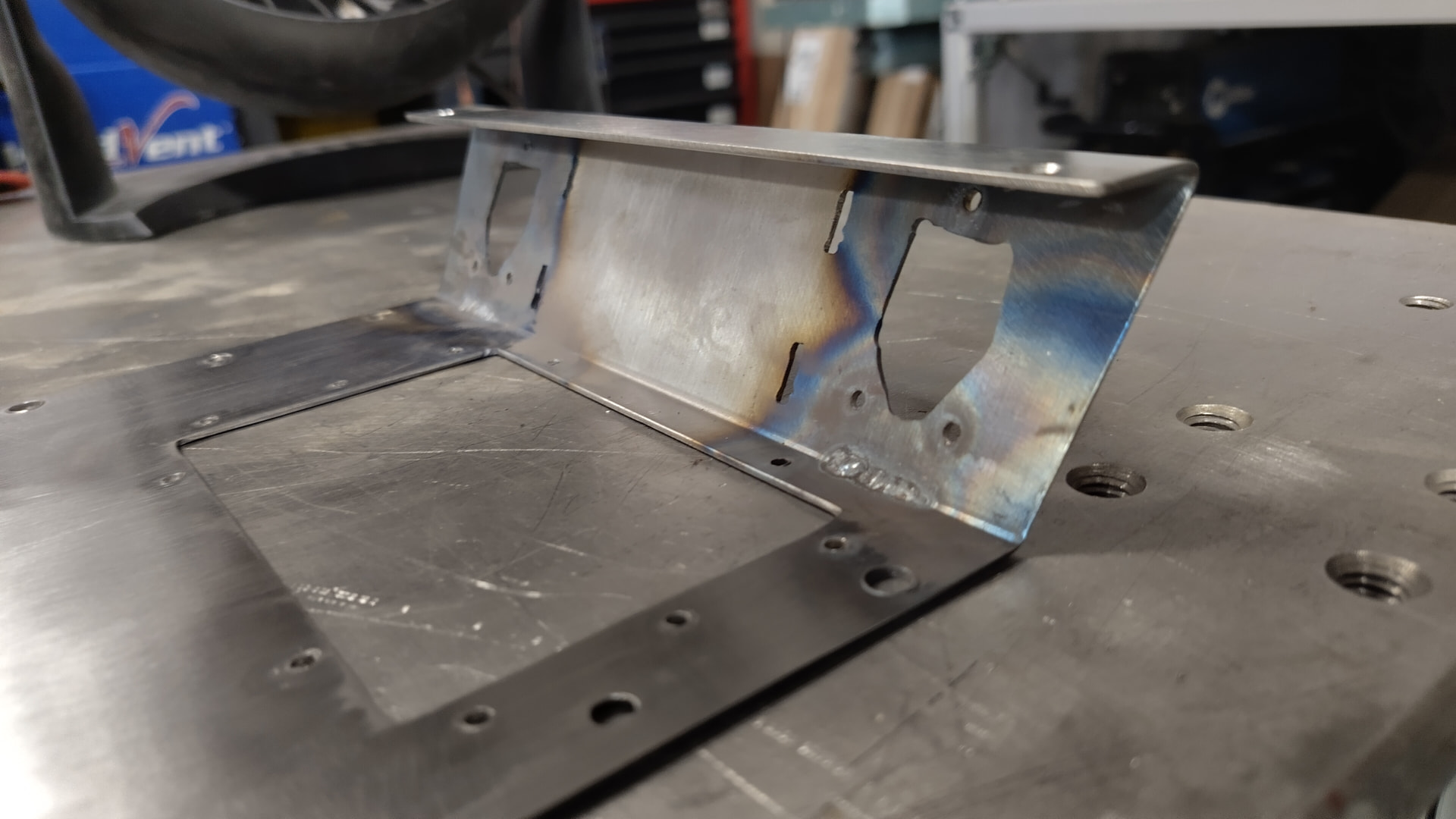

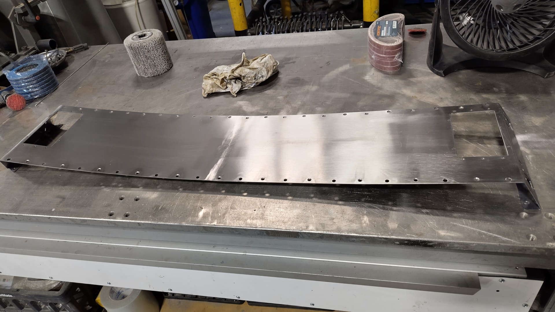

The tubes were drilled and reamed to 12mm to fit shoulder screws. Don’t worry, I’ll take the heads off those and cut threads on em
All the steel parts are ready for processing and welding, with the truck components being fixtured by the motor clamps, and everything else being bends, tabs, and slots
