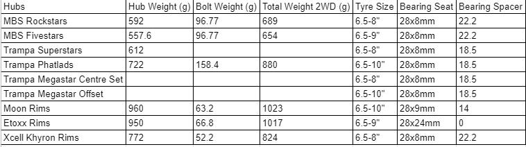

Thoughts on phatladz? I have seen some poor reviews regarding balance. But i lile the idea of them offering a megastar width with lower weight and price!
No mention of Phatladz here…are they a contender?
I have a set :slight_smile:
superstar / phatland / megastar
Whats on my gear drive boards? 3ds and mbs
And yes I test them without tires on.
On my belt drives though I run superstar. The weight saving is nice and its pretty
Not heard anything bad and the concept is nice. I have a pair of hubs here but not on a board
Good advice. Makes sense since the fastest a full trampa board can go is like 51km/hr, and that with picking every single part towards speed. Think they’re meant for the 30-40 top speed range where a wobble will be barely noticeable.
Do your hubs run 9 inch wheels as well? I may treat myself later on or even with the drives purchase since i can’t really go wrong with good tolerance cnc parts
Edit: seen the pic, they do
6.5-10"

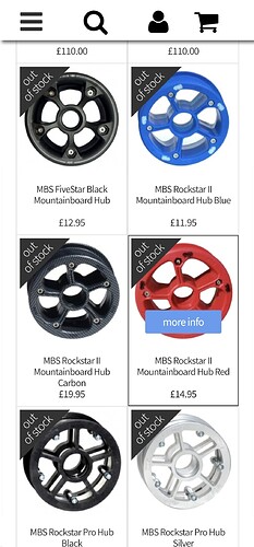

Fivestars for forever. Cheap, solid, light, takes tires from 5.5-9" just fine and dyeable. Come in black now too.
You bought it all didn’t you

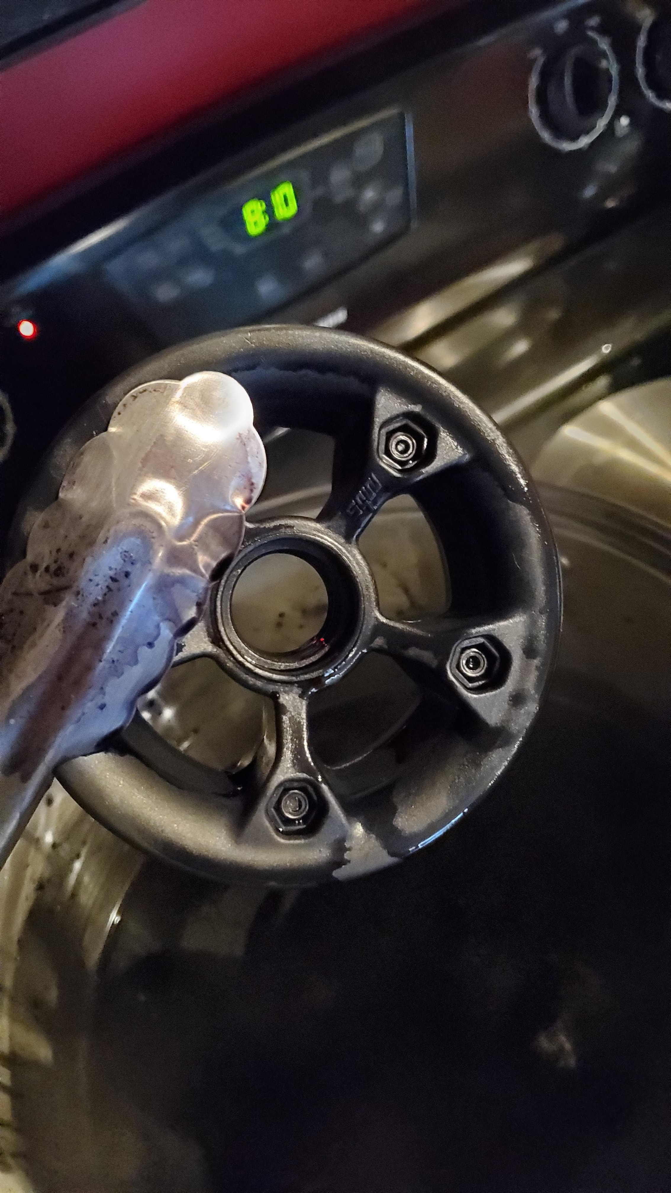

You can dye the white ones.
Bonus, you don’t have the white writing on the rim.

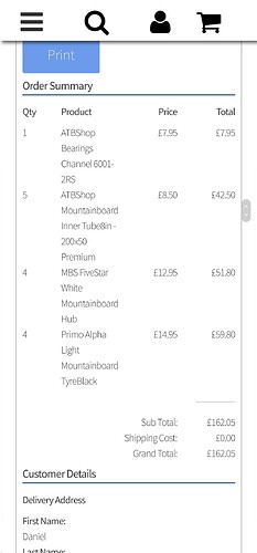

Oops, i clicked place order. Mine now.
