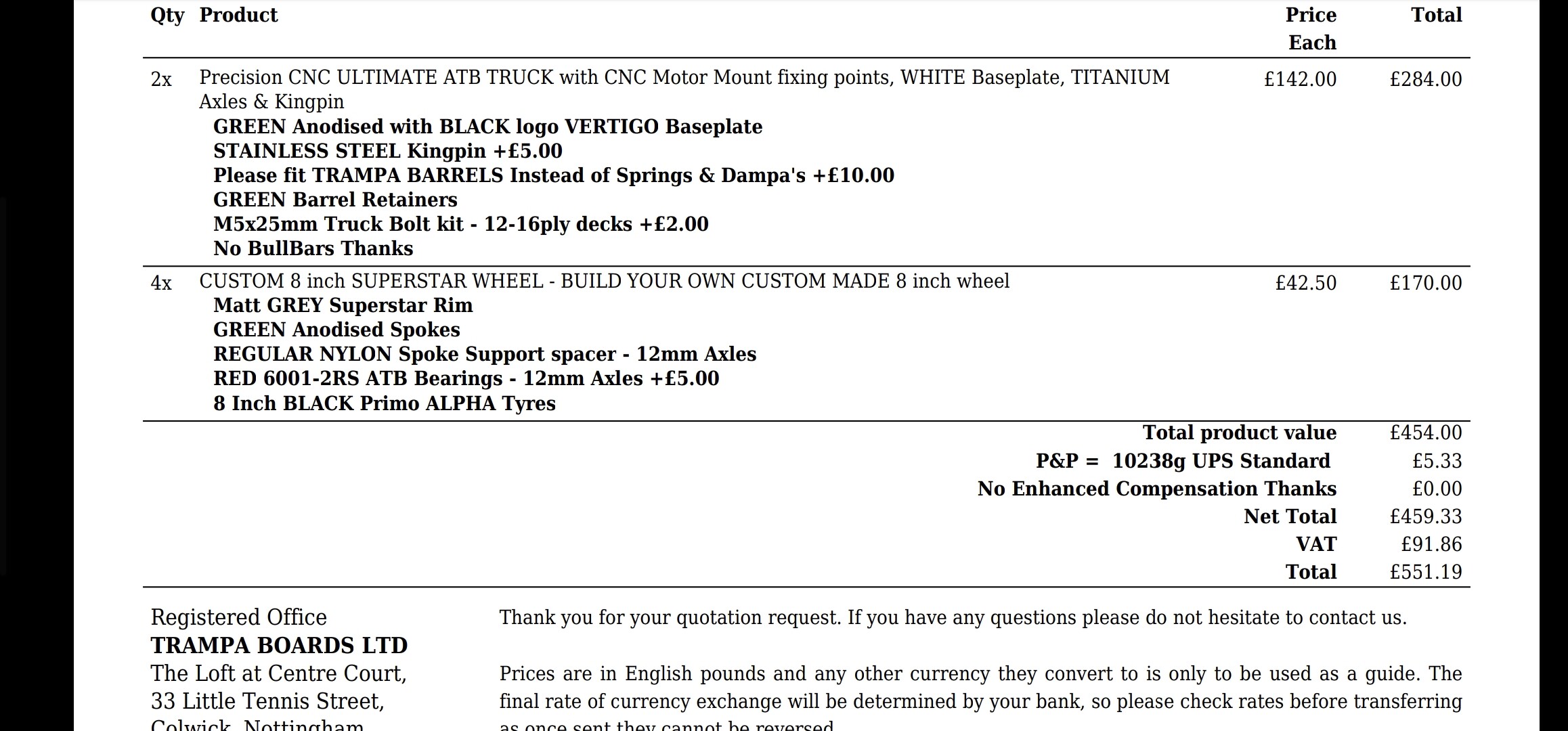

Yeah, i looked around everything now, the only complete set is at 900€ or £780 for complete trucks, geardrives and proprietary rims. Not really impressed to be honest.
Here’s what i get from trampa, assuming there are 0 parts that i can source second hand in the meantime
Trucks and complete wheels.
Add moon’s £260 drives and i’m only slightly more expensive than 3ds stuff, but with some tyres, tubes and nice colours to personalise my board a bit before it all turns into a nice mud coating
I need to mention that 3ds stuff is before tax and duties paid. That will bring the total close to or over £1000
Trampa’s stuff i specificatlly asked for a quote to get the tax in the total

They may be better, haven’t tried them can’t speak about this, but for £1000 i’m getting hypertrucks and moon drives if i really, really want fancy
