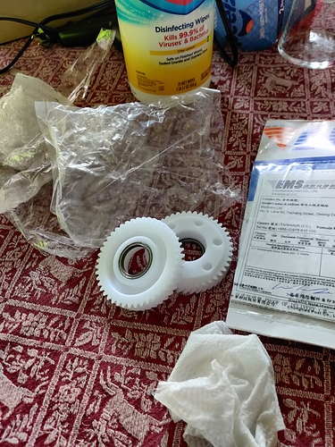

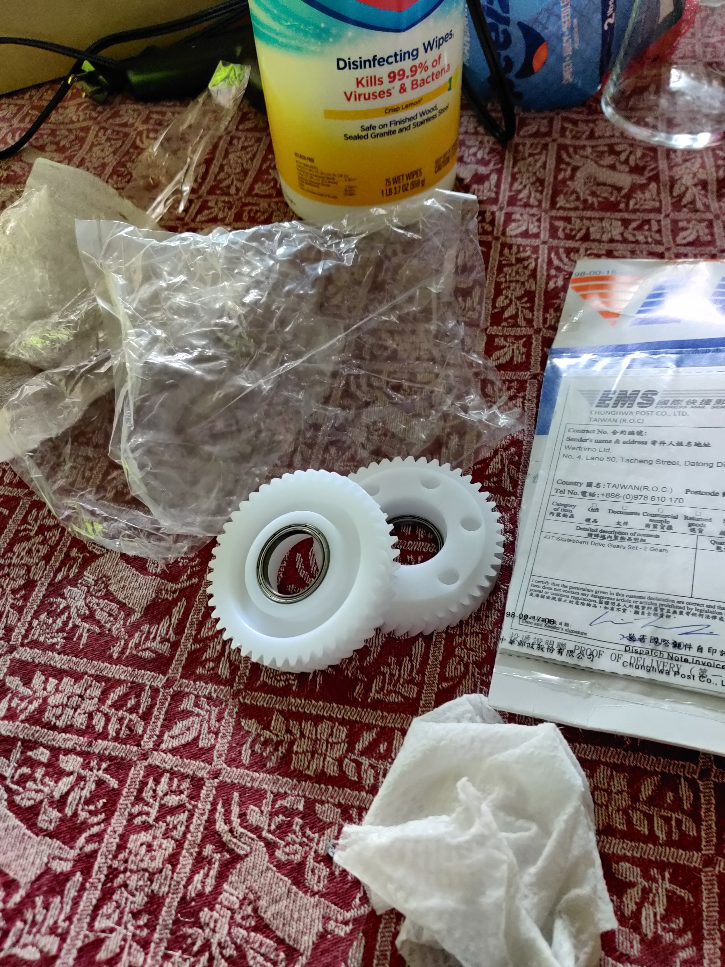

The package arrived here within two days after it got sent, everything was really well wrapped and organized!
Awesome experience buying from you and Timo, looking forward to assemble your drives and go out!
Thank you !
Thank you @haggyboard.timo! He replaced the broken gear for free! I also bought another new one ao that I can make sure that I am running 2 fresh, non-abused gears. Super fast shipping and excellent service, as always! So excited to get riding again, none of my other boards are exciting after riding this build :rofl:
