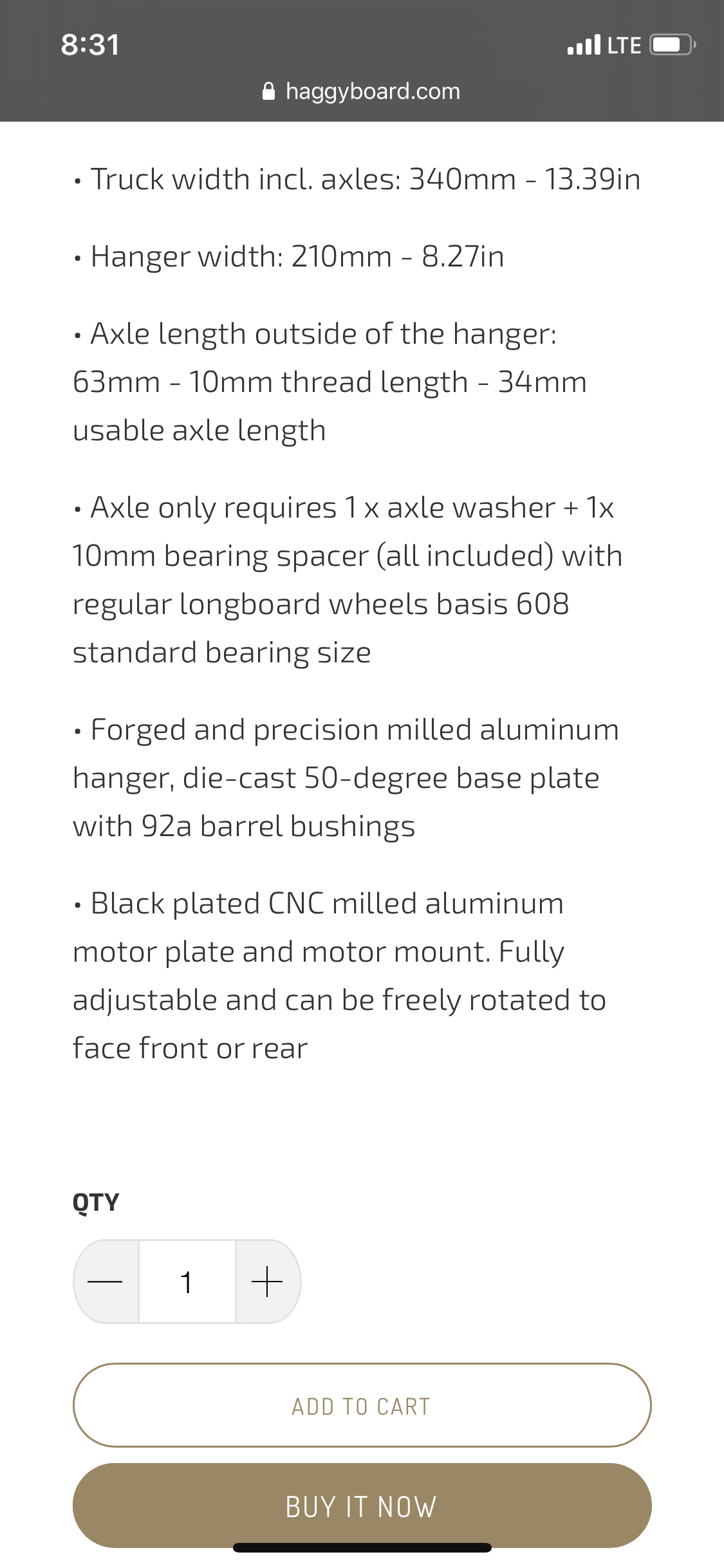

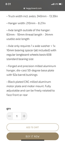

@KfromtheBay i saw that thats where Im confused…
@avX i just wanted to the know the “true” width.The Kahua i assume are about 260mm give or take?

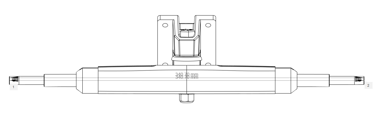

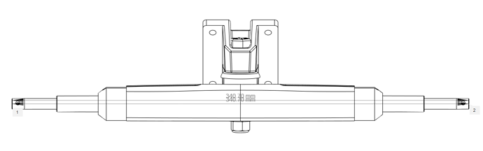

true width is 340mm as stated in the website (:
My mistake. I meant like a standard measurement compared to other trucks. Okay, i get it now the width is 272mm. That’s pretty wide

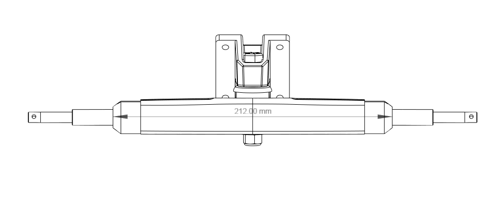

Uhm the width of the hanger itself is 212mm.

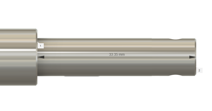

I guess what he means is wheel to wheel distance compared to other trucks. In this case the wheel starts at the halfway point of the axle, after the 12mm step down. It’s wide definitely. Another truck that is of similar width would be the Evolve supercarve.
Yeah, thats what i meant. Ty
