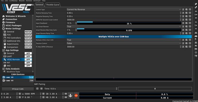

I have been running this with no problem for the last 3 years. All the sudden, I installed the new VESC tool and upgrade the firmware to 6.02. Now my VX2 remote does successfully pair. But I get no motor response.
Check the app, its on UART, Played with “current and current no reverse”. Still nothing. Also checked the wiring of the receiver. Some say the orange and green wire is reversed. Tried switching that. Nothing. Has anybody encountered an issue like this? It was all working until I changed to the newest VESC tool and the newest 6.02 Firmware. Very frustrating :sob:
This is unlikely to be anything physical, just sounds like firmware. Are you seeing current and current no reverse in the vesc remote tab? That’s where uart remote settings are. Screenshots of vesc tool and pictures of your setup will be helpful too
Here are pics of my setup. I am working on a DeWalt powered mountain board that uses 6 batteries. I am currently working on custom building each battery with Molicel 42A’s. Hence 10s6p. Here are some screen shots. Thanks for your help in advance. I have no idea what went wrong.

Are you certain you’ve enabled UART on the correct vesc channel? If you connect with a BLE dongle over Bluetooth, it will always be the other channel on canbus that the remote is connected to.
under “vesc remote” you’ll need to make sure that control type is selected to current. It took me a while to realise that “vesc remote” is where the throttle curve is tuned from with this remote.

What I believe Tim is saying is that if you connected to a VESC (we’ll call it ESC 1) using a BT dongle, then ESC 1’s UART port must be occupied by the dongle. Therefore ESC 2 must be the one with the VX2 receiver. In that case, when you connect by BT, the ESC that shows as local will be ESC 1, and you should set the control settings on ESC 2. But in your screenshots you’re connected by USB anyway so this looks like it’s not a concern.

The USB port may not be significant to be honest, you can access settings for the other VESC over CAN. Basically it’s not that you need to apply settings directly to the main ESC, you just need to identify correctly which ESC is which

Tim, Mr Shiteside, It’s all good! I understand what you are saying now. You were right. I did not identify the correct vesc channel for the port. I don’t know if this is what your are saying but looking at Tim’s diagram of the vesc. I just matched up Comm1 to the USB 1. I must made sure that I was UART was selected on the correct vesc and also “current” and it worked. Argh!!! Thank you so much the both of you to help on this. I have been baffled for the last 5 days. I would like to post another day on just settings tutorial as I am still learning all these parameters. Is there a detailed description somewhere on setting the nitty gritty such as erpm, brake regen, current max? I have a decent understanding but would like to learn more.
