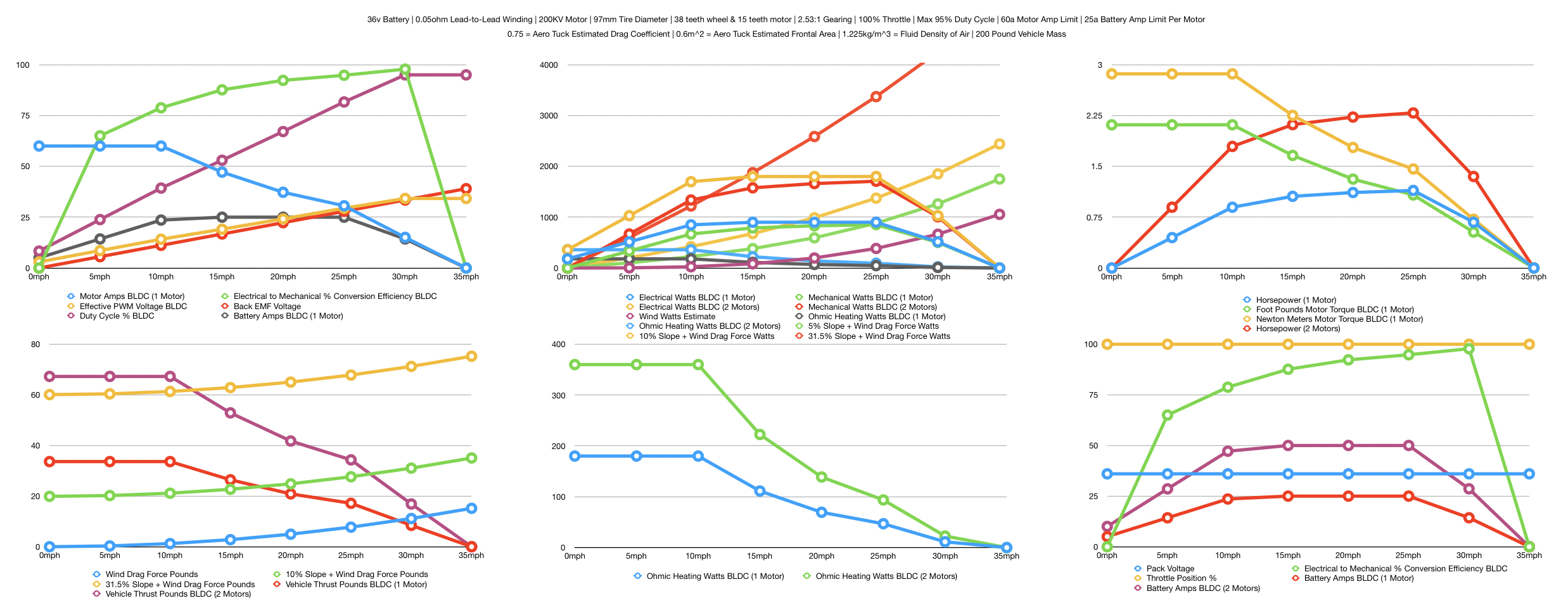

^from the bottom left chart it looks like with 25a bat, 60a motor, you can do about 31mph on the flats and 26mph on a 10% slope. above 10mph on a hill you could easily draw 50a battery amps.
or It could be the low volt cutoff setting on the esc.

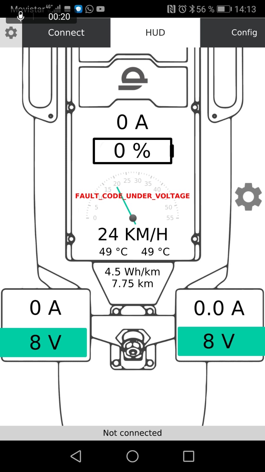

After trying the new limits and capturing the Focbox HUD screen, this is what I see
The battery has a terrible sag. Start at 70% up the slope and down to 17%. In plain it gets to 50% again, I go back up again and the battery indicator goes down to 15%, then I get an undervoltage error and it stops. All this in 5 minutes.
It look like broken cells, but they are new. The truth is that it happens since the board took a strong blow, the blow may have broken something?
