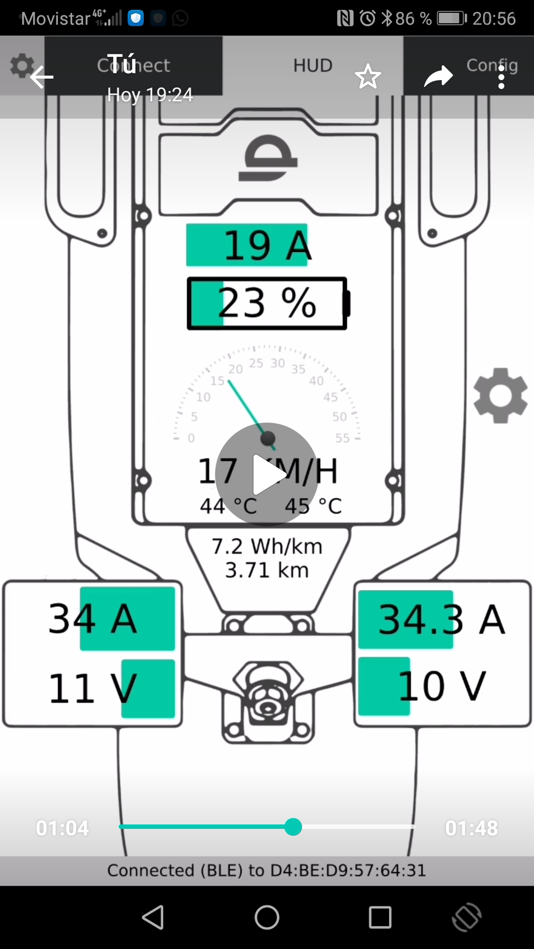

the thing is that I wasn’t drawing so many amps. more or less like in this photo.
With the Evolve gtr a friend climbs the same slopes with me without problem. the batteries are similar 10s4p both.
does the evolve have a lower battery current limit per motor?
I dont know what the Evolve maxs are, is a commercial GTR…

i assume a commercial board with 50v battery & 2 motors in the US is limited to 20a bat per motor for 1000w total
