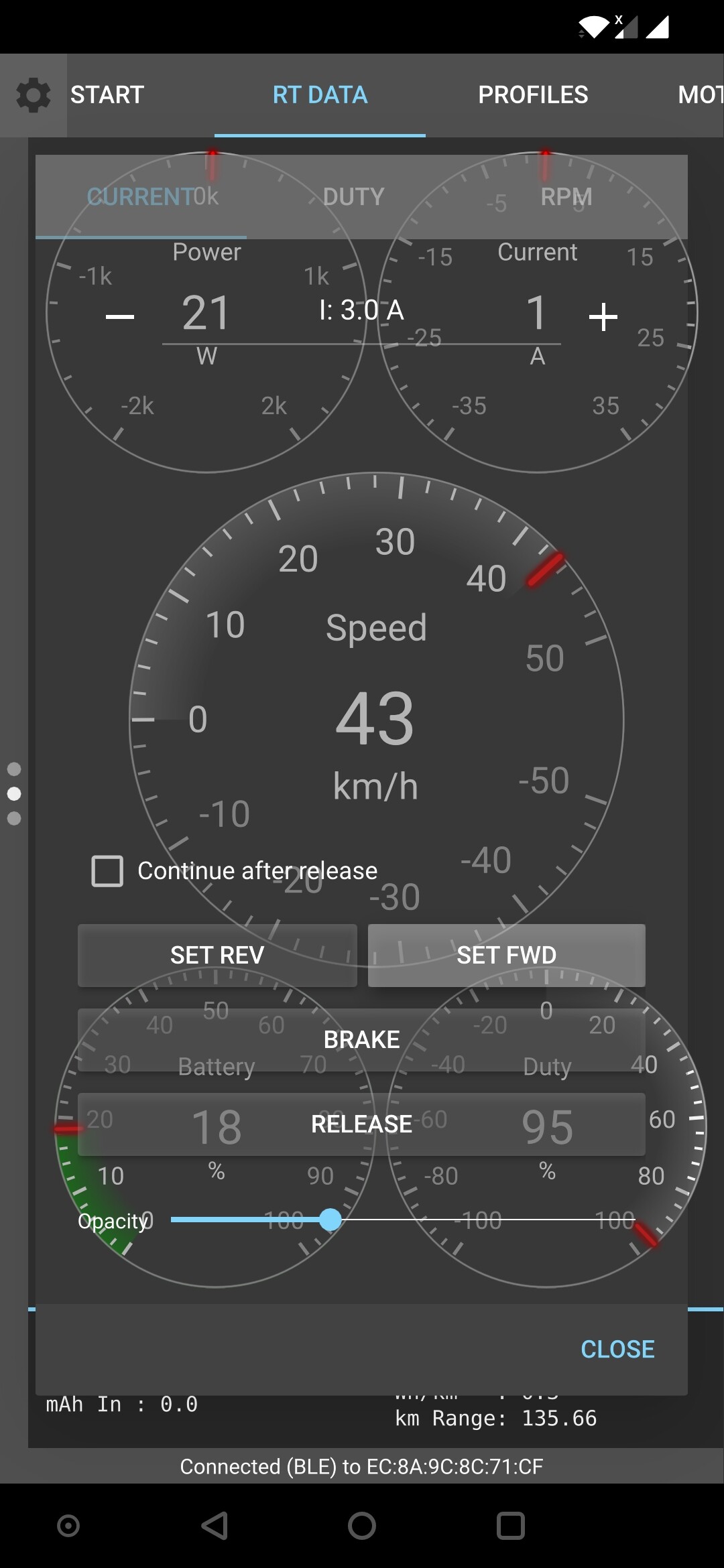

You can use the control tab, set opacity lower, go to live tab and make it accelerate to see if it’s still happening with no remote in. 5A will likely be enough to bring it to 95% duty cycle
did already. Went snooth on both occasions (dccls 0.85 and 1)
Use current. Duty controls duty, current goes as fast as the vesc can go and the remote is almost certainly on current control

Same as with duty, goes to max speed (43km/h) without any sounds
