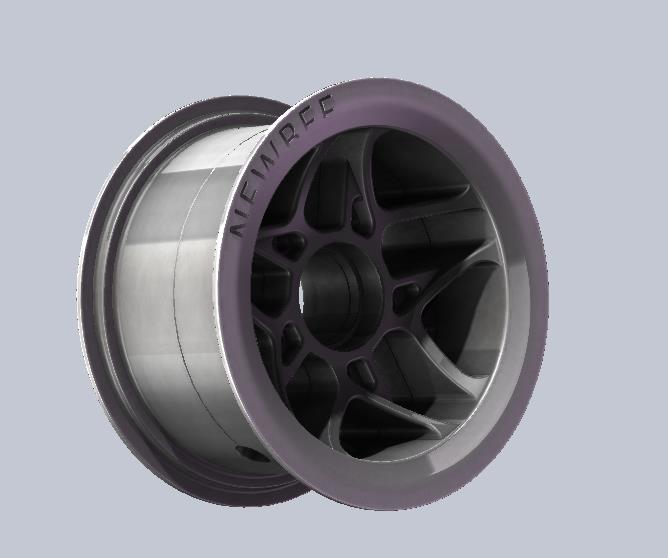

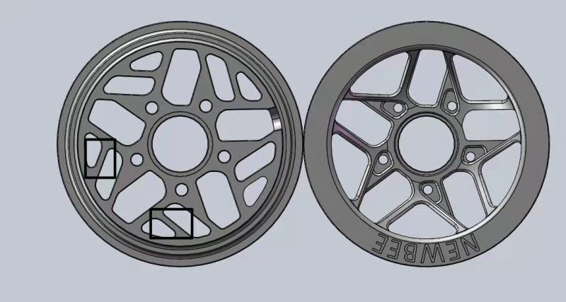

The hubs are sexy too. How much do they weigh? They look meaty.
I am interested on using the idea for a Summerboard gear drive upgrade where additional spacing is needed. It is that or using BN gears and flipping the motor.
After riding it miles and more test riders ride it, time will prove this structure is reliable and durable. Also for the weights, after use pom wheel gear next, it basically not much difference between 4GS ad traditional one.
For the hubs, 400 gram per hub, the next version will under that.

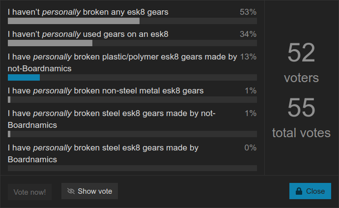

Screenshot from 2021-04-26 23-35-37
What deductions can we make from this?
  1. Gear drives have been known to break
  2. 6-8 of the people who knew about this poll and who have owned gear drives and who were inclined to respond have experienced broken gear drives(?)
    This one is tricky because it’s a multiple choice poll. One or more of the voters might’ve broken lots of kinds of gear drives.
What we don’t know from this is what causes GDs to break. Could be cos they were in dev/test or because they (consistently) failed to assemble their gear drive(s) properly, or because the GDs just weren’t durable enough. There are probably other explanations as well.
Whatever the stats and the reasons, I think we can probably conclude that, if you’re setting out to hammer the shit out of your board and you want a GD that can withstand that abuse, this is the GD you should be thinking about.
