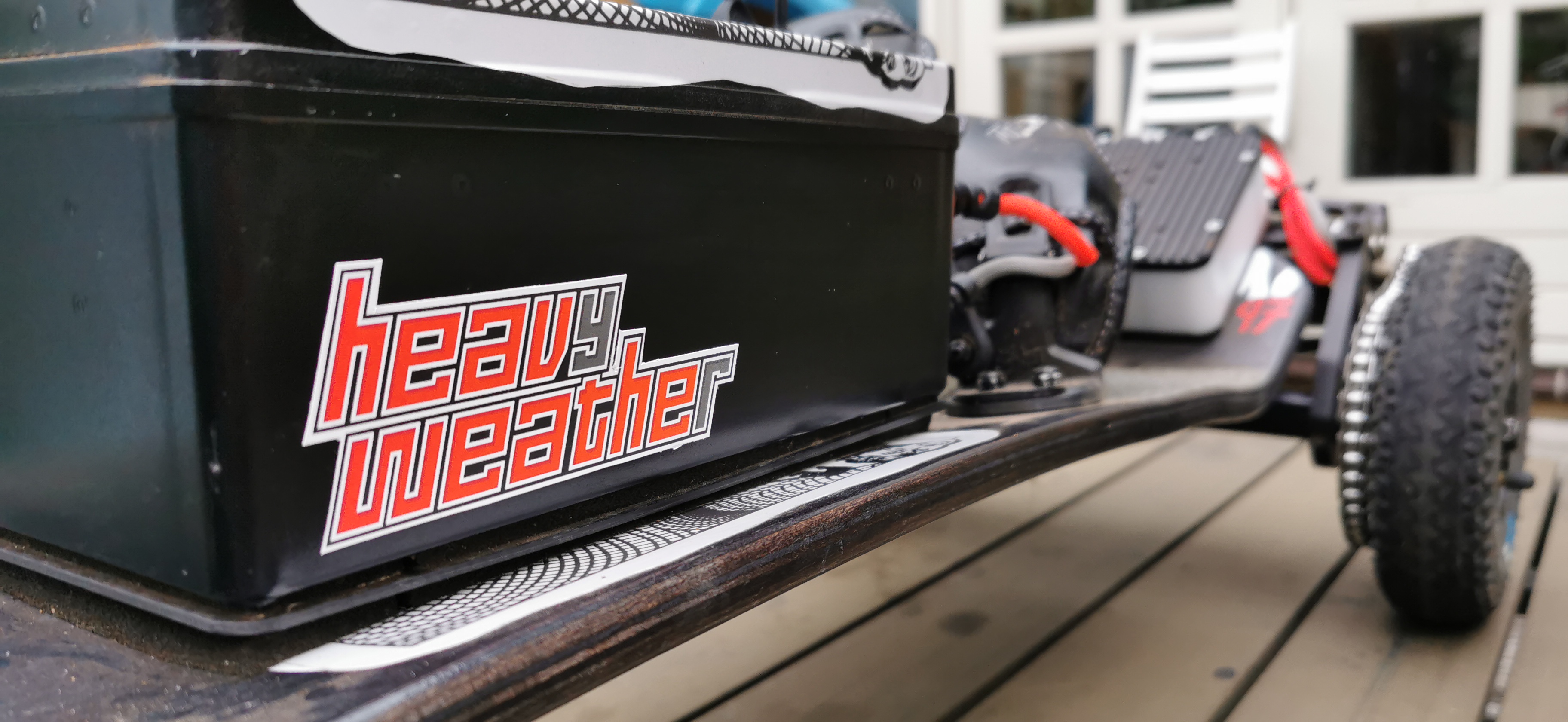

I measured out a pattern, stuck it to a 2mm sheet of carbon fibre and drilled out holes to attach to the deck (the four in the middle) and the enclosure (at each corner).
Then used the same pattern to drill pilot holes in the deck for the threaded inserts.
I found fitting the threaded inserts really tricky. Once the outer thread bites into the wood, the insert finds its own orientation which tends to be quite a few degrees off perpendicular. Maybe it’s for the want of better tools, I dunno, but it required a lot of fiddling with and the best I could get wasn’t as true as I would’ve preferred, but for a close and shallow fastening, it doesn’t matter so much. If the fastening was over a longer distance (i.e. a thicker cf/rubber combo), it would’ve been a right old mess. I’d appreciate some tips on this for future reference.
Took that second sticker, cut and trimmed the edges to correct the orientation of the exposed artwork.
Fixed some foam rubber on either side of the cf plate and fitted everything together.
This was my first experience working with cf and I was really happy with it. It’s pretty expensive (I paid €40 for a 350x150x2mm plate) but it’s perfect for the application here. The 2mm thickness is surprisingly lightweight but reassuringly strong and it has just the right amount of flex to accommodate the movement of the deck and the damping of the enclosure. It’s also a pleasure to work with. Drilling, sawing, sanding etc is all as easy as with a good quality hardwood.
I’ve got a few small aesthetic things to finish up but, to all intents and purposes, it’s all done bar the riding. I love the noise this thing makes. It’s a nutter!
