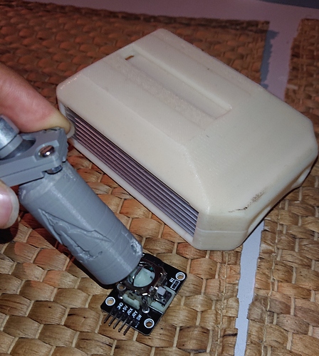

Forget about the thing in front, the white box with dual side heatsinks? It was sized for bare ESCapes but not really e-board related (for a board it can be made smaller and boxier)
Eventually for a MTB with top mount
taking that plate out is invasive, and will be a pain. deferred a bit.
