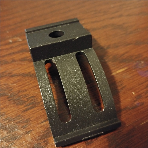

Headlight bracket failure. How to improve?
Out of all the various board moujted headlights these are by far my favorite model/option, unfortunately road vibration always wins. I feel like the brackets got worse in qc
Ive tried reinforcing the break.point ahead of time by using some jb weld to glue a strip pf aluminum over the front and back point which only slows the ineveitable…
Any hacks for this part? Short of trying to bend a piece of flat steel strip…

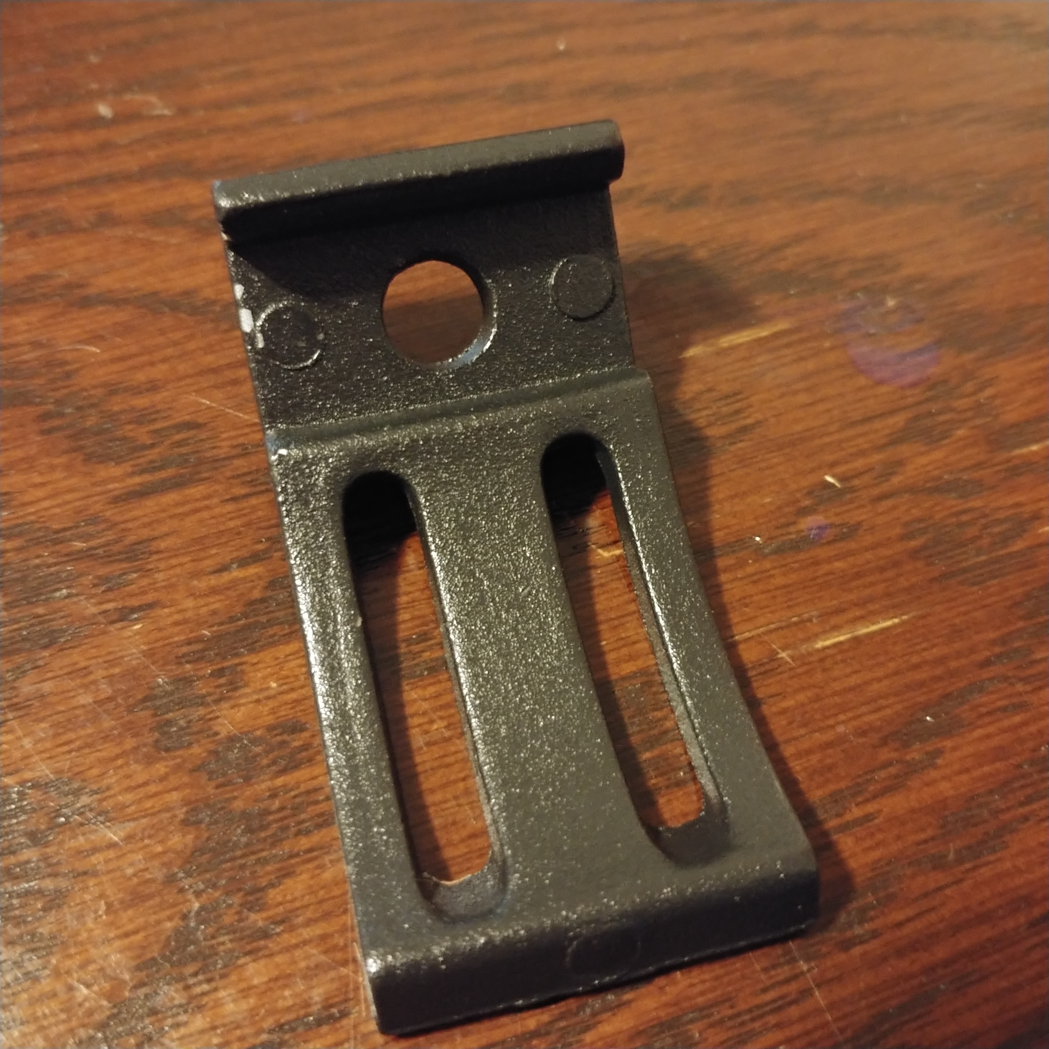

Can you show a better picture, as how it was when whole?
Yeah kinda need a little bit more visual info to offer help. Did you try figuring out any kind dampening for it?
I think some rubber beneath the mount would help dampen some of the sharp vibrations
I bought a bag of these fuckers but that’s not a perm. Solution obviously lol
That’s a shitty bracket design, has this step right where it suppose to bend…

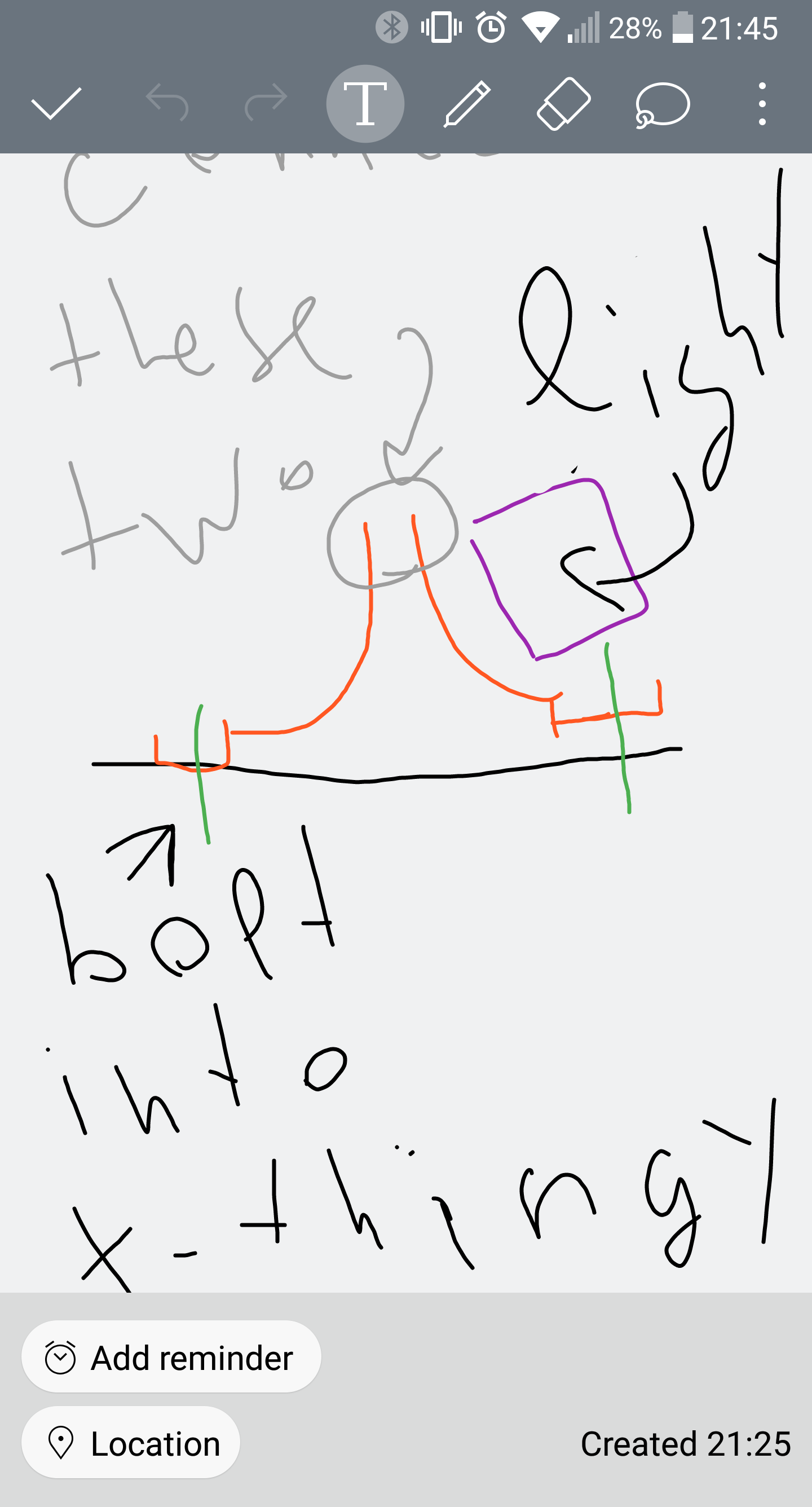

If you have a bunch of those try this:
Should support the bend. Make sure these two are connected good.
You can probably design a 3d printed bracket better than this
For real. A properly designed mount, printed in TPU would probably last forever.
