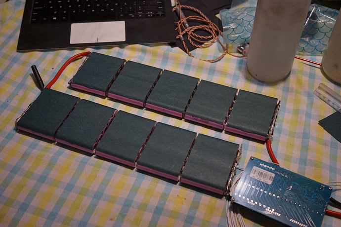

Building the Battery
Because of the limited space in the Haya, I had to get creative with the battery. The original plan was to use PCBs above the p-groups and cell level fusing, but at just 5p I decided against it in the end, and there is pretty much 0 room in the enclosure for any serious wiring above the cells. After scrolling through other builds, I discovered that everyone with Hayas either route the wires on the side, or increased the enclosure height by adding additional layers to the deck, which I would never do.
Because of that, The only way to fit all the cells into the deck was by doing this:
That’s right – the cells are welded with nickel, and then folded! This required a creative welding setup, because I couldn’t just weld the 5 groups together and then unfold them – I needed the folds to all be in the same direction, so that I could solder the balance wires afterwards. Welding nickel while the pack is laying on the ground was also unfeasible, because I couldn’t apply pressure to the nickel and cells to make a proper weld.
Introducing – the hanging dong approach:
I cut up a small book, and used its hard covers as a surface to hold the cells, while the connected tail went through a hole in the middle of this bench. The welding process itself took only 3 days – 1 to add all the fishpaper rings and glue the cells together with silicon, 1 to cut up all the nickel, trim its corners, flatten it with a kitchen hammer, and clean it with isopropyl alcohol, and then a day to weld everything. I would do 10 welds, 1 on each cell for the adjacent groups, and then clean the welder tips with sandpaper, to ensure consistency.
After that came the wiring. At first I tried to see if I could solder a wire directly to a nickel strip connecting the whole group without heating up the cells, but the heat definitely transfers at that distance, so I don’t recommend doing it.
All the other connections I did by again having 5 nickel strips folding, and soldering to the end of them. That way the cells did not heat up at all.
Next came the balance wires. Because the cells of each p-group aren’t electrically parallel (no nickel connecting them), I had to make sure my balance wires touched each cell of a group to keep them at the same voltage. This took days.
Because of the limited space, I couldn’t add anything to the sides of the pack, so fishpaper is only above and below. I covered the nickel connections with kapton tape, and then packing tape. This way you can visually see if any of the connections happens to break.
