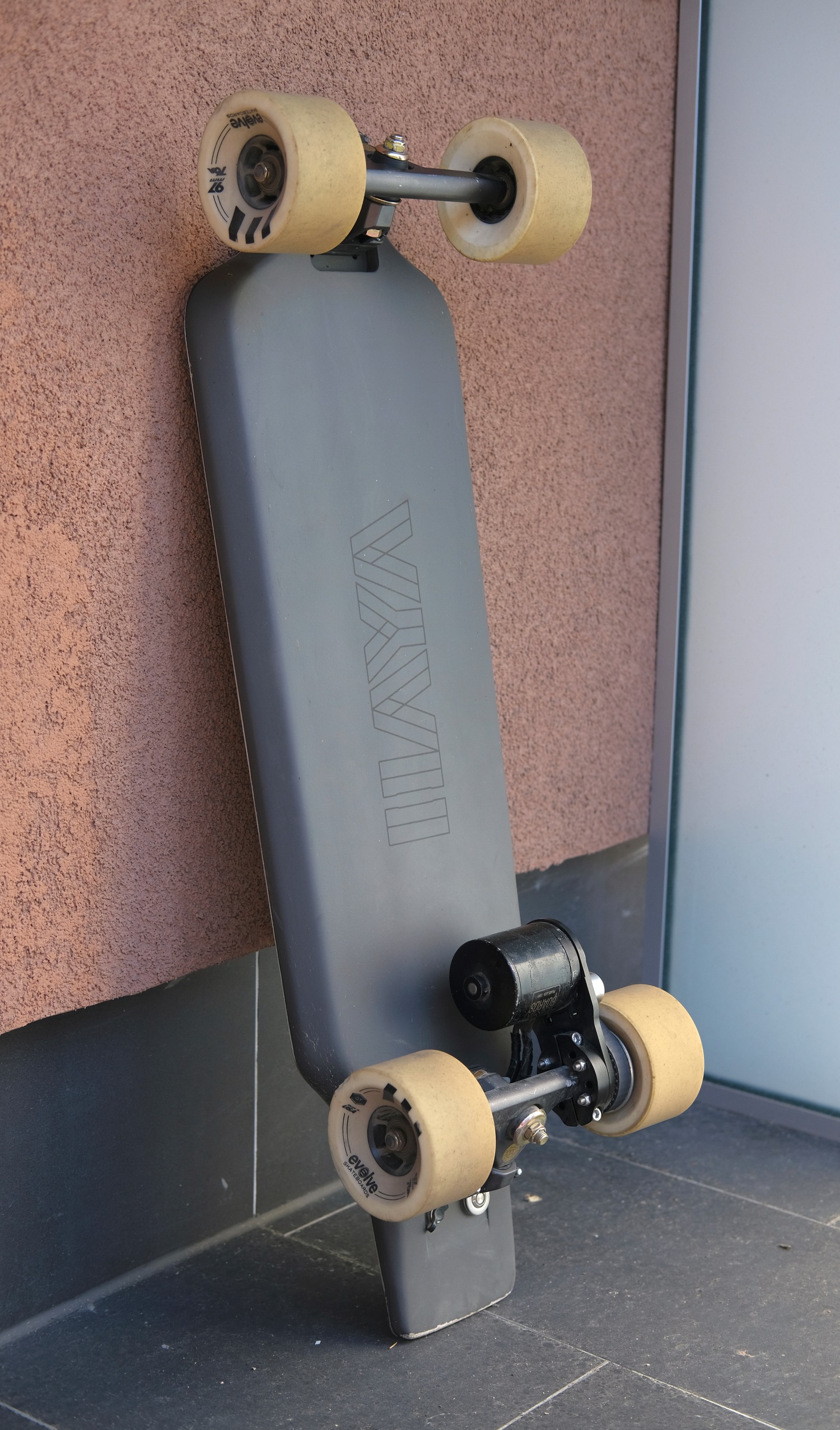

Update! Build is done! :smiley:
Click here to read the full update. It's also in the first post.
I flew back to LV this week to finish the board. 1st thing I did was replace the BMS for one of the waterproof charge-only Chinese ones. Luckily the same balance lead connector fit, so I didn’t have to do much resoldering. I also swapped the soldered-in fuse with one of those plastic in-line fuse holders. This allows the fuse to be easily replaced in case of a faulty charger.
Then, instead of using the BMS e-switch, I put in a Flipsky smart anti-spark push-to-start switch. They actually use the same exact button as I had already epoxied in (also 5V), so all I had to do was resolder the wires :slight_smile: The push to start functionality is pretty janky I think; you kinda have to push it fast, and then stop it, for it to trigger. Having a button therefore is nice.

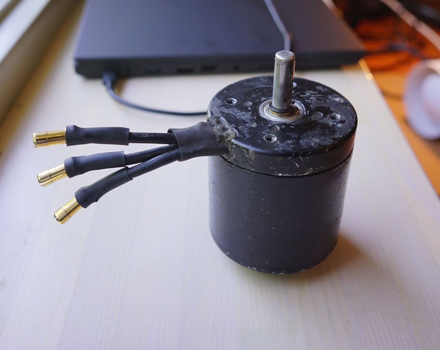

Finally, I was going to replace the motor mount with one from Whooshboards, but sadly I did not have the correct sized belt for that. (However, damn, that mount is awesome. So easy to assemble, highly recommend.) Luckily, I got new idlers in the mail from @Boardnamics that fit behind the wheel, allowing you to use whatever sized wheels you want. That + a 15T pulley, and having the belt a bit tighter than I’d like, eliminated any belt skipping.
I put the lid on, went for a test ride, and noticed that the battery cells must be jumping up and down on rough roads, so afterwards I put a layer of foam under the battery, and the lid still fit on :slight_smile: Here are the final pictures:
I also experimented with HFI, but it was always worse than running just in unsensored mode, so I stuck to that. Overall, I’m very happy with how this board turned out. While building I had my doubts if a short board so high from the ground would feel good, but it actually rides really well :smiley: The kicktail has so much clearance that you can easily do turns without scraping it against the ground.

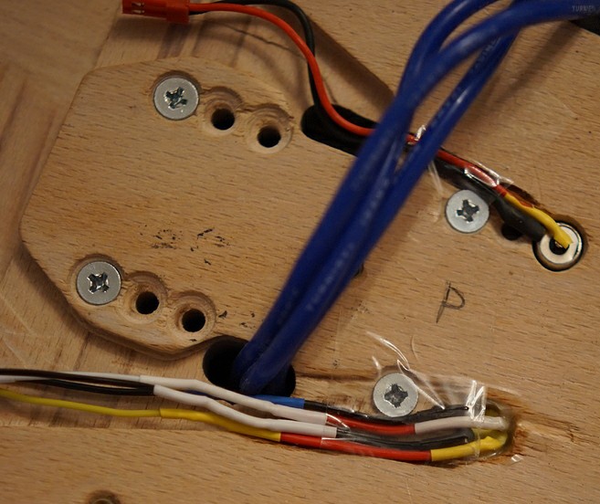

BRRUUH WHAT THE FUCK ARE THOSE TRUCK SCREWS LMAO
I thought he used 3 Phillips and a square… Nope. Just Phillips being Phillips.
@rusins, you’re better than that
The Haya requires flat-head screws, and I needed them to be at least 60mm length (I think) for all the risers. My local screw shop was completely out of hex bolts that size, so I had to get stainless philips ones :sob:

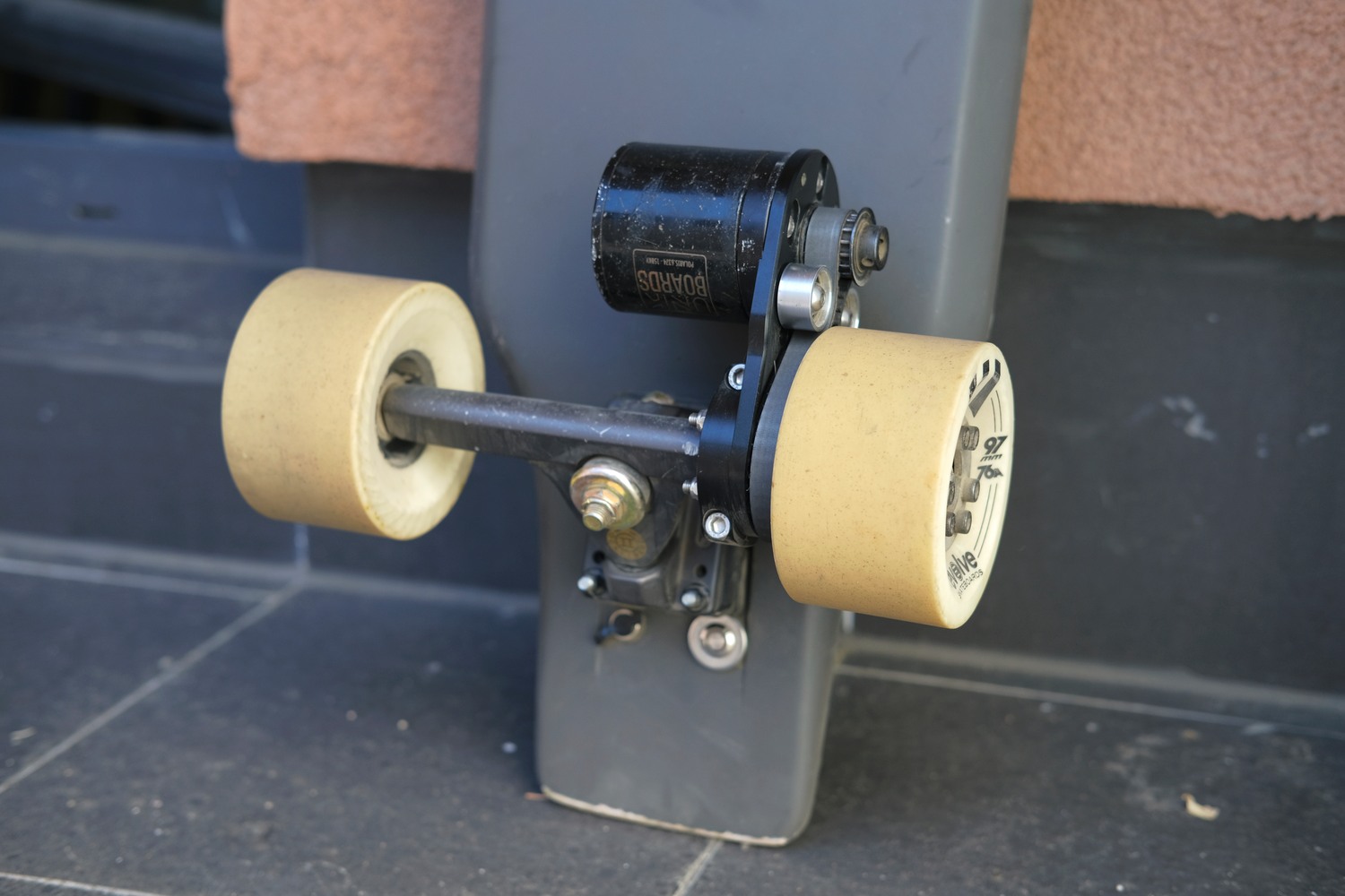

  • Replaced the motor mount. The Boardnamics one had idler issues:
    • I was using the new idlers on the old mount (for wheel clearance), and the washers holding it would bend in the cutout that was too wide, and misalign it.
    • The idler shells get loose from the bearing, and then start scraping the mount.
    We replaced it with a Whooshboards mount. These mount are awesome, because they have fixed holes for the angles (no threadlocker needed for those bolts), and the idlers just screw in from one side because the mount itself is threaded. The idler shells hold on to the bearing using a circlip, so they’ll never get loose! :smiley: (Small complaint to @Mikaelj – the washers in the idlers have their inner diameter slightly too large, so if you tighten the idlers down while the washer is hanging down, the circlip will bump into it. Easily fixable by holding the washer in place while you tighten down, but still.)
    Also the Whooshboards mount is shorter (better for clearance), so I had to shorten the motor wires even more – look how cute it is now :heart_eyes:
So that’s the board at its current state now. One of the wheels got a small chunk, but they’re definitely softer than Boas, so it’s a comfort VS durability sacrifice.
