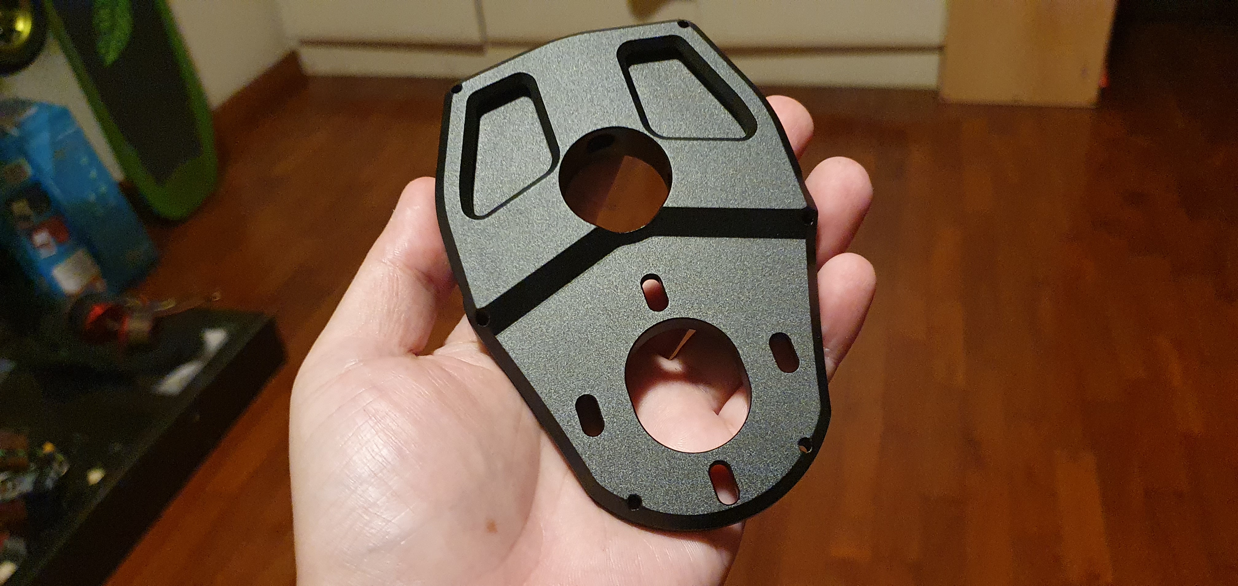

It’s an aluminum heatsink, so there’s no hole. It’s not necessary if you dont ride hard as the ESC won’t get very warm.
And what happens if you ride very hard, e.g. long distances uphill, and the Foc box gets hot and you do not have a heatsink? What problems can arise?
Chances are the ESC will start to thermal throttle, meaning it’ll start to lose it’s power, and you will notice this as 50% throttle on your remote may feel like 20%, something along those lines. I’ve never had it thermal throttle on the Unity before so you should be alright. The Unity has a heatsink of it’s own at the back already, but the extra material helps.
