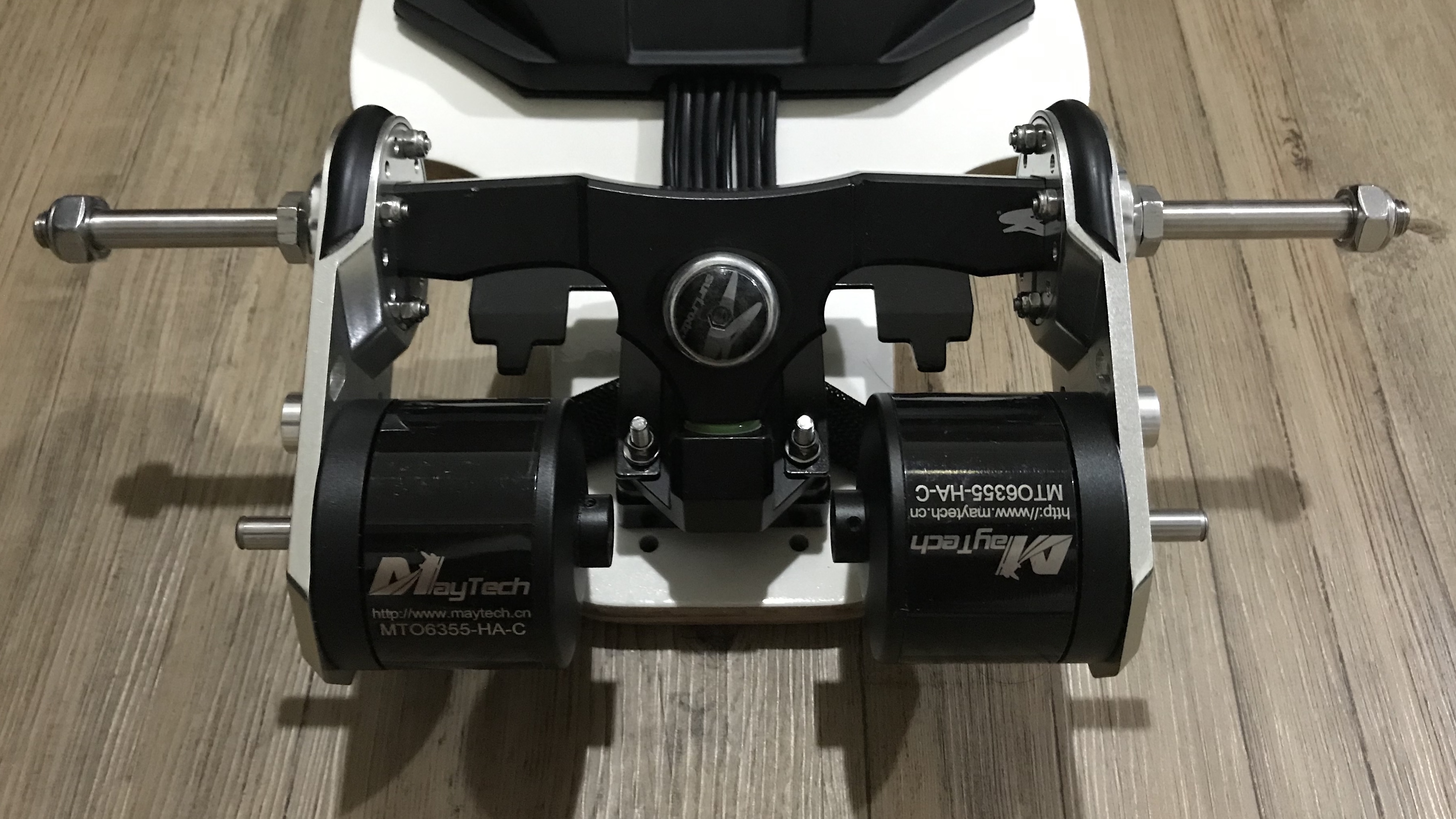

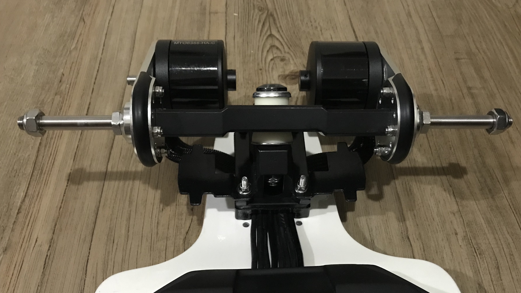

Sorry off topic, what im about to show you is what i did with my axle :grin:.
Your axle looks so cool man :+1::smile:
:blush: Just some idea
I like those

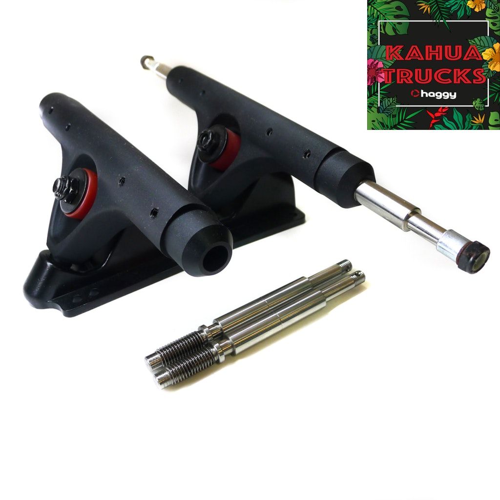

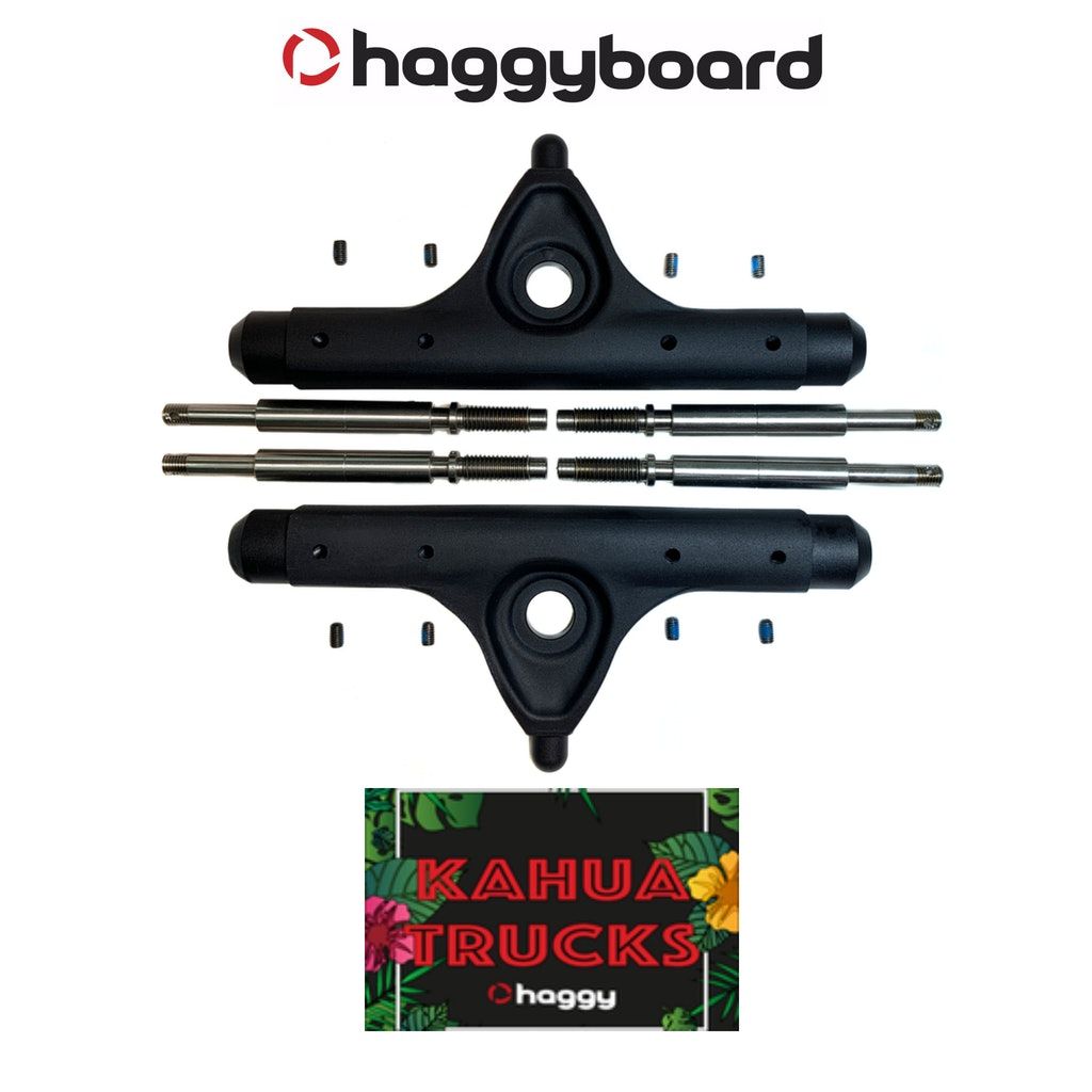

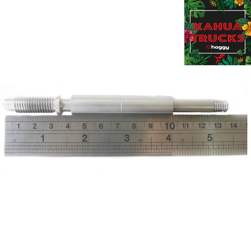

The Kahua truck is made for speed on any terrain! It is the combination of a forged and precision milled hanger with super-strong 12mm diameter / 8mm stepped axles and a 50-degree baseplate.
340mm total truck width with axles made of extremely strong carbon steel.
The Kahua trucks will be sent out fully pre-assembled. It is not recommended to remove the axles from the hanger as we have used strong Loctite on the grub screws keeping the axles in place.
I really want a set of these hangers.
I’ve got caliber adjustable baseplates to match them with.
Yeah, it will be perfect :ok_hand: they look like another level of trucks,
like real futuristic eskate truck this way! Like a spaceship :fire:
