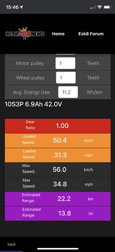

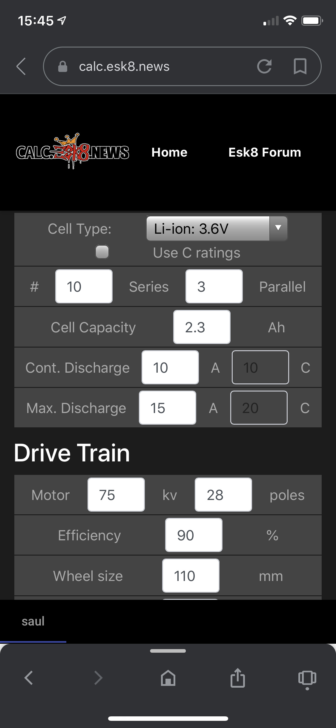

See my comment right above your post. You need to decide what’s right for you. Use https://calc.esk8.news and figure out your specs.

36V 7ah 252Wh is all the information i can find online, although I’m almost certain it is 10s3p?
Loaded speed 50kph / 31mph.

  1. Cell type - li-ion cuz yea that’s wat u usin
  2. series - number of s groups in ye pack (10)
  3. Parallel - uh numba of p groups in ye pack (3)
  4. Cell capacity - approx 2.3 / cell be better if we knew the cell type they use but we can math it. Total ah = 7. P groups = 3 so 7/3 =2.333 bleh bleh bleh
  5. Cont. discharge = continuous discharge of cell (I don’t know this value cuz we don’t know the cells so we just finna use 10)
  6. Max discharge = max discharge of cell. (Same see 5 don’t know de cell)
  7. Motor kV - 75/90
  8. Poles - 28 for the TBDD (pretty sure )
  9. Efficiency - 90% cuz is easy
  10. Wheel size - 110
  11. Motor pulley - number of teeth on motor pulley. For DD just make it the same number as wheel pulley. Since for DD the ration between the two is 1
  12. Read 11
  13. Avg energy use - how much juice I use per km
    Tadaaa then u see stuffs below and u go wooohooo I know how fast I go now…
Or like sumfin…
Thas my dumb explanation… dereeee be peeps hella super smart on here dat can give you better explanation cuz science or whatever
But dis should help ye at least know how fast ye gonna go
Kk …

tank ya brah. I dun learned a bit! Happy to know I don’t need to cop a new battery for a minute at least
