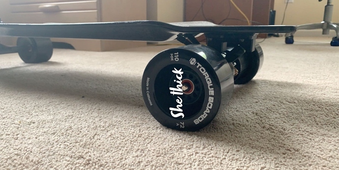

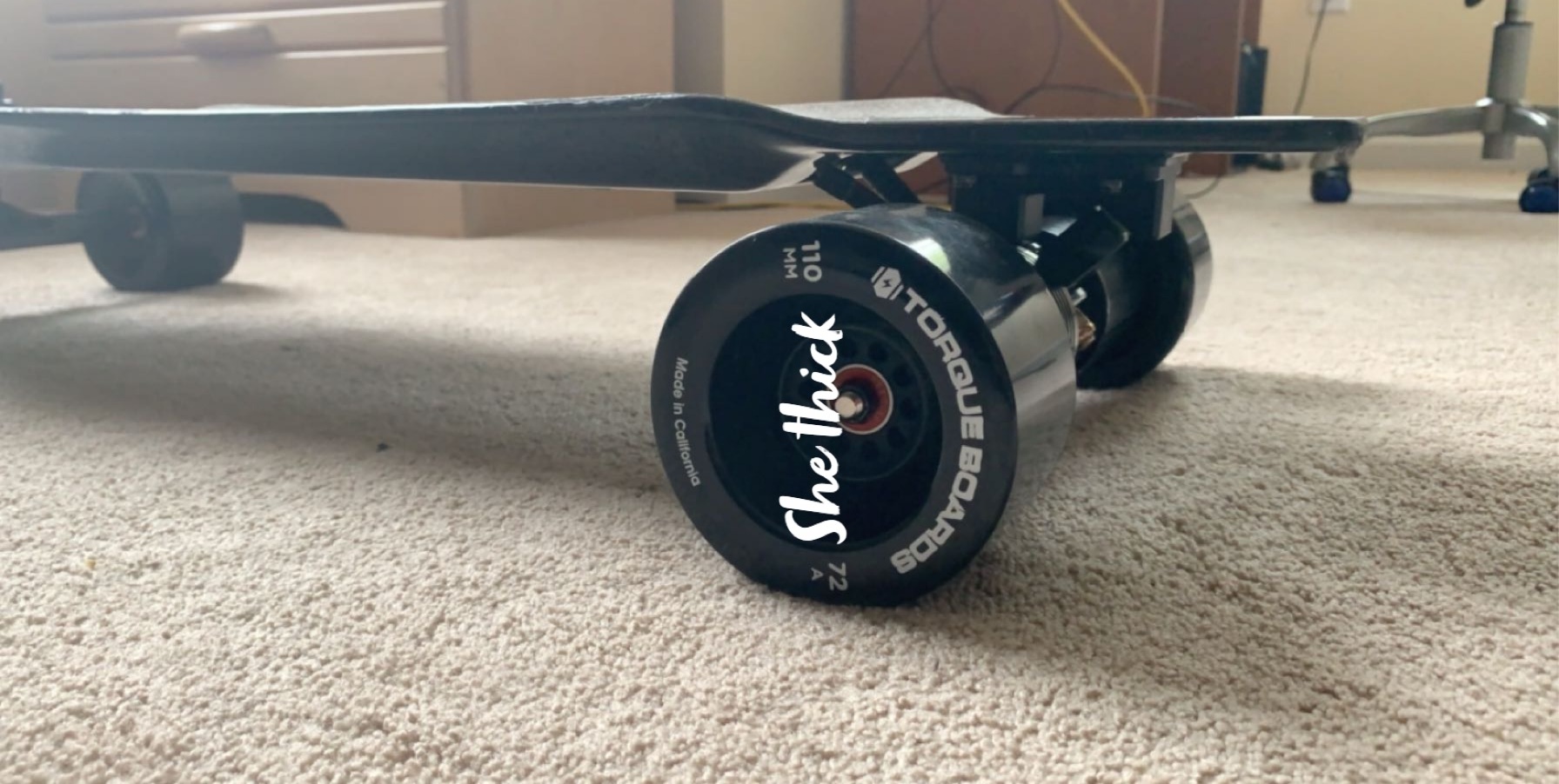

Should I opt for the TB110 72A or 78A wheels? I know it is based on personal preference but I have never ridden a board over 20 mph so I don’t know what effects to expect from each at 35mph
TB DD + TB110s are in!

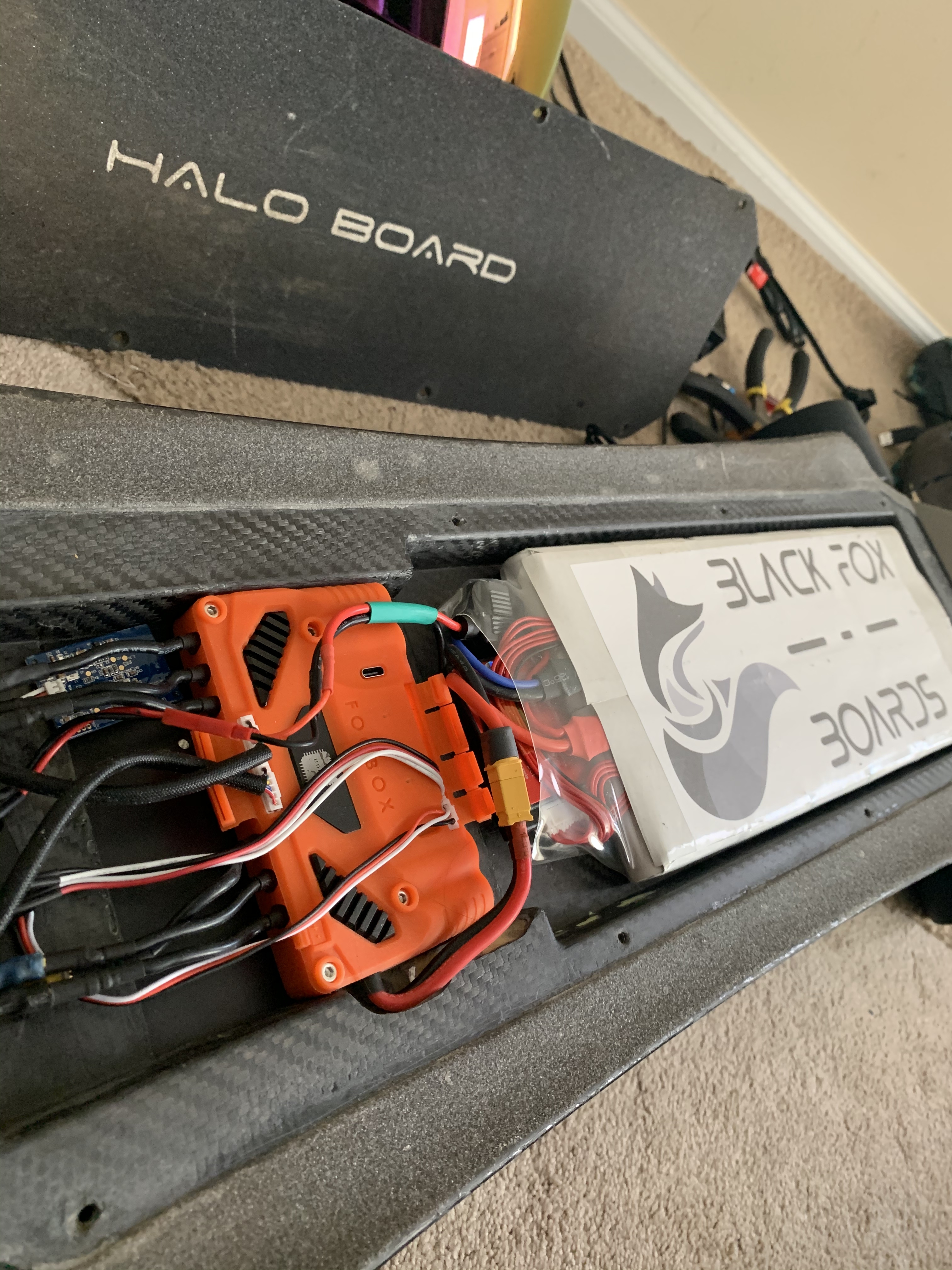

Hey man, would you mind taking a photo of the inside of your halo?
